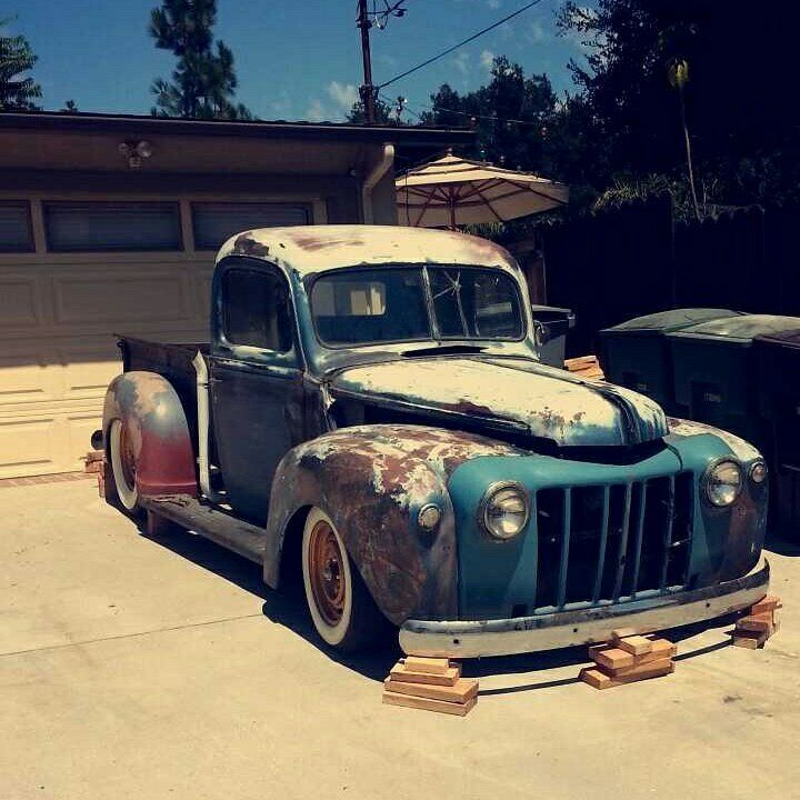

    also got a free s10 seat yesterday that fits pretty well. and made and mounted all the pedals up so it would move back and forth.

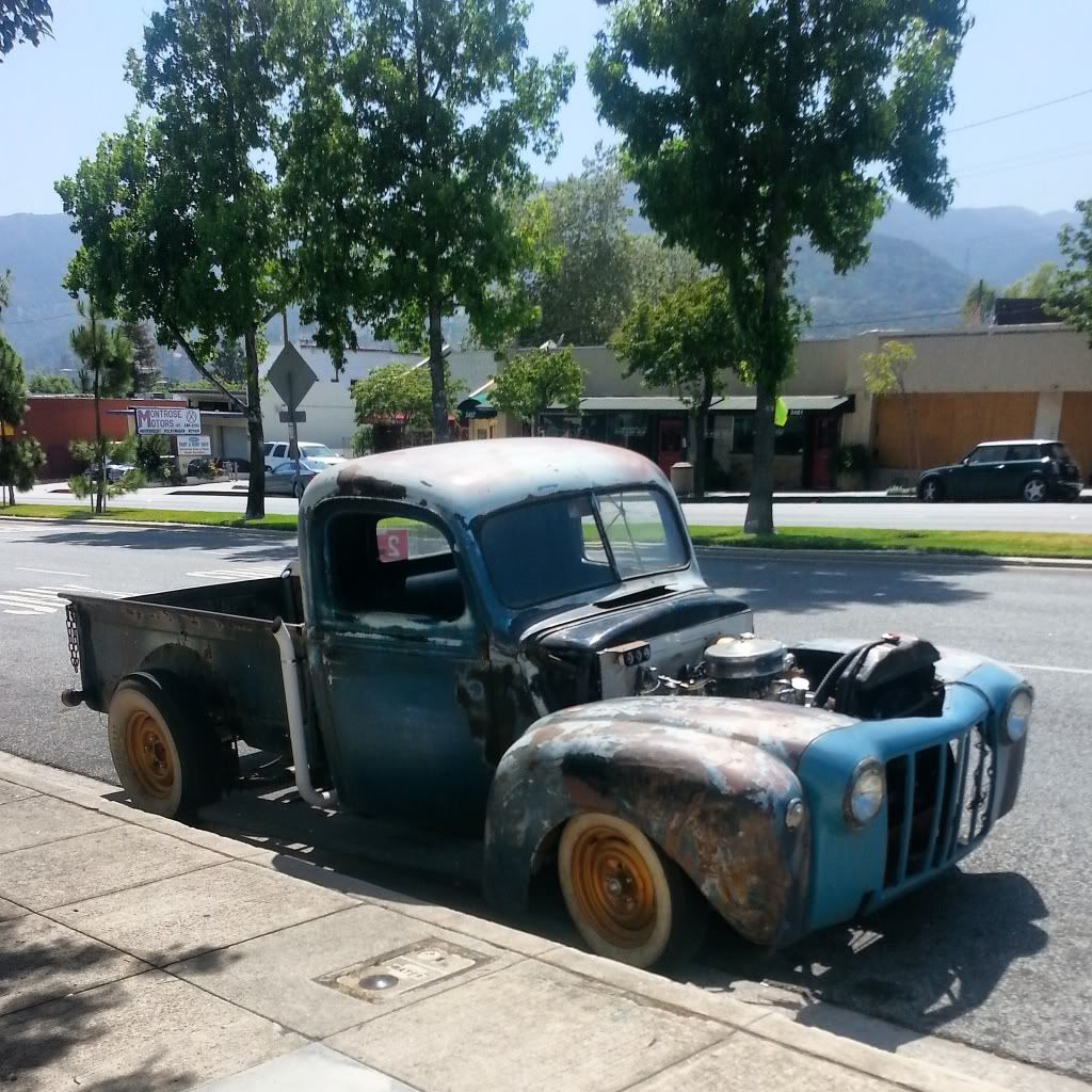

    well nothing major to update, just have been running it, but I got the rear fenders put on, and am hoping to make it to mooneyes this next weekend.
    I was test fitting bumpers:

    I thought I recognized that name. Your square body gave you away !!! Lol. Looks good !! What did you make the filler neck from? And How did you attach the filler neck to the fuel tank ? Looking to do something similar for a OT project

    thankyou, it was made using the cap from a overflow tank, bought a threaded piece of conduit, then made a pipe that runs down. then a piece of fuel specific rubber hose connects to the tank. I had to run a breather hose all the way up to the top to get it to take gas from the pump right.

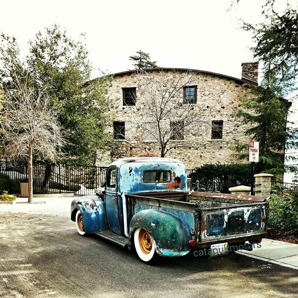

    heres some pics from my phone from the other day. the catapultmotors watermark is from instagram.

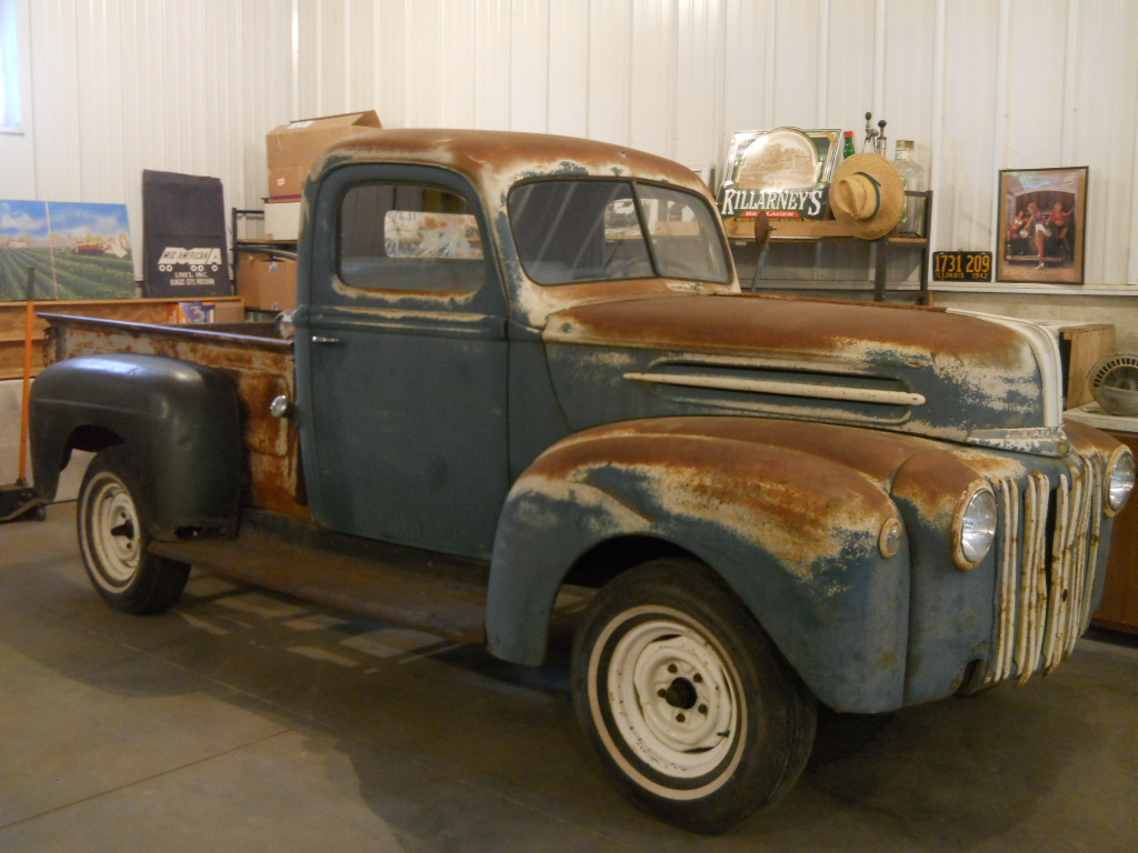

    47 ford p.u. jack hess 7-14 001.jpg 48f4-2012 080.jpg ...that truck looks pretty neat with the Chevy rear fenders; it has an old school look to it. Sorry bout your bike accident, don't look fun at all, hope you're mending well, what was that rod they pulled out of your arm?
    ...here's a 46 I bought last summer with 50 Ford truck rear fenders which look ok also.
    ...I'm runnin a Chevy bumper on my 48 Ford p.u., they fit real nice.

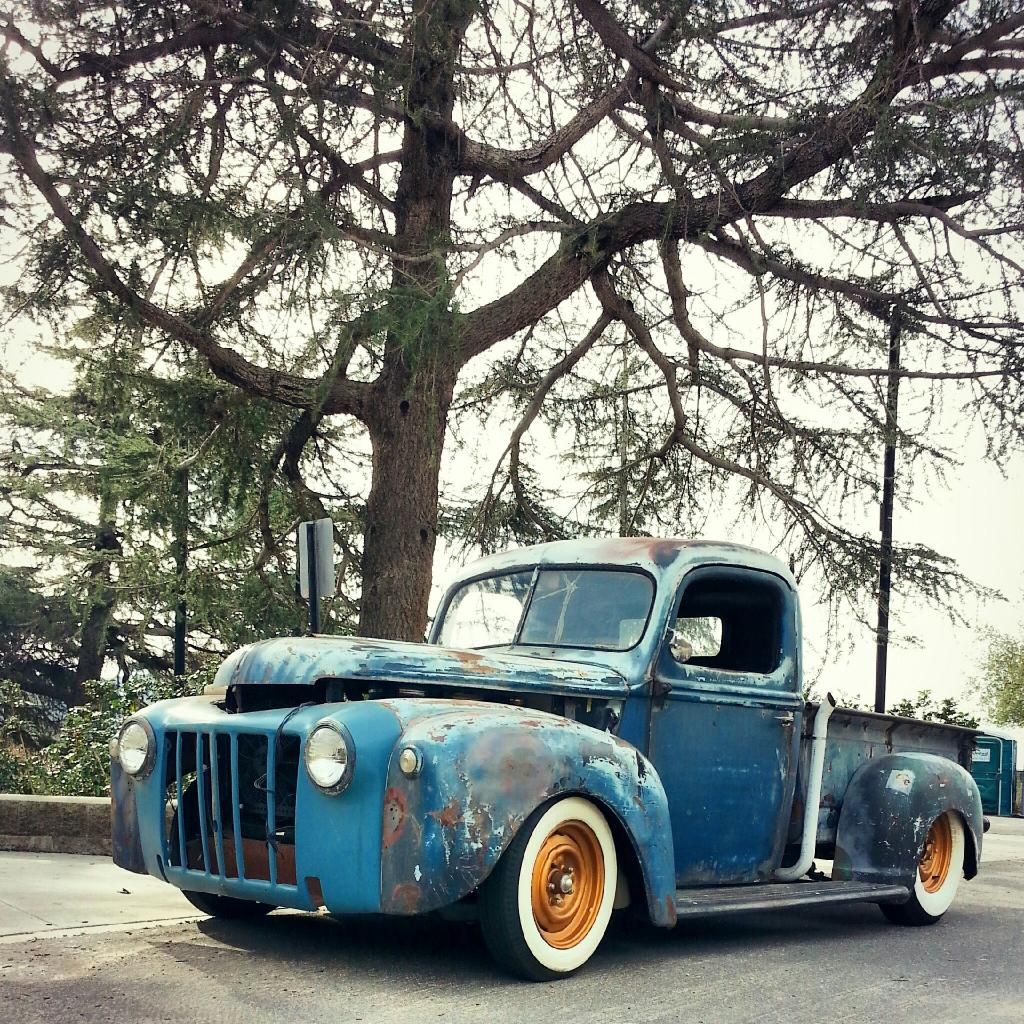

    this is part of why I went with the chevy fenders.
    I think they just look right with the fronts too. I have different plans for atleast the rear bumper now.

    finally got a filler panel made. needs a bit more work, I was just gonna weld it to the running board, but now I want to make it bolt in. also need to clearance around exaust a bit more.[​IMG]
