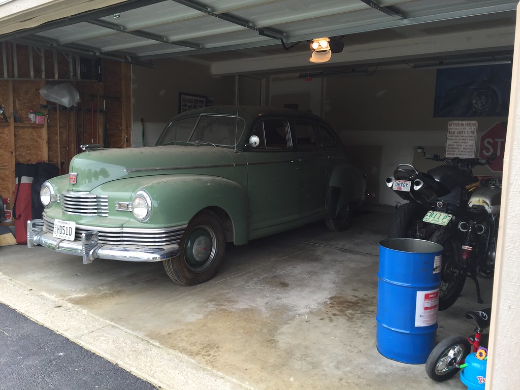

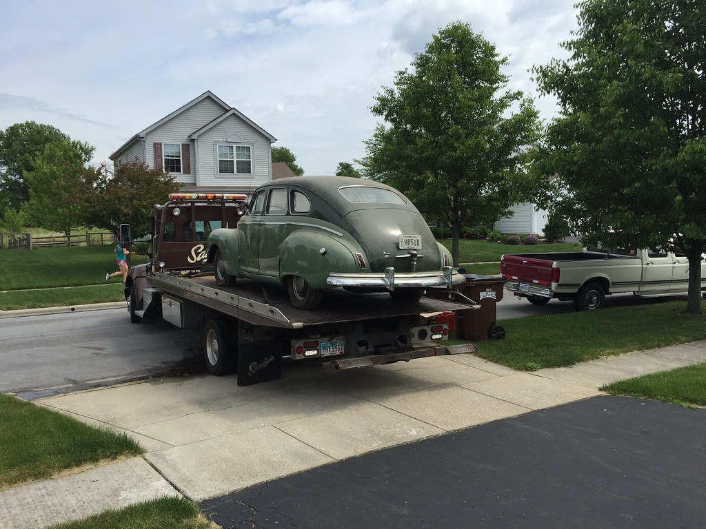

    Here's some pics of mine:

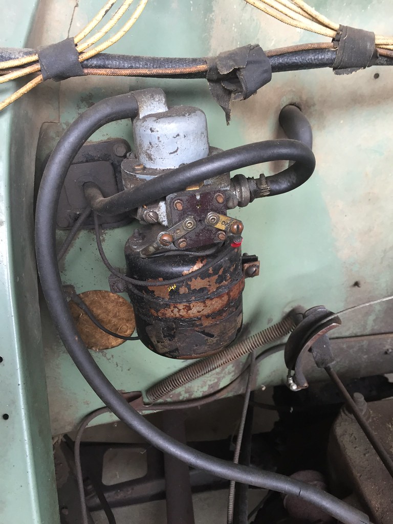

    What the hell is this thing on the p***enger side firewall:

    Suggest you try it the way it is and see how you like it.50/50 coolant mix should be fine. Don't know what you mean about the springs but if you want it lower in the back, you could try 2" lowering blocks.
    The thing on the firewall, I don't know. Where do the hoses go? If the lower one goes to the intake manifold and the other goes to the vacuum wiper motor I would say it is an electric vacuum booster pump for the wipers.

    Don't do too much to it, in my humble opinion.
    I don't know what the heck that thing is.

    The thing on the firewall is likely the vacuum motor for the wipers as suggested above. I also pulled the oil bath air cleaner for cleaning and re-oiling. It likely hasn't been oiled in years, and the oil level is way low.

    p.s. I can't find a replacement filter anywhere. Any ideas?
    edit: nevermind, pulled the lid and the filter that's in there is a Wix 51100. Available from Summit. Although it doesn't list 1947 Nash as a compatible model.
    Think it's ok?
