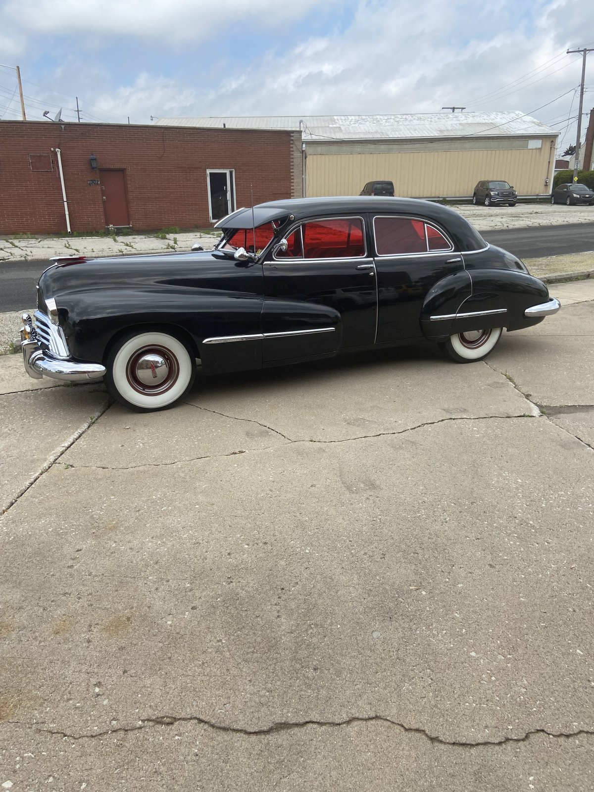

    Need help bagging car

    Since we are in off topic, I didn't see that, the pre 52 Buick and Cadillacs have tricky with the front shock A-arm,
    I would venture to say that a MII conversion upFront is the easy way.
    I have seen it done. but on most of these cars for the rear you can do a 2 link or 4 link set up. The front is just tricky.
    I would just find an airbag and adapters for the spring and do the outboard shock.
    old thread idea is similar
