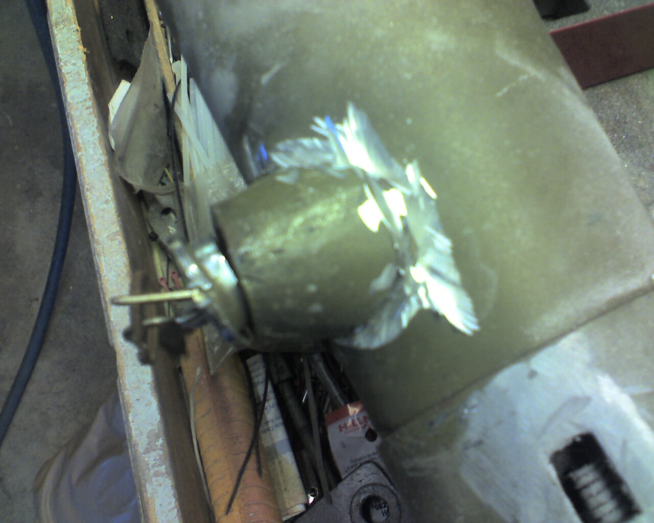

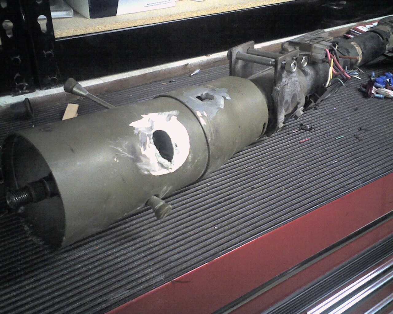

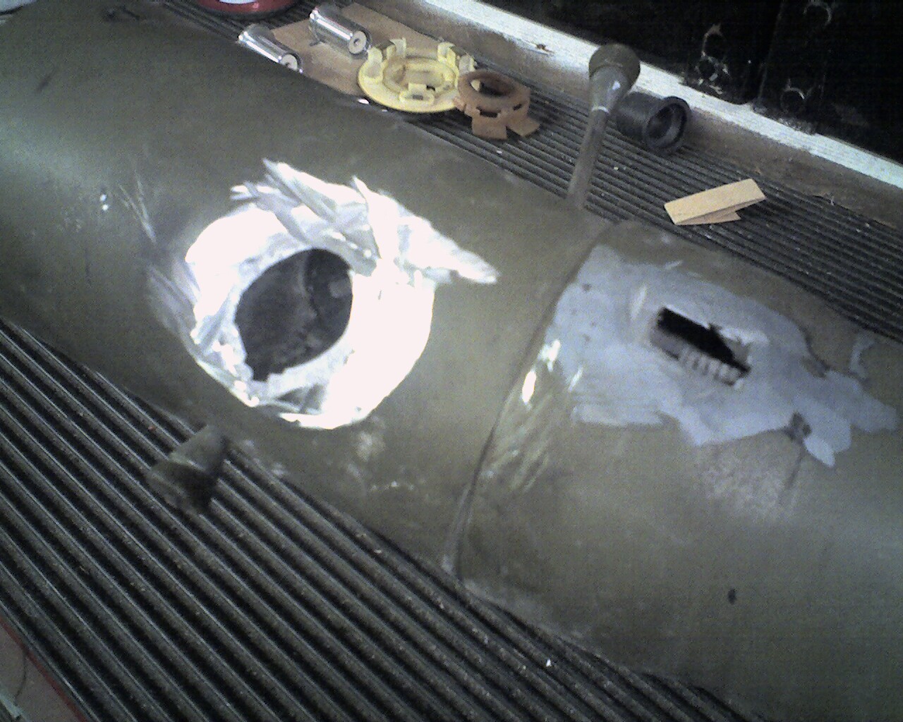

    I started on the steering column tonight. I know it looks like **** now but I am confident I can clean it up to make it look presentable. Remember, 10 years ago I was going for the modern street rod look like my father builds. It even was going to have a SBC (chevy) in it. So I still have theis Caddy tilt teloscopic column, I know it is not traditional but I thought if I get rid of that UGLY key cylinder it might look better. Always preferred to have the ignition on the dash. Here are some pictures of my butchery on the colum.
    By the way, any ideas on how to fill the holes? I cannot weld aluminum so I was thinking epoxy????? Am I committing a sin?? I am only really worried about the ignition hole as the other one is under the dash.
  5. fiddy
    Joined: Sep 24, 2009
    Posts: 163
    fiddy
    Something like that may be your best bet. I have tried to tig one...ford i think removing the key switch and it is a pretty dirty metal.
  6. Work In Progress
    Joined: Dec 14, 2010
    Posts: 201
    Work In Progress
    My thoughts exactly. If it does develop a crack, who's going to see it? I was just seeing if there are any other ideas. Thanks!!!!!!!
  7. I've used epoxy. Bondo will work great but I find it cracks after a while due to vibration. How about a polyester reinforced bondo? Like Kitty hair or Dura gl***?
  8. Work In Progress
    Posts: 201
    Work In Progress
    Thought about kitty hair but I heard it dries hard and does not flex.... A little cracking probably would not bother me though, hard to see on the side of a colum.
  9. I'd go with good ol bondo then. Easy to work with. Worst thing that could happen is a hairline crack.

    NO TO BONDO...... J.B. weld works best ...used it to fill a hole the size of a quarter on the case of my B.S.A. ran it for 5 years ..

    Yeah, I agree..... Will just finish it with a little filler.

  20. You can get a cover for the steering or make a steel cover to slid over it once the key swicth is removed

    I never thought of that..... Do you know where? It is a Tilt / Telescopic.
    Thanks a bunch!!!!!
