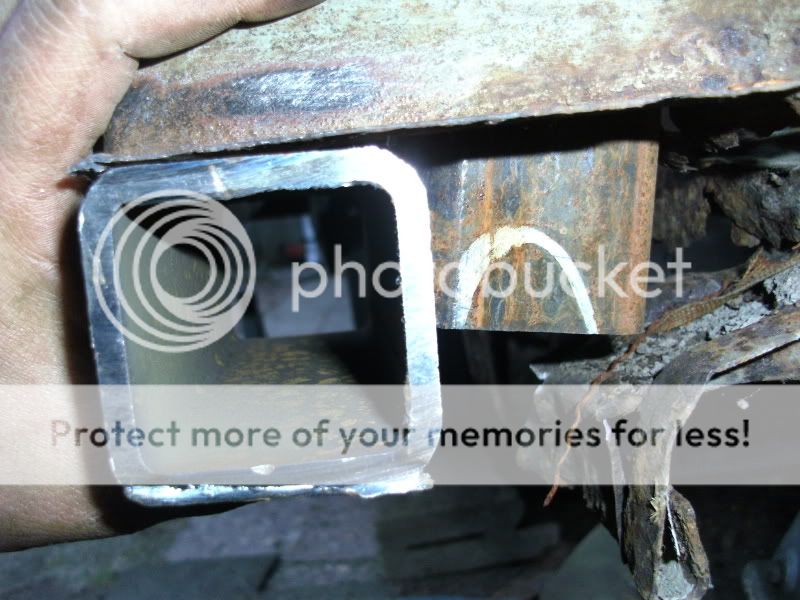

    first was mock up of rocker support going in i welded a 2"x2" inside the {B} pillars and {A} pillars as there is nothing to attach to as the rockers are long gone [​IMG]
    sample 2x2 for mock up of {b} pillar [​IMG]
    i welded a 1"x1" inside the {C} pillar to connect to the rocker as you can see there isn't allot left of the rocker area
    i cut inside the inner fender well to get to inner structure metal
    now the {A} pillar i did the same with a 2"x2" welded inside to the solid hing support and inner body [​IMG]

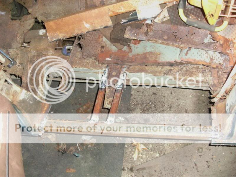

    rocker beam is welded in place [​IMG]
    and i started to fix the floor supports that are missing [​IMG]
    now i made a rocker skin which will cover my support beam this is a mock up so i can make a finished product to weld in place
