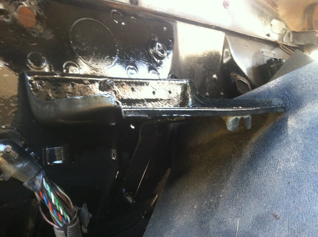

    Ok reused existing battery tray and mounted to firewall and going to fab a support bracket from the old gas tank mount. Key word here is recycle recycle recycle.

    Ok bracket welded to tray, primer drying. Have to pick up some black paint and project battery tray is complete.

    Ok spent 2 min and installed my custom made battery tray. Recycled :)

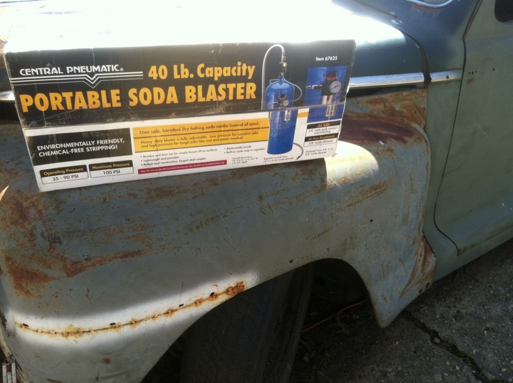

    New tool for my garage hopefully it will do its job
  23. Tnomoldw
    Joined: Dec 5, 2012
    Posts: 1,563
    Tnomoldw
    :)Put 2 teas****s of that soda in a gl*** of water , it will make you feel better :D:eek:

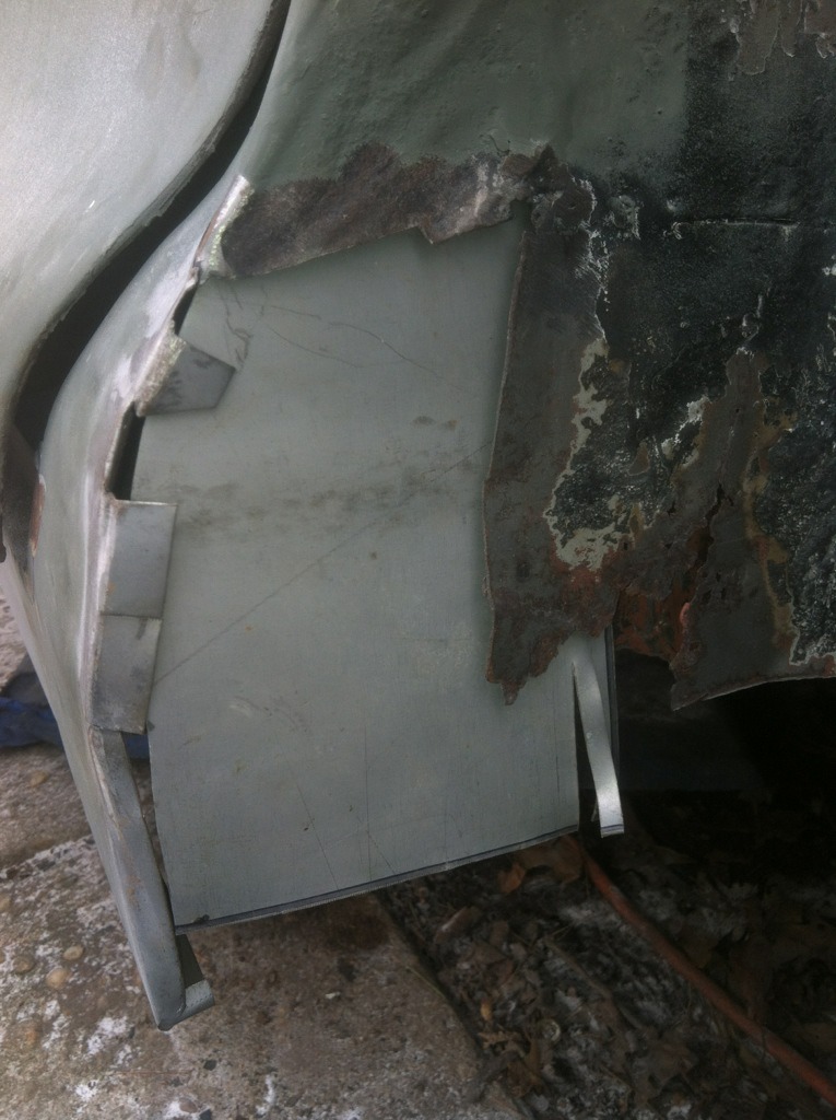

    Every patch helps :)

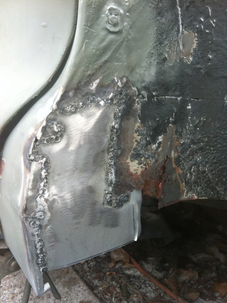

    Welded and sealed
    Next area to be patched tonight
