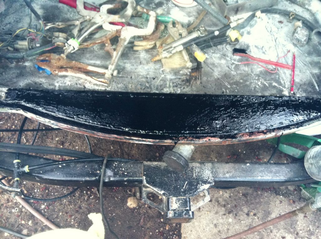

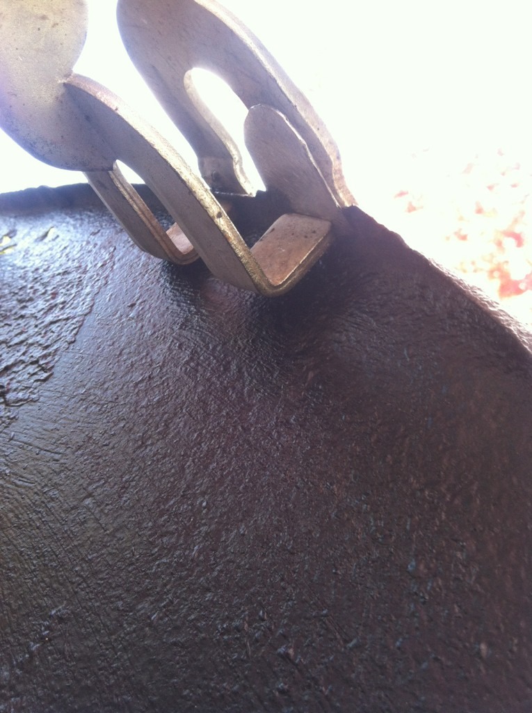

    Down to my last one have to find more
    Jacob and i welded the patch in
    Then i smeared some undercoating on it

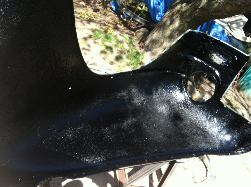

    Ok before i go out for breakfast with the family im popping the old stud n nut that hold the fenders on and replacing the ones on my car that the studs are rusted in place

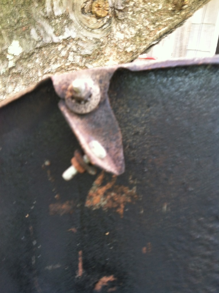

    Broken tab on fender. Noooooo problem

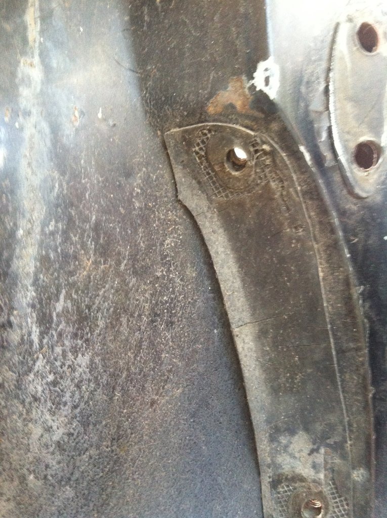

    Lower front fender
    Replacing the the fender studs
    On drivers side i was able to thread them from behind
    P*** side i cant tread them in so easy so i bolted them on nice and tight. Im going to cut the heads off then back out the nut instant fender stud

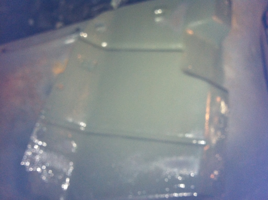

    Around 8pm i got an itch so i dug out these parts from my parts bin and went to town. They go on each side of the radiator to help guide the air to the radiator like a fan shroud but infront. So i blasted them and hit wuth self etching primer. I will coat them in undercoating when i get home
