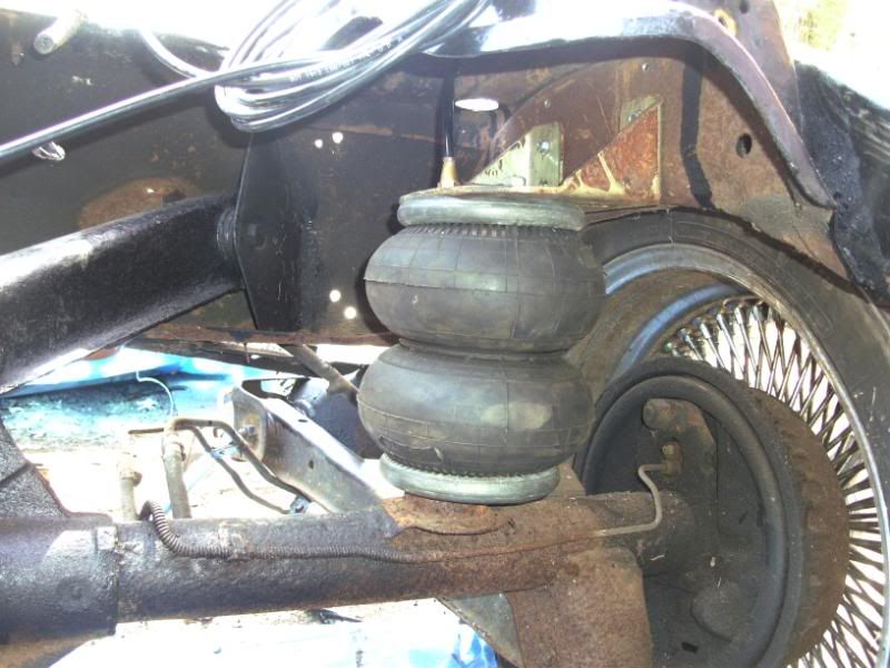

    i lowered the bracket for max clearance and plumb some temp lines to see how it moves
    i have to make lower plates and when im happy il weld them permanently

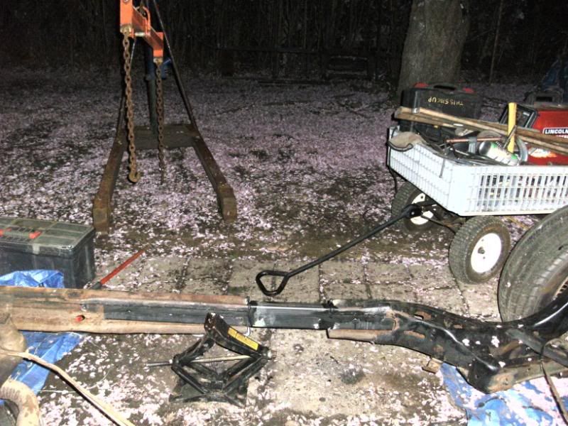

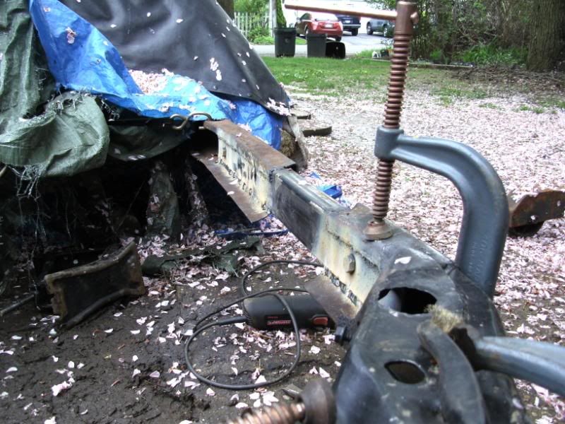

    ok the update for today i got allot done
    i purchased two tubes 1-1/2" x 3" x 3'
    i made the ch***is level, clamped the beam in place, drilled holes for bolts (so when i remove and reinstall for final fit it will sit in the same place )
    marked where the contact areas are for welding, grinded all contact area and rebolt tube and weld the **** out of it in that order :D
    are you ready for more pics?

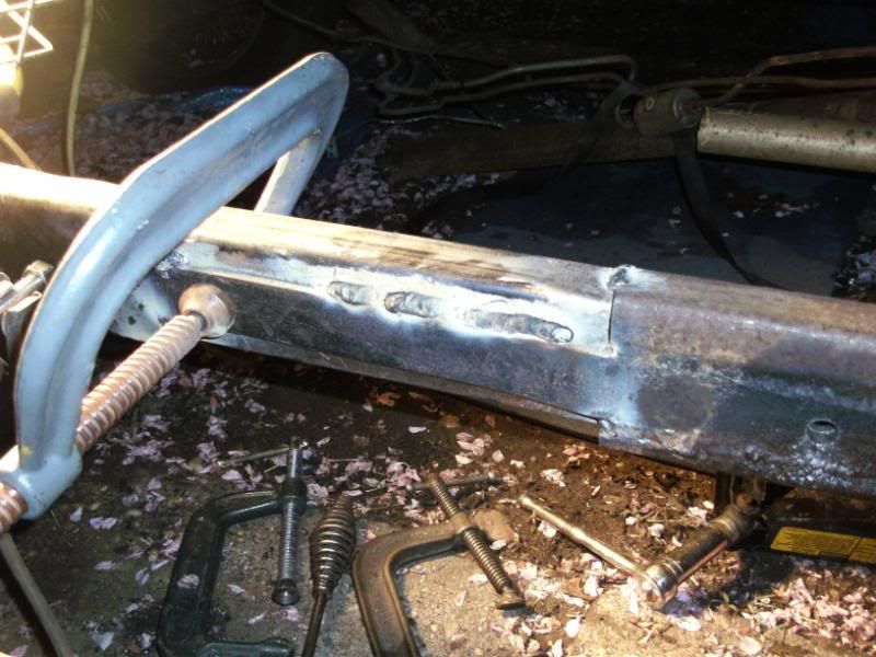

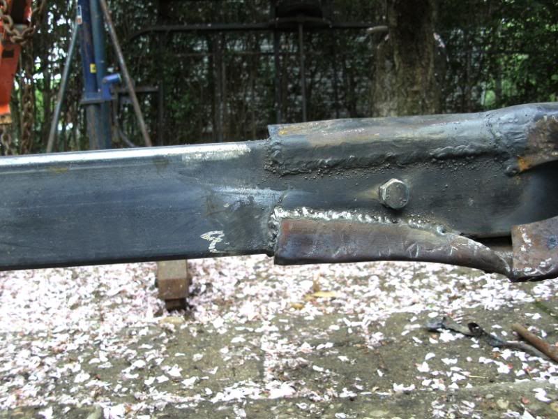

    thanks for the help jesse and ray
    ok i welded the first seam them folded the metal over and welded the last seam
    i think its stronger then the factory ch***is in this area i will use high grade bolts for the holes

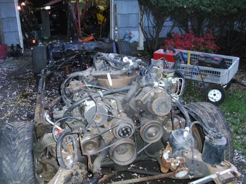

    ok i feel the ch***is is done i will start to degrease and paint and install front airbags. i removed old inner fender wells and radiator support as i should be using the old stuff for this. i also have to clean up the engine and throw some new gaskets on the block. did you know i will have a/c,cruise control & power steering
    here what it looks to start with the next pics it should all be done so it will be a while

    welded the air bag brackets in permanent they work great and do not rub anywhere

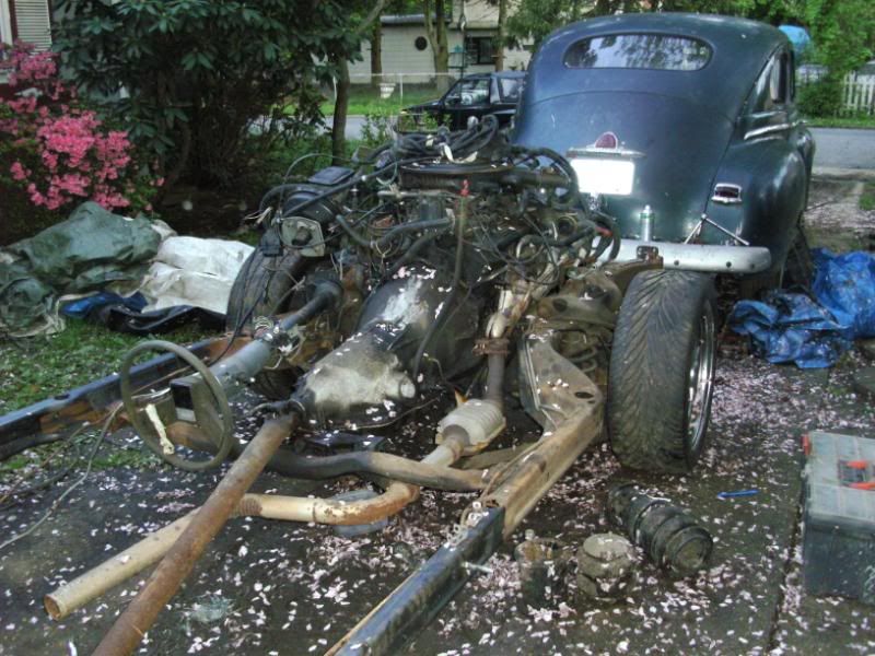

    ok yesterday i removed the nose of the car in one section so after i place the body on the new ch***is (before bolting in place ) i can place the nose for reference here its is wrapped around a tree as a joke

    ok cleaned the underside i did not undercoat yet still have welding to do
    i placed the body on the ch***is and everything went perfect as planed except for the supports i welded in the a-pillar i forgot about ch***is clearance :eek: so thats going to get redone i also will have to gut the whole trunk sheet metal as it was worst then i thought after cleaning the underside the orig undercoat was holding it together but the rockers i welded in held the car perfect i could open the doors while it was in the air no problem i have to find so projects on here where the fabricator welded all new floors to get some ideas on how im going to hit the trunk area
    are you ready for more pics i have been at it since 8 a.m. :confused:

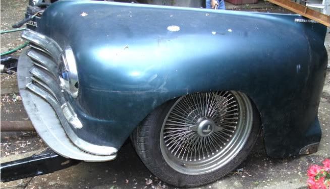

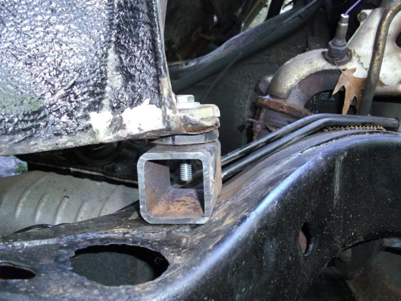

    i have a minor problem with the floor supports i replaced with square tube cause they raise the body of the frame an extra inch so i either make up the difference or remove them and redo it so the body sits lower im not in a rush as this is very important step right now like i said before im not a professional and its only me working on it if i had more people i would have more ideas on hand so i am looking at all my options and will use the best
    ok so i have the body centered front to back
    spare fender for mock up
    mock up of front body mounts i kinda wish they where lower

    i was thinking of cutting out the floor supports from the old floor and extending the ones on the car and eliminate the square tubes but i wont get that much differance in hieght unless i body drop it which i don't want to do i hate when the floor are uneven so im leaving it at the height she's at and will start to fab bdy mounts tomorrow i need a break

    Why dont you notch that section and cut the tube smaller to lay lower, if not try to find a smaller body mount.
