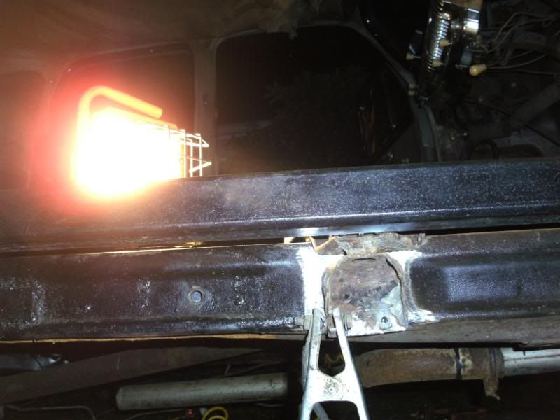

    ok i removed two brackets off the old chassis grinded and clean them up some
    i removed a section of u channel type brace off the donor car floor and cut two small section's out
    i welded the two small sections to the underside of the parallel square tubes
    and placed the brackets on the frame and tac welded them in place this will raise my boy off the frame the way i want it
    so far i have 4 body mounts done the next set i have the holes drilled in the frame with a bolt and bushing mounted but will rework it so the rubber has full contact ready for some pics cause im sleepy
