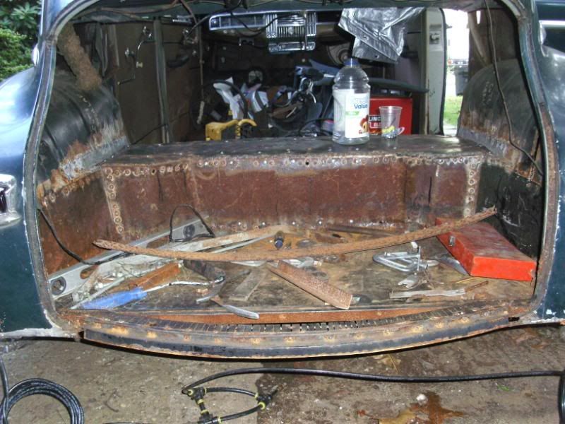

    ok i sliced off the old floor supports off the donor floor and reused them as the gastank supports i then welded the floors down they look ****py to me but i have to keep telling myself they are going to get sprayed with sound deadening spray and then carpeted

    i reused the upper gasket channel for the trunk off the donor car and made the lower channel im missing

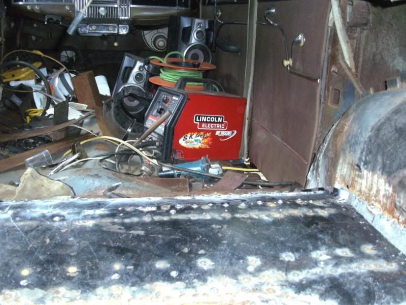

    every chance i get i have been spot welding the trunk floors in its allot of work i figured out that since i used think angle iron its hard to spot weld the sheet metal as the two melt at different temperatures so you have to hit it wit a hotter setting to get a good weld at the angle iron but kinda melt the metal so its trickey i am tring to get someone i know who welds at the shop to stop by and give me better ideas but so far il keep plugging away

    thanks guys i am working some days during the week so far and i have been working on the car im working on getting the photos out of my camera that doesn't want to share right now so far i have finished welding the rear trunk area it came out pretty dam good except for one part i could sandwich the metal together the way i wanted but it will get covered with carpet the only thing i can't figure out is do i a: paint with the rust-x paint first then put the seam sealer glue stuff or reverse seam sealer then paint ?

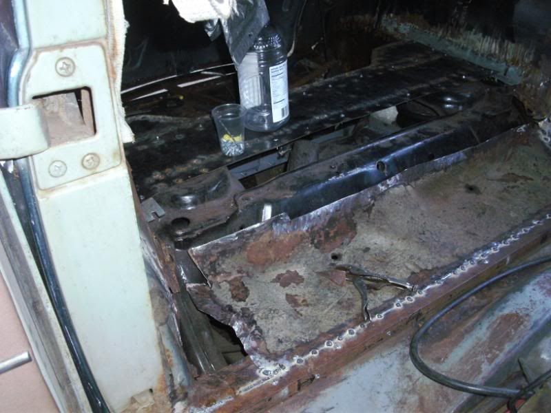

    i welded an angle iron across the floor riding the edge of the old floor structure zip screws held it in place so i could weld it in this helped stiffen the floor as it was rusted at the ends [​IMG]
    next i reused the floor section i had cut out of the donor car this is the floor pan under the rear seat i just cleaned it up and smoothed out the edges
    next i started welding in the patch panels making it one structure again
    this part is fun when you shape the metal and it starts to stiffen up

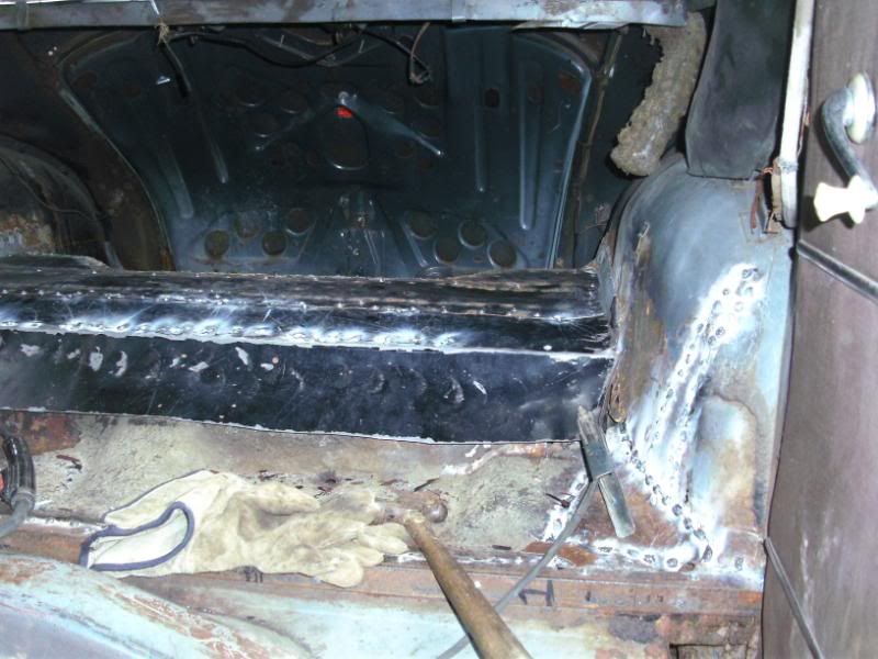

    the other side had more rot so i had to hit it hard
    the trunk area all patched up before i painted it
    this area gave me the most trouble but im over that hill now
    i welded another angle under there and hit the edge of the metal with a big hammer since i don't have a metal brake to bend its caveman style

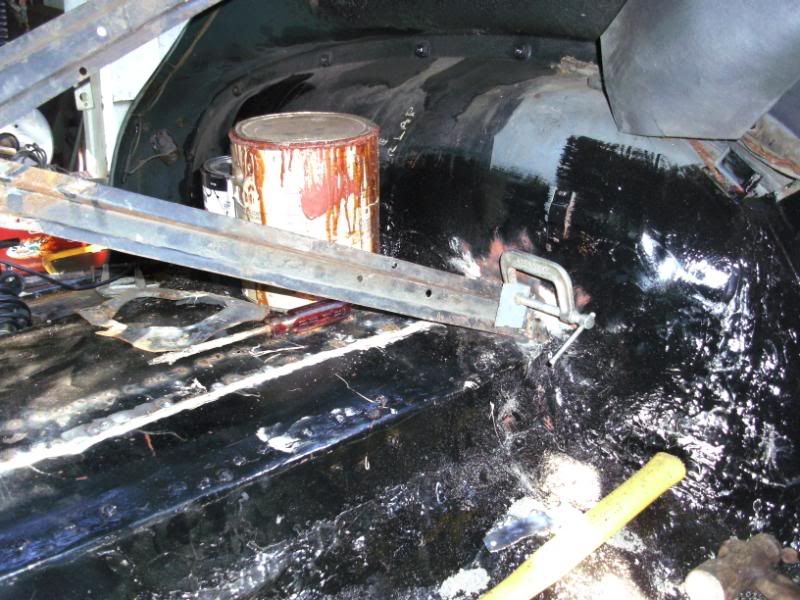

    a little rust-x paint & epoxy glue (seam sealer) once its dry will recoat with rustoleum black

    i have to finish two corners on each side under the fender area but i think i will wait till i lift the body off the ch***is again im having a hard time figuring how im going to weld the underside i donot have a rotisserie but plan on making it (still scratching head on this idea) but il getter done
    I have to save up some money and get this tow hitch at walmart im going to weld in place it will give me a place to weld the rear corner body mounts, stiffin the rear ch***is with extra support across, protect my gas tank and allow me to tow stuff like my quad
    the pics are after seam sealing and a recoat of black rustoleum ( overkill)
