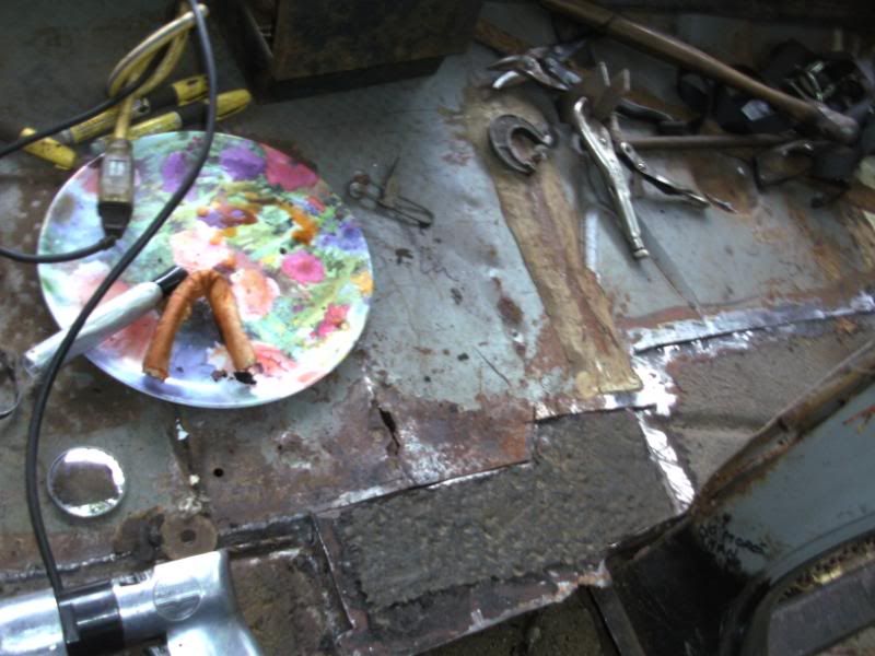

    ok i started making patch panels from the donor cars floor which takes longer then using new metal but its fun to learn and mess with
    noticed i used the area that was bead rolled from factory :D
    i first cut them to where they all fit together but i don't like welding when the metal just meet up its harder to just do tac welds and burn the egdes of the metal away i prefer overlaping the metal and hit it at both seams top and bottom i hate how messy it looks but i wont see it with carpet:rolleyes:

    ok some of the spots i welded burned metal further away so i remembered my friend potter welding two steel plates with an aluminum on the back so the weld wouldn't fall threw the weld does not stick to the aluminum and therefor closes the gap between the steel
    what i used to block the gap from behind
    its hard to see but there are a bunch of holes where i blew the metal away
    now its all filled in nicely thanks the the weld not sticking to the aluminum
    here is the underside that looks so ugly for now can't wait to paint and seal it

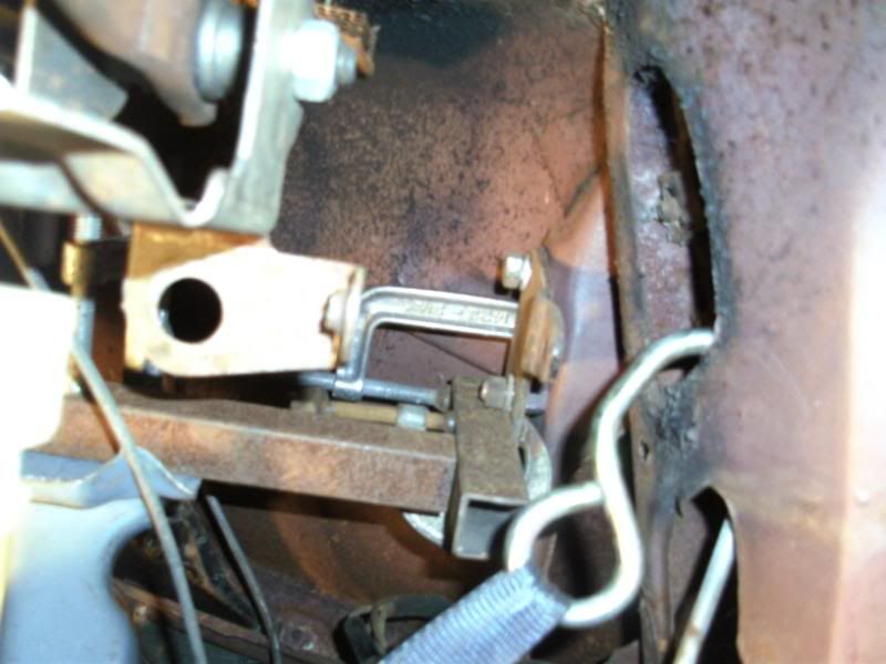

    i bolted the body down to the frame to see where the steering column & brake pedal ***embly will sit
    as for the steering if i want the neck to stick out p*** the dash like normal i will have to extend the shaft & and shifting arm does anyone have photos they can send me on how they did this or did you use a truck steering colum
    for the shaft i was thinking of cutting the end off that has a tapered ( flat spots) end it fits like a key to the shaft connected to the steering box now i was thinking of welding a pipe that can slide over the shaft and weld the end peice back on giving me the extra length and also extending the shift rod so far thats the only idea i have in my head so let me know what you think
    i also have this idea of taking my original 47 steering wheel and make it fit the spline of the 86 gm column (can this be done) new column with orig wheel look?

    ok i got inspired today after looking at a fellow hamber's pictures on how he mounted the master cylinder under the dash its looks crazy hard to do so i figured my setup is a cupcake compared to what he did and went outside in the rain and cold weather and after an hour or so freezing my nuts off i mocked it up
    i used a ratchet strap going across to help hold it up then figured where the brake and gas pedal should be at and this is what i came up with now i have to figure how to secure everything correctly and strong
    i never finished this section of floor cause i knew i would have to cut it up for this next project. i will weld a bar going across under the dash to weld the steering column mount i cut out of the Monte so i can bolt the steering right to it
