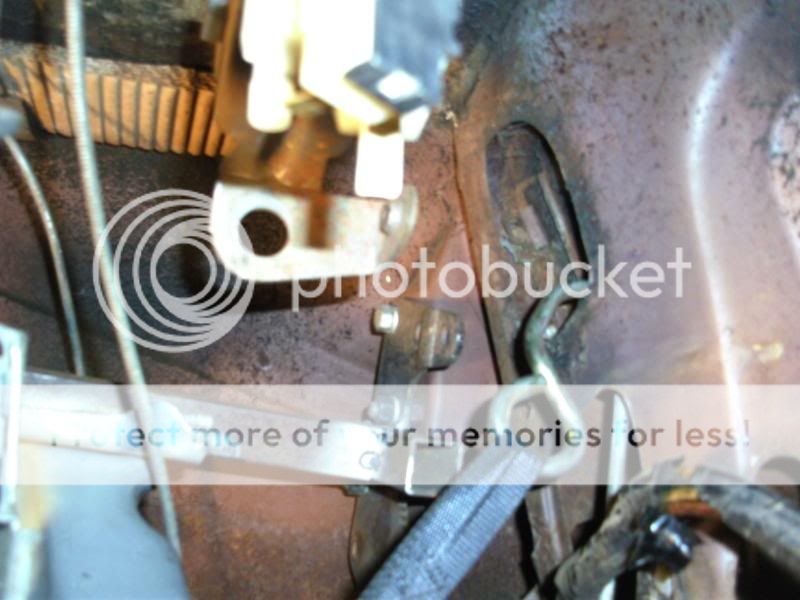

    ok i bolted brackets in and tac welded them together then took it out as one piece
    sorry for ****py pic i sprayed it white to show how it looks
    this is not the finished product when i remove the dash for rewiring (coming up soon) i will add more to this bracket by welding a arm forward to the firewall
    measuring the pedals in my Chevy caprice to get an idea where the pedals should be
    the old firewall i cut out from the Monty this is where the master cylinder was mounted
    master cylinder is mounted baby and still holding pressure :cool:

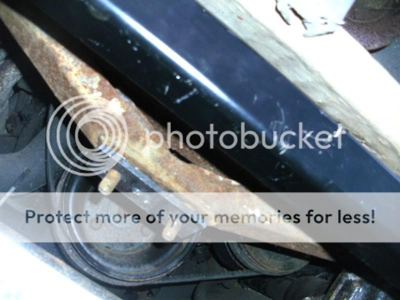

    ok i finished the radiator bracket and added a little support under the plate the rad sits on top of
    shes welded into the frame i will cap off the frame later
    now its time to see if the inner fender wells fit the p*** side fits perfect but the drivers side is to close to the a/c unit now heres my big question and need your help guys
    this is an 86 ch***is i believe this a/c unit cannot be refilled as they don't do r34 if that is the right number i can't remember. now im not going to use a/c right now but planed on adding it in later on, not that big of a deal if i can't use this unit cause its the old stuff will a newer unit with the good stuff bolt up to my motor or i will need new brackets ? cause i can remove everything and just bolt up the inner fender well im sooooo tired from work but i had to ask it been bugging me all day
    ready for a pic?
    p*** inner fender
    drivers side just needs a little hammer work to bowl some areas for extra room but really nothing is touching it that cant be nudged out of the way
    this is a junk inner fender im using to test fit i have to remove the battery tray from the good one and put it on the p*** side i will be mounting the cruise control stuff on this side
    a/c unit too close for comfort
  14. plym49
    Joined: Aug 9, 2008
    Posts: 2,802
    plym49
    from Earth
    I think you mean R12. There are R12 equivalents that are available today. ALso, there are ways to convert to more modern refrigerants. So don't worry about it - you can have A/C later. You will not need new mounts.
  15. joel torres
    Joined: Mar 22, 2009
    Posts: 823
    joel torres
    thats great i will rip out the a/c unit tomorrow, install the wiring harness, and relocate the batterie tray
    i was thinking about vintage air when i was first making all the plans cause i figured they make a/c for cars that never had it so i have guess there units that go on the firewall are small but have never seen or measured any. im going to check there web site now to get an idea. my goal will be to keep the factory 47 heater core/blower and also install the a/c condensor on the firewall and plumb some a/c into the car later on
