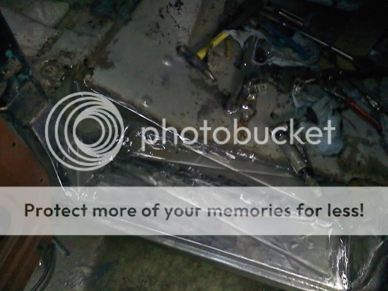

    a friend i gave some free stuff to happens to work at a muffler shop so he bent me up some pipes and guess what i did today :)
    my gas tank:cool:
    i wanted to use the factory fill spot so i relocated the filler neck on the tank to the side
    i cut the old connection to the orig 47 tank to use as the new connection
    and attached a pipe at a better angle
  30. plym49
    Joined: Aug 9, 2008
    Posts: 2,802
    plym49
    from Earth
    Nice work.
