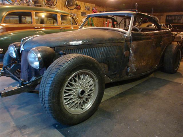

    I started a post with this question but it never got answered. How wide is the 500 with the 425 Transaxle on it?? Will I beable to wedge it into my '29 Pontiac Frame and keep width down to a minimum? By the way I'm using the 425 Transaxle so my '29 Big Six that I converted to a completly new body style...."Cab Foward Roadster Pickup" is going to rear engined with possibly a modified model A pickup box. My other problem is setting up the rear suspension. Does anyone have any tips?
  17. HotRodChassis
    Joined: Jan 23, 2005
    Posts: 2,282
    HotRodChassis
    Alliance Vendor
    That sounds like a cool project. But you may get more response with some photographs for the rest of us to go off of.
  18. Silent_Orchestra
    Joined: Jun 17, 2007
    Posts: 1,313
    Silent_Orchestra
    from Omaha, NE
    I'm not sure on frame width because I do not have the frame at the moment (It's still at the farm). But all I have really done is take and scoot the grill shell closer to the cowl, there is about 2ft in between each, the radiator battery and brake booster will go there. Then I took and sectioned off the rear of the body moved it up to the doors, did quite a bit of work to get it to look right. Put in a floor and now I'm waiting for the frame. I still have to track down an engine and trans. A trashed out '70 Eldo shouldn't be to hard to find or that hard on the wallet. I just wanted to see if any one knew the width on the engine with the transaxle attached.

    27 inches. But, There is a 4.5 inch kick out down low where the chain turns on the torque converter.
  21. Silent_Orchestra
    Posts: 1,313
    Silent_Orchestra
    from Omaha, NE
    Thanks!!! It should fit pretty good then. *hopefully*
