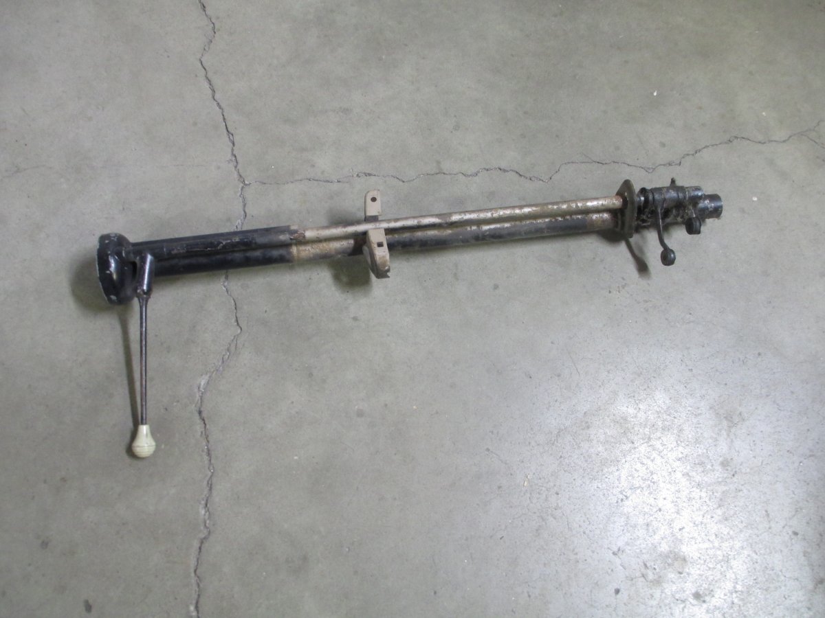

  7. Marty Strode
    Joined: Apr 28, 2011
    Posts: 9,588
    Marty Strode

    The shift lever, tube and mechanism at the bottom look exactly like a shoebox Ford car. Same years... The bell behind the truck steering wheel would have a post that the top end of the shift tube slides on, I'll bet if you put a car assembly and the truck mast jacket side by side on a workbench you could combine the two with a little ingenuity and light fab. Might be easier than finding rare original parts.
