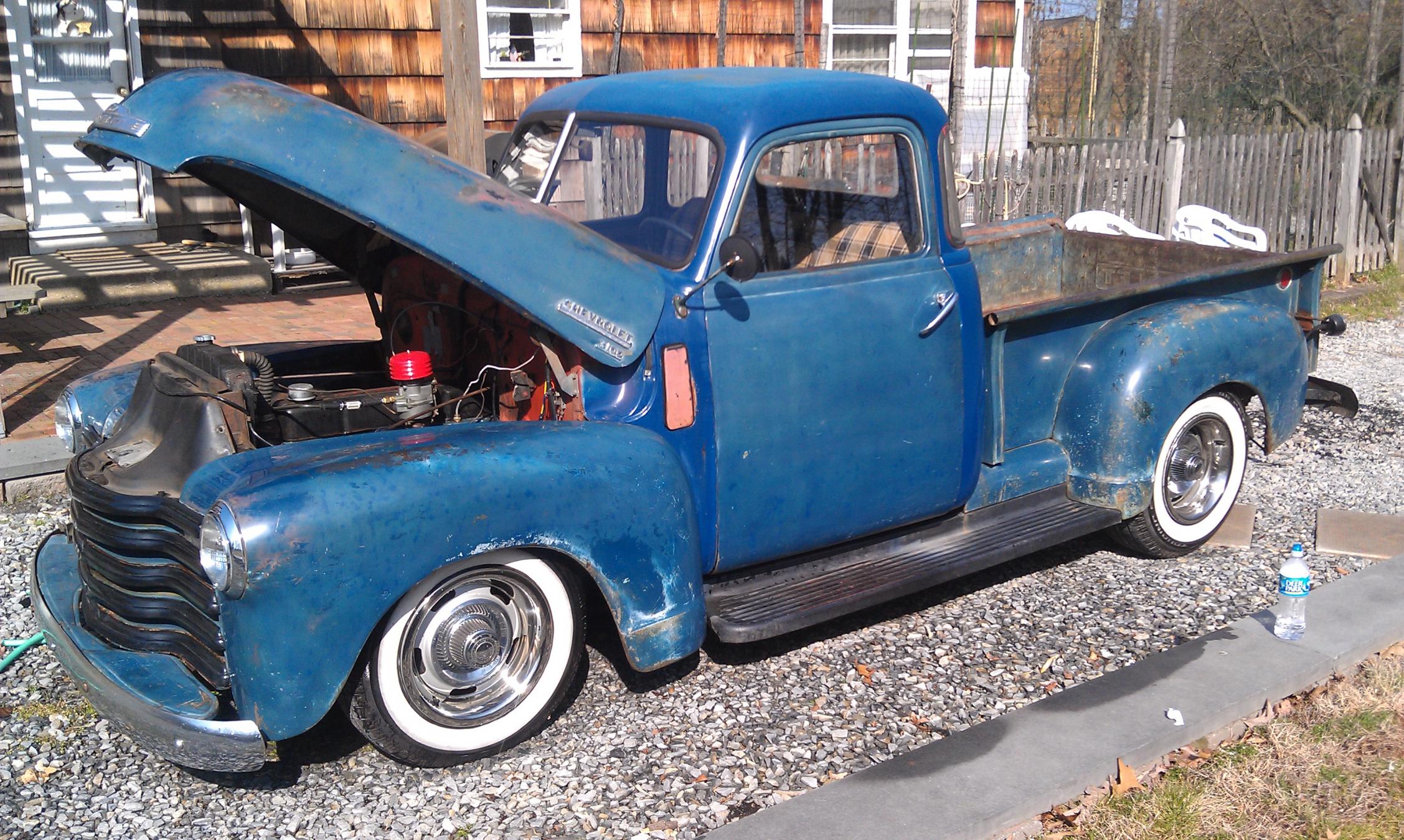

    my 1950 3100. just made my own wide whitewalls out of thin whitewals as you can see on the pic, by grinding the black rubber off the sidewall and making it look nice and pretty how it is now! lovely

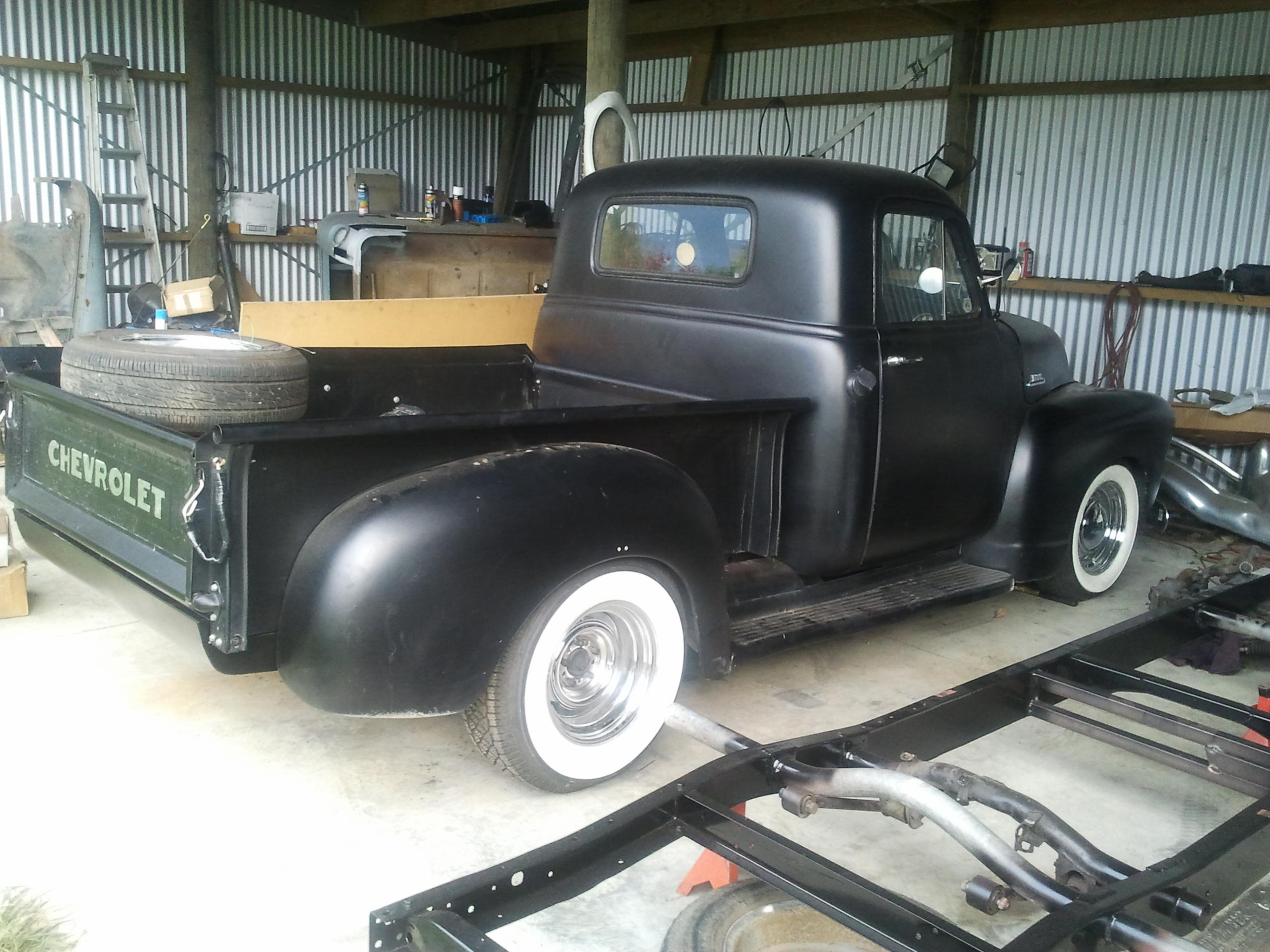

  8. Our 48 with a 54 grill. Bought it a couple of months back with a 250 cube 6 and Toyota 5 speed. and Jag suspension front and rear.
    Is about to get a 350/700R4 so I can use it to tow my blown bucket to the drags, and Redneck has been going thru it and sorting a lot of little things that will otherwise piss me off big time.
    Would be nice to be a couple of inches lower but our city had the earthquake from hell last year (185 dead & $30b of damage) plus about 10,000 aftershocks - unheard of anywhere else in the world - and a lot of the roads are completely stuffed now. :(:(
    So the truck height had to be set at "practical" rather than "desirable". And it will get some shiny paint one day.ts not like the world needs another satin black 48 Chev truck, but thats how it came.

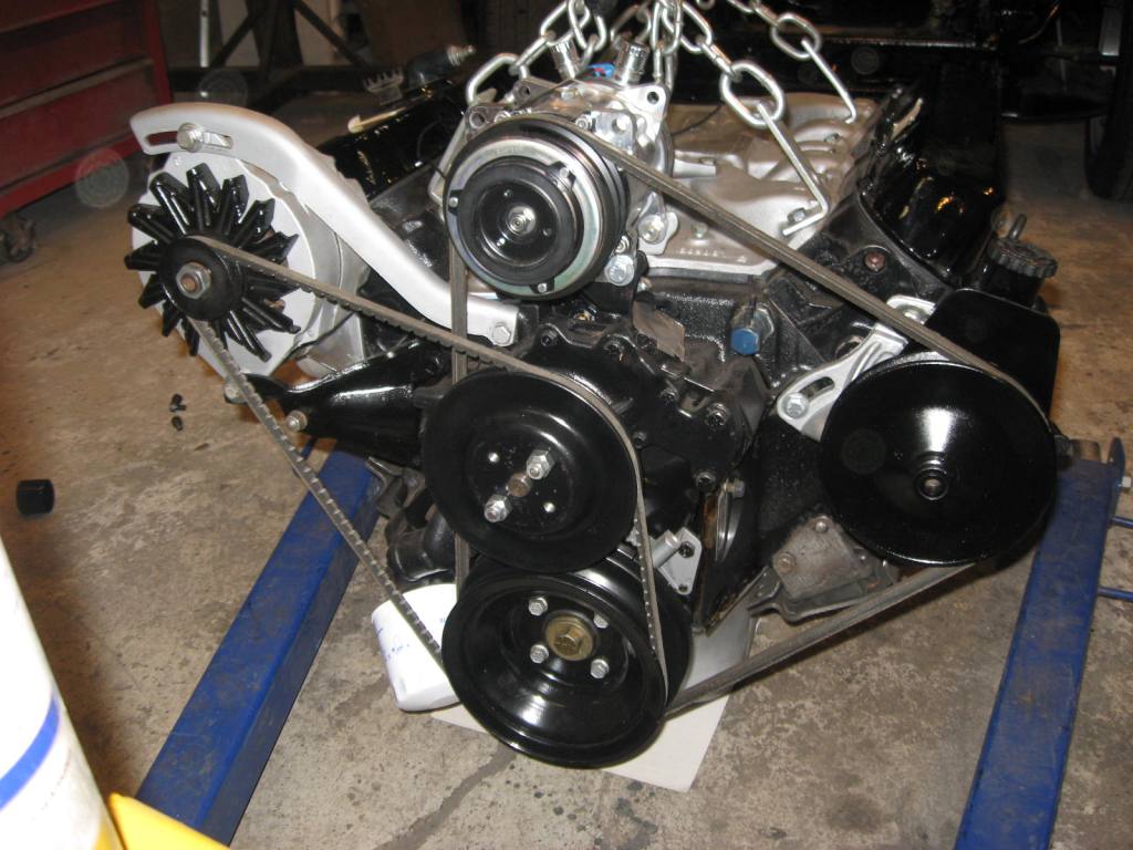

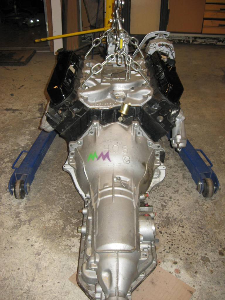

  14. A few more pikkys of our truck. When we bought it, it went to a mate to sort out a bunch of small problems and fit up a SBC so it could become my daily driver.
    It nearly done now & I fly north next week to collect it.:):):)

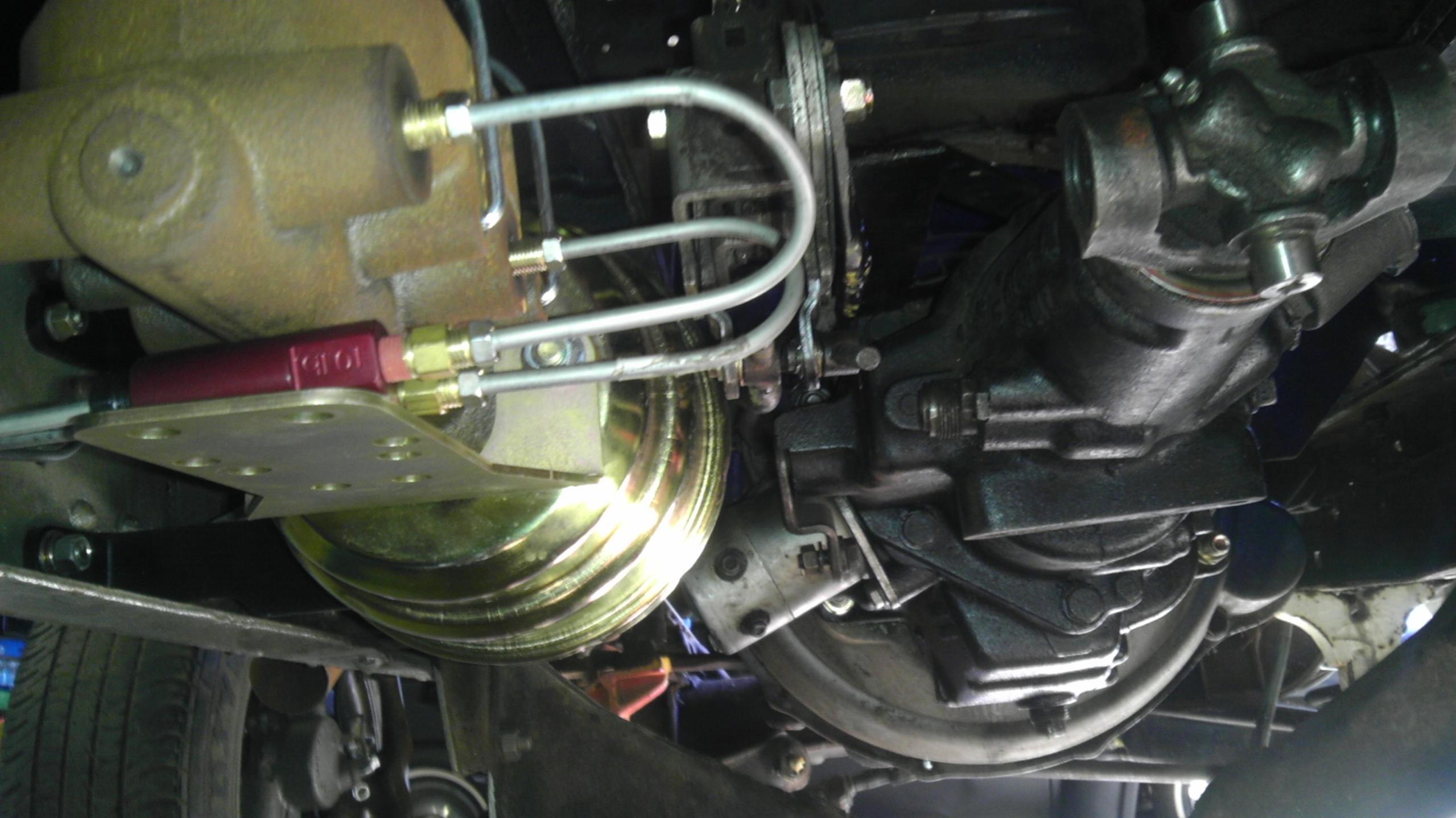

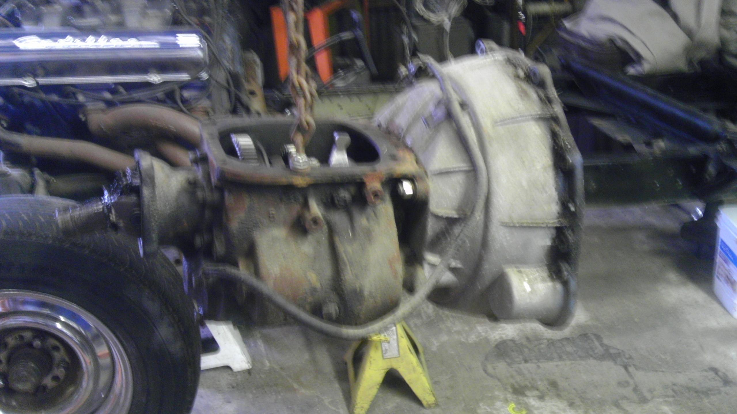

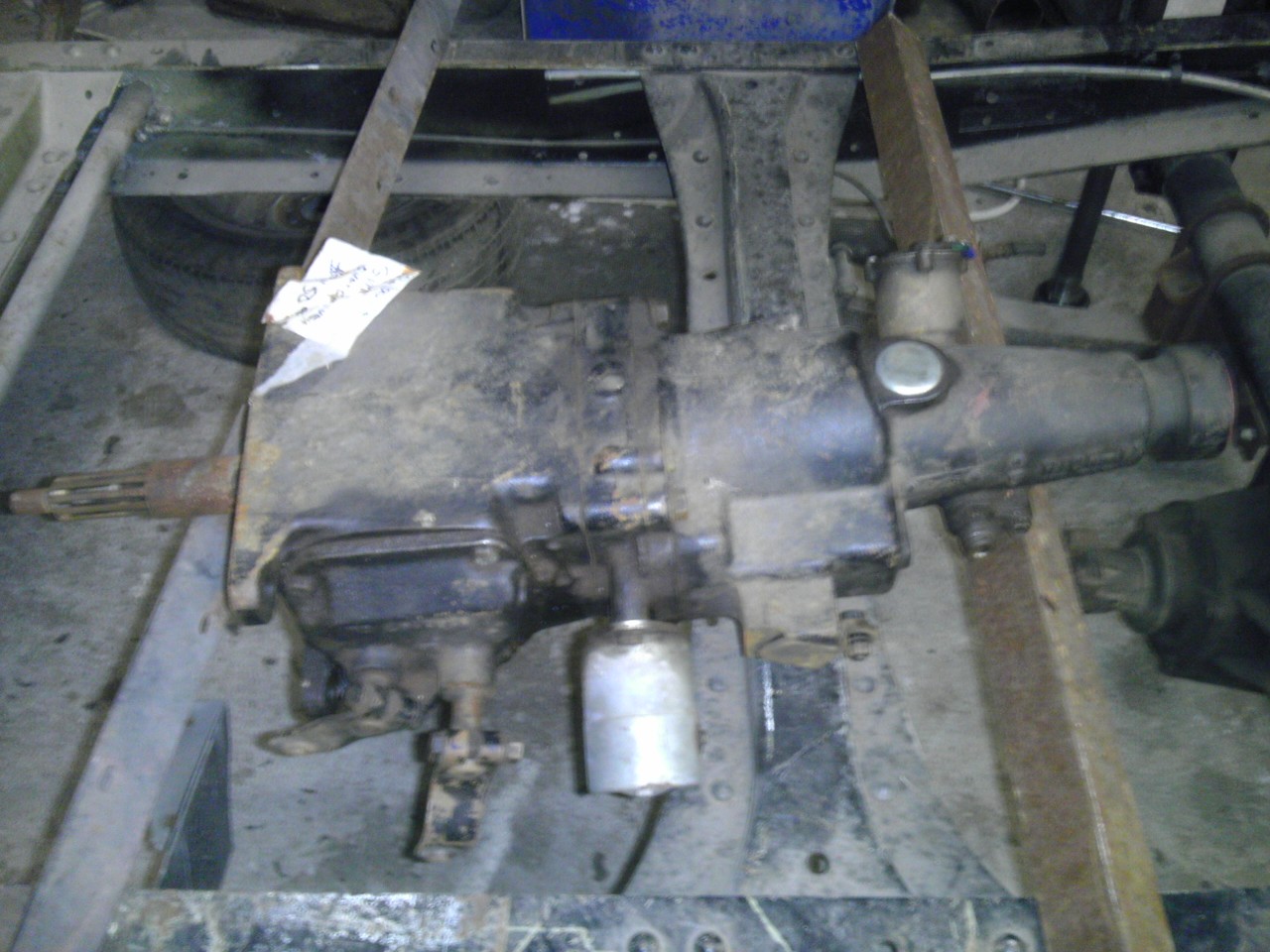

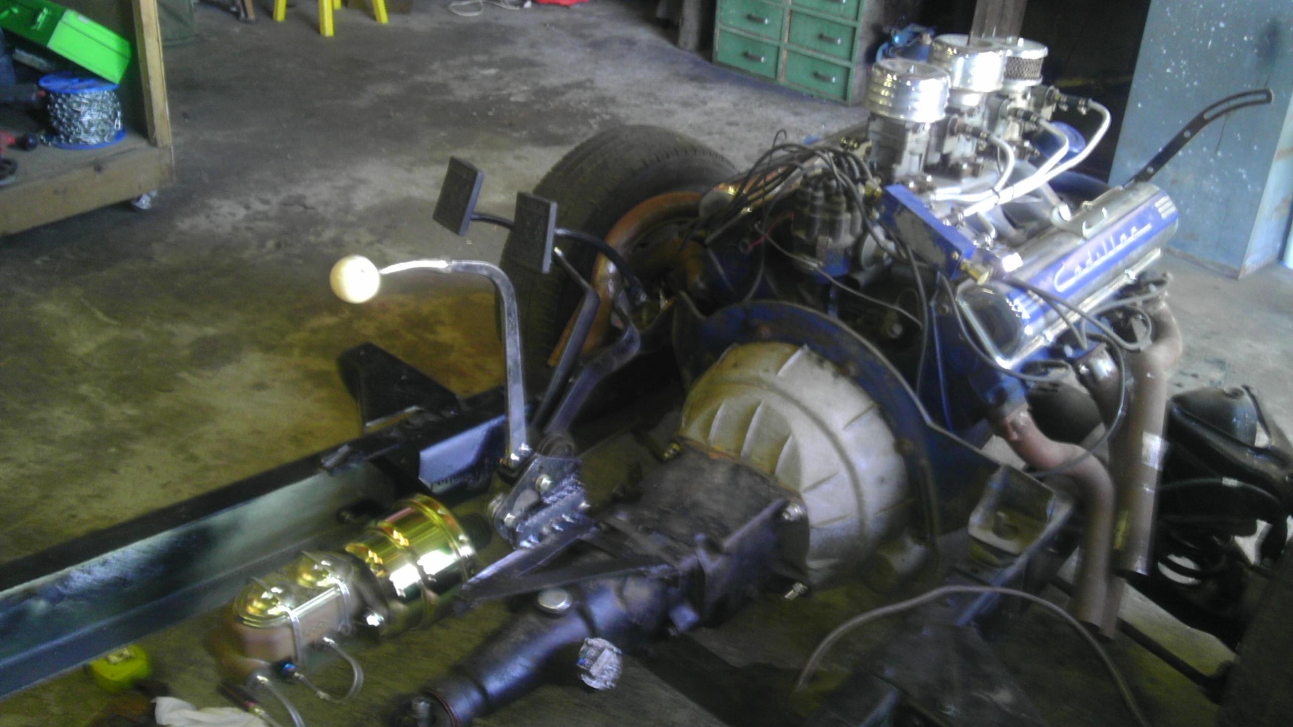

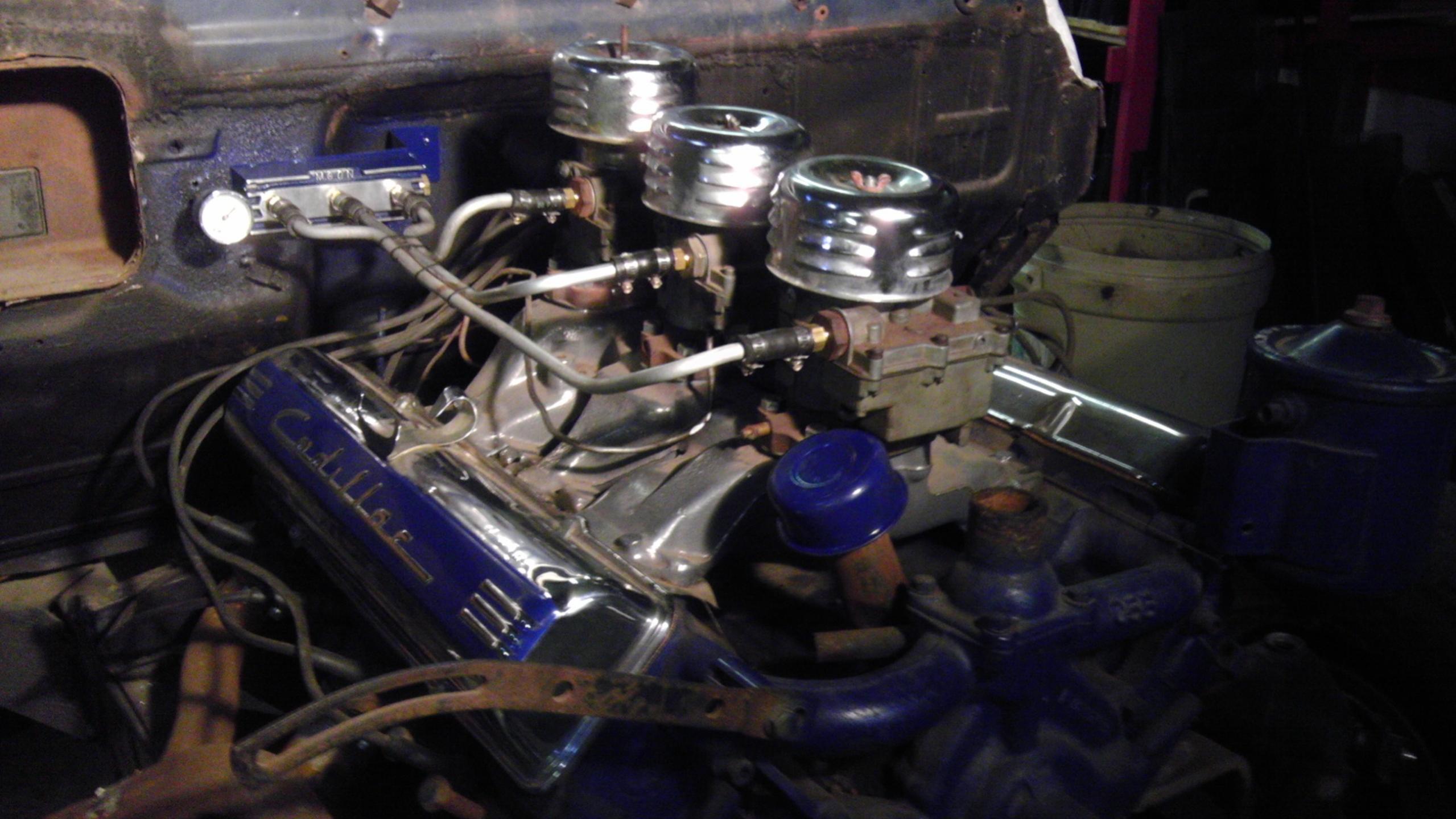

  22. I started with this thread 6-20-2006. I'm over 6 years into a projected 6 month project. better late than never!! sitting behind this 54 GMC is a 48 Ford 3 window coupe started 19 years ago. so I'm really cooking on this one eh!! time for an update
    I have chopped, channeled, sectioned, and extended the cab. running a 1955 331 ci Cadillac with 58 Eldorado tri-power. and 9 inch ford rear that I narrowed 10 inches
    I had had a truck grannie geared 4 speed til a couple weeks ago. just swapped out to a 57 pasenger car 3 speed with Over Drive. couldn't find a floor shift to work with the trans so I built one from old parts.. building the shifter took only a couple hours. making it work in my truck took 5 tries. and it is still close to making a 6th try.
    I have 1949-54 chev (1953-1962 corvette) front suspension, with vette springs, sway bar, disc brakes. CCP power brake unit
    The power brake booster turned out wanting to share the same space as my newly installed shifter. I moved it forward, backward, up, down til I had clearance. now I get under the truck and the speedo cable is going to be close to the shift rods. its all tight but looks like it might work

    Got enough flex in those fuel lines? I do see that you have an inch and a half of rubber on each end. Keep up the good work, love the Caddy engine in there.
