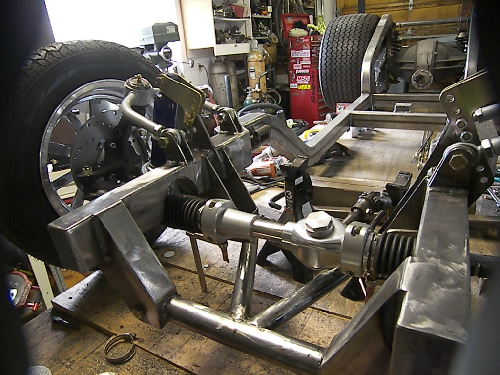

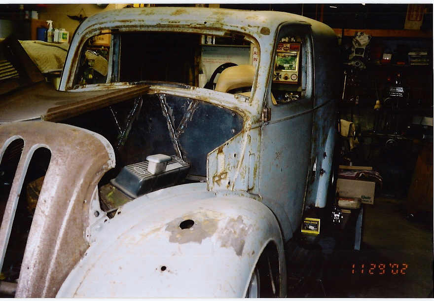

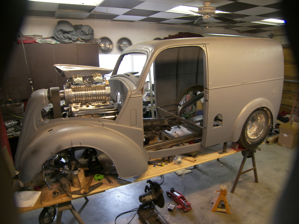

    I have a 48 Thames, have owned it for probably 7-8 years, and just never had the time to work on it,
    but I decided it wasn't gonna get done by itself, so Here it is
    The car was previously owned by a guy in San Diego, he started work on it in the 70's I think, but never finished it,, and it set in his garage untill 2001.. when he sent it To Oregon for his Brother ( happened to be my neighbor)to finish,but before he got started , the owner found a 57 chev he liked better, so the Anglia got Pushed out side, into the Oregon rain,, thats where I found it. and bought it,
    I had other projects going and kept putting the Anglia off, untill just recently..
    this is where I started ( I know I'm gonn catch some flack for this) BUT this is what I did,,,

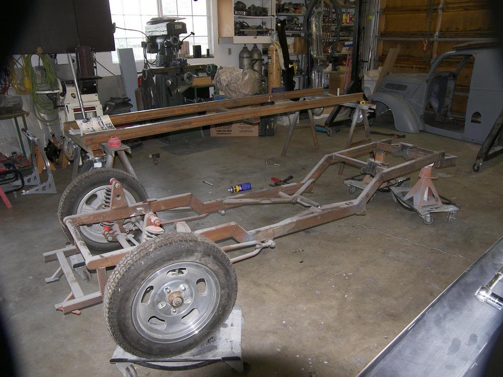

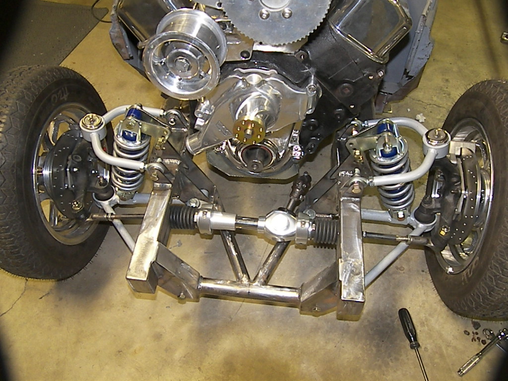

    the ch***is that was under it was ok,with c/o . a 4"dropped tube front axle, a 57 Olds /pontiac r/e , vega steering, ETC,
    I know this was pretty much the old style of build,, and wrestled with the idea of changing it over to something a bit more up dated,,but because I do want to race the car some,, but also drive it on the street, I decided to
    up date a little and ordered a Chris Alston, ch***isworks tube frame kit,
    I already had a winters Q/C I wanted to use,for the street,, and a 9" R/E for drags,, both cut down to fit the ch***is, whether I ever race it or not,,
    I used the independant A arm / rack and pinion steering Alston F/E,
    ETC

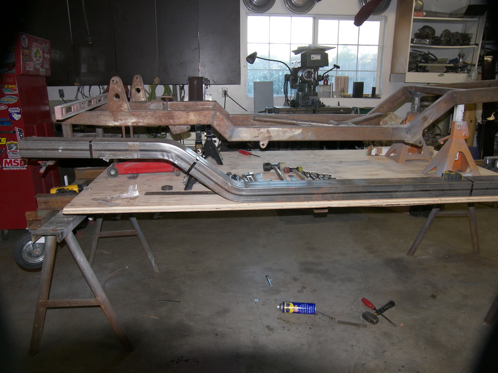

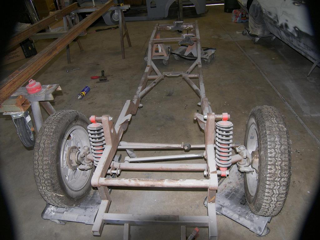

    The first pictures show the old ch***is, I just recently sold it to a guy tht is going to put it under a 49 Auston p/u

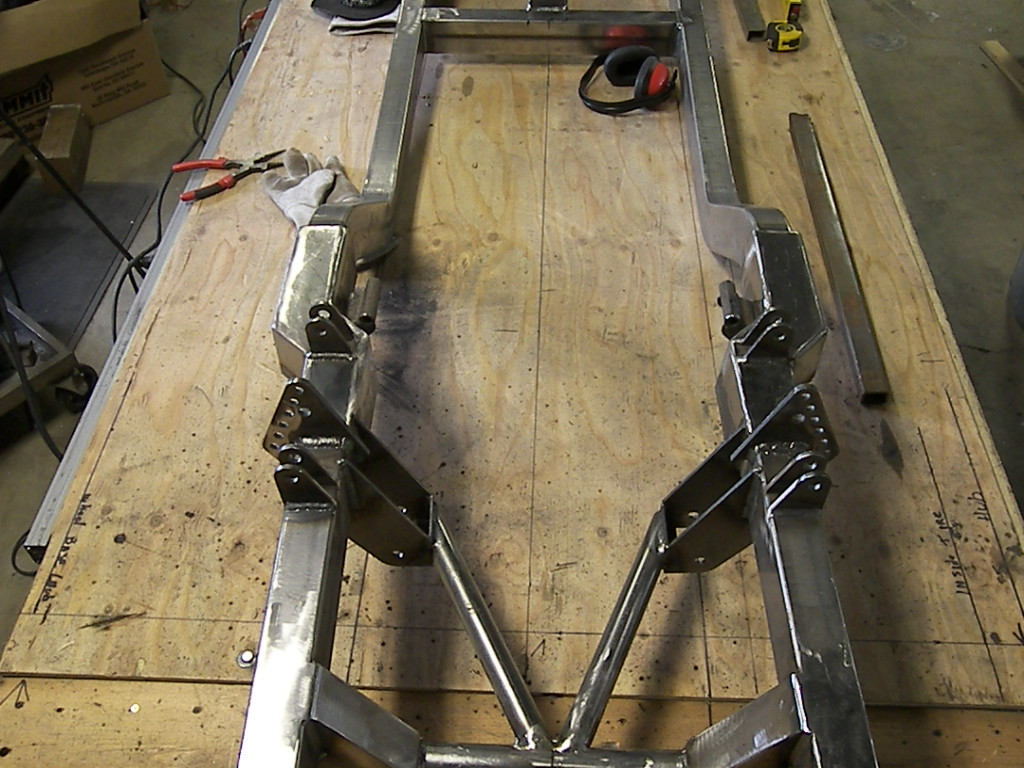

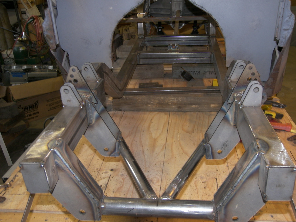

    next is the C/Alston ch***is build
  2. 1slikwilly
    Joined: Jun 15, 2011
    Posts: 45
    1slikwilly
    from Oregon
    C/Alston Anglia ch***is
  3. hotroddon
    Joined: Sep 22, 2007
    Posts: 28,240
    hotroddon
    Looks like the body is in pretty nice shape. I would have stayed with a straight axle, but hey, that's just me.

  5. 1slikwilly
    Posts: 45
    1slikwilly
    from Oregon
    Yeah!! I had a hard time deciding what I wanted to do,, I really liked the nastalgic looks of the old ch***is, and kinda sorry i didn't keep it way,, but what the hell.. :(too late now,,
    I've grown to forgive myself:confused::D

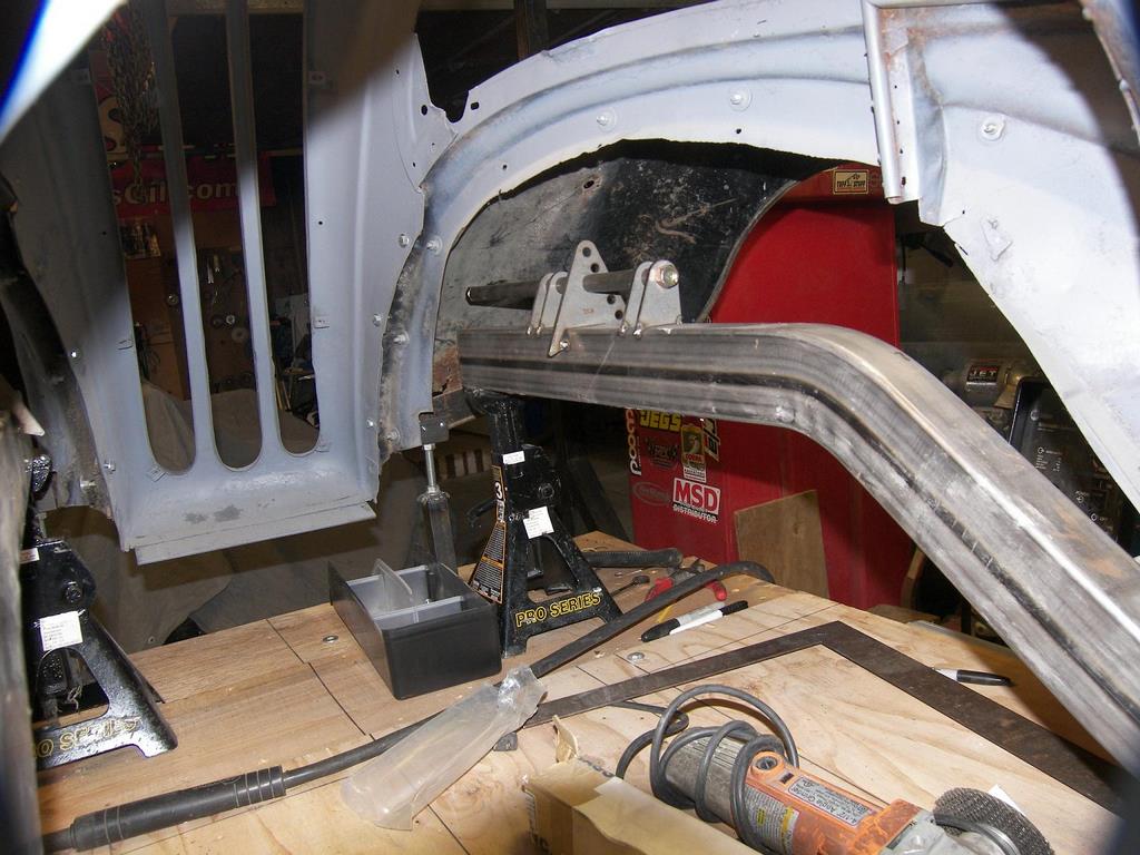

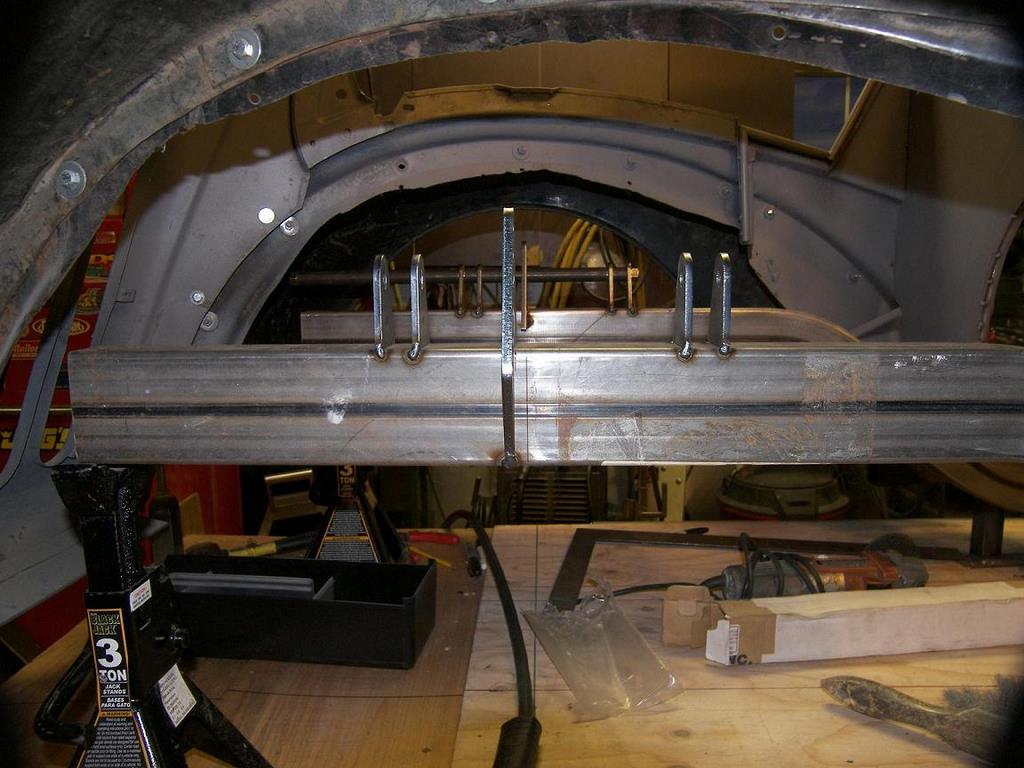

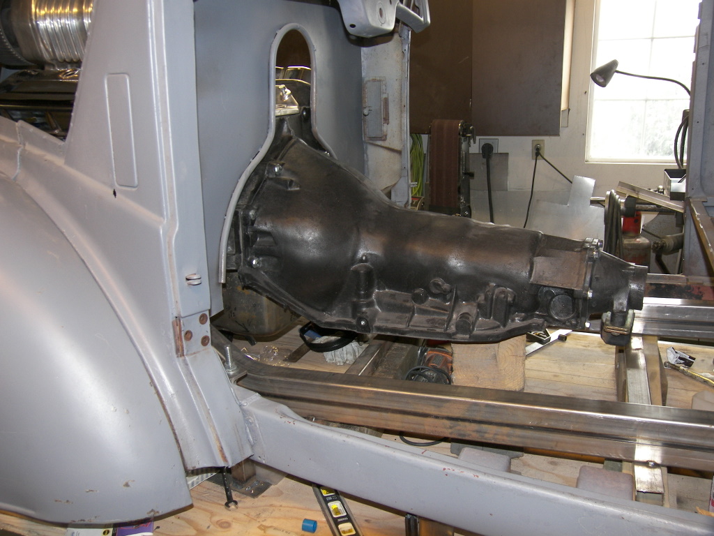

    on the second group of pictures,, when setting up the frame rails,, we went by the same dementions of the other ch***is which was 24" apart, we tacked it all up and set the front clip on to check for clearance.. :eek: the friggin tires wouldn't turn,, the hit the fenders big time,, so I had to cut the front of the frame off just aft of the back a-arm mount,, and move the front rails in 2" on each side, and gusset the hell outta it,, worked out great,, mounted the Q/C and 4 link,, using a wishbone locator ,,,

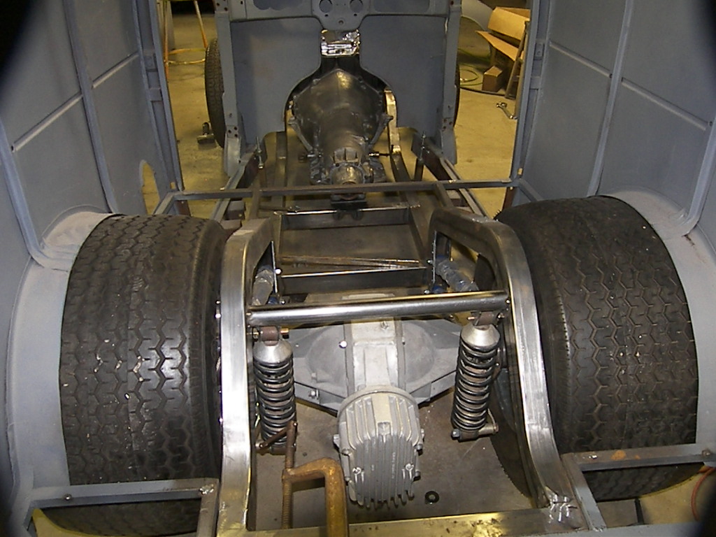

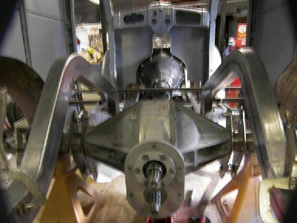

    Mine uses an adjustable 4 link with a wishbone locator as well, with Koni coil overs, all mounting a Dana 60. Been that way for about 40 years

    Thanks for the input , I really thought long and hard about changing it over,, and still kinda kick my *** for changing,, but what the hell:rolleyes:
    I was after the huge components in a little car look ,, like the hotwheels cars:D

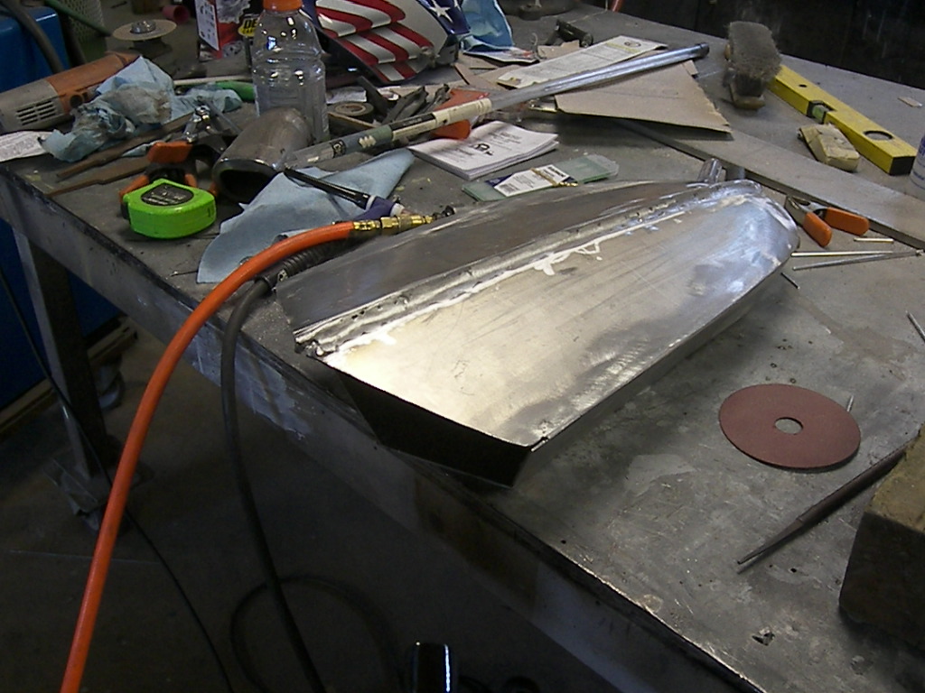

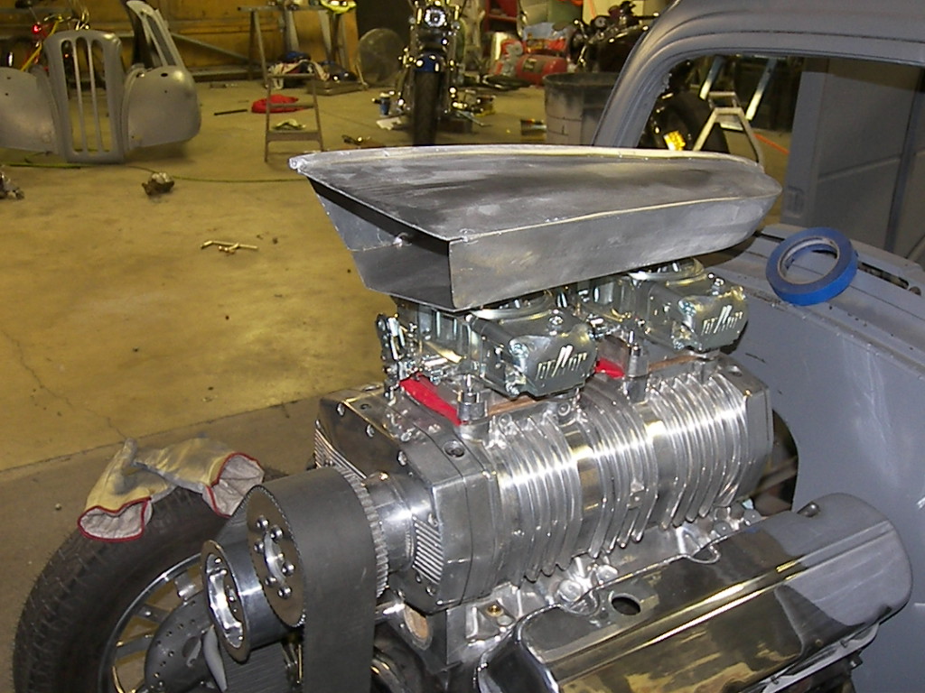

    I become obsessed with small details that would probably drive others crazy. In this pic you posted, I really like how the top of the grill is flush with the top of the blower pulley. That leads your eye right into the engine without it looking like you just stuffed it in there. Very nice!
    I'm really diggin' that scoop, too!
  18. 1slikwilly
    Posts: 45
    1slikwilly
    from Oregon
    I could lie to ya and say thats the way I planned it ,,:rolleyes: but actually thats the way it turned out, which I also liked,, isn't much choice on where a BBC mounts in one of these things.. I had to get it up high enough to clear the ground with the deep pan,, But You do have a good eye,,,
    I have a hood but don't want to cut it up,, wouldn't be much left,,
    the scoop is kinda a knock off of the old Greer Black Prudholme (sp?)scoops, made a mock up out of posterboard, taped it all together, for a visual and size, then used the pieces for patterns,, I have been serching for some woven aluminum or stanless mesh for the holes in the front, and the inserts in the grill,, but can't find a place that sells reminates,, just keep looking I guess..

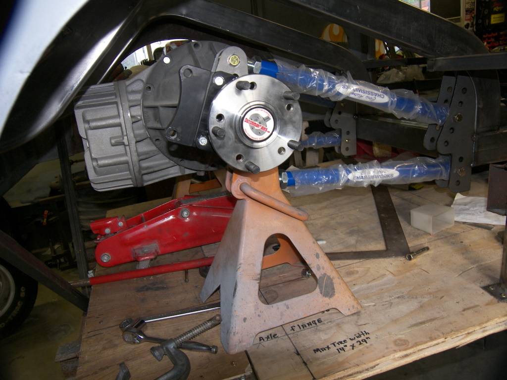

  19. :D Spookily,that tyre/axle set up you got under your coop is what I got planned for my van.Yep,the axle is a Kings ransom,especially getting it brung to Hertford England.The wife was so amused :mad:

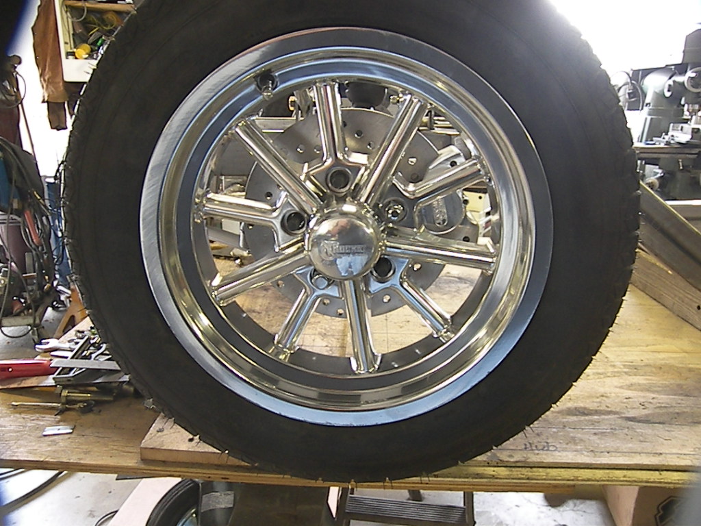

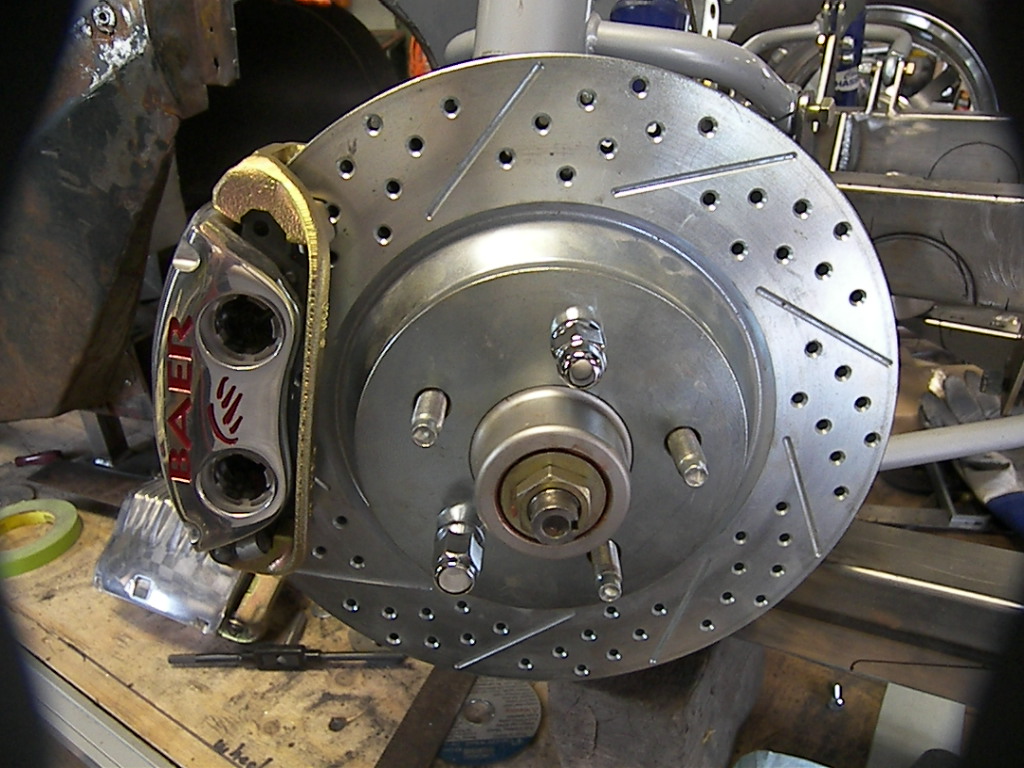

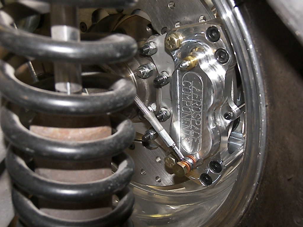

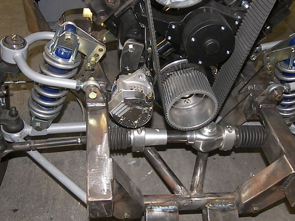

    few more No room to mount the alt, in a normal fashion,, so I mounted it the only way I could find,, and thats backwards,, ,, its actually for a Kabota Tractor, 100 amp but about 1/2 the size of a reg alternator, any aklt will charge either direction as long as they have the internal cooling fins, and not on the pulley
    I had a full set of Baer brakes,(track series) that I had bought for another project,, but sold before I finished it, but the rotors were way too big for the wheels I was using ..( So I will use them on My 69 Bonneville,)so I had to buy some smaller ones,, they are aerospace components, from Jegs,, reasonablely priced, and built for race applications,, so they should work,,
    the wheels are the new Rocket knock offs,, 180 bucks each,, backs are 15X12 fronts are 15X 4 1/2

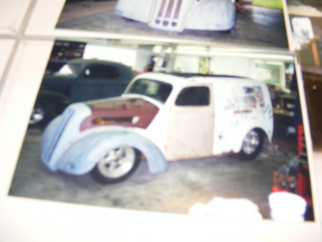

  23. brigrat
    Joined: Nov 9, 2007
    Posts: 6,082
    brigrat
    from Wa.St.
    After I posted those pic's I thought maybe I shouldn't have on your thread, sorry if that's not "polite"!
    What you are seeing is a pic of a pic, that's the distortion.
    Thought it went to AZ, Colorado area 15 years ago?
    Thanks for postin your build!

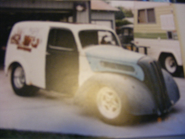

  29. 1slikwilly
    Posts: 45
    1slikwilly
    from Oregon

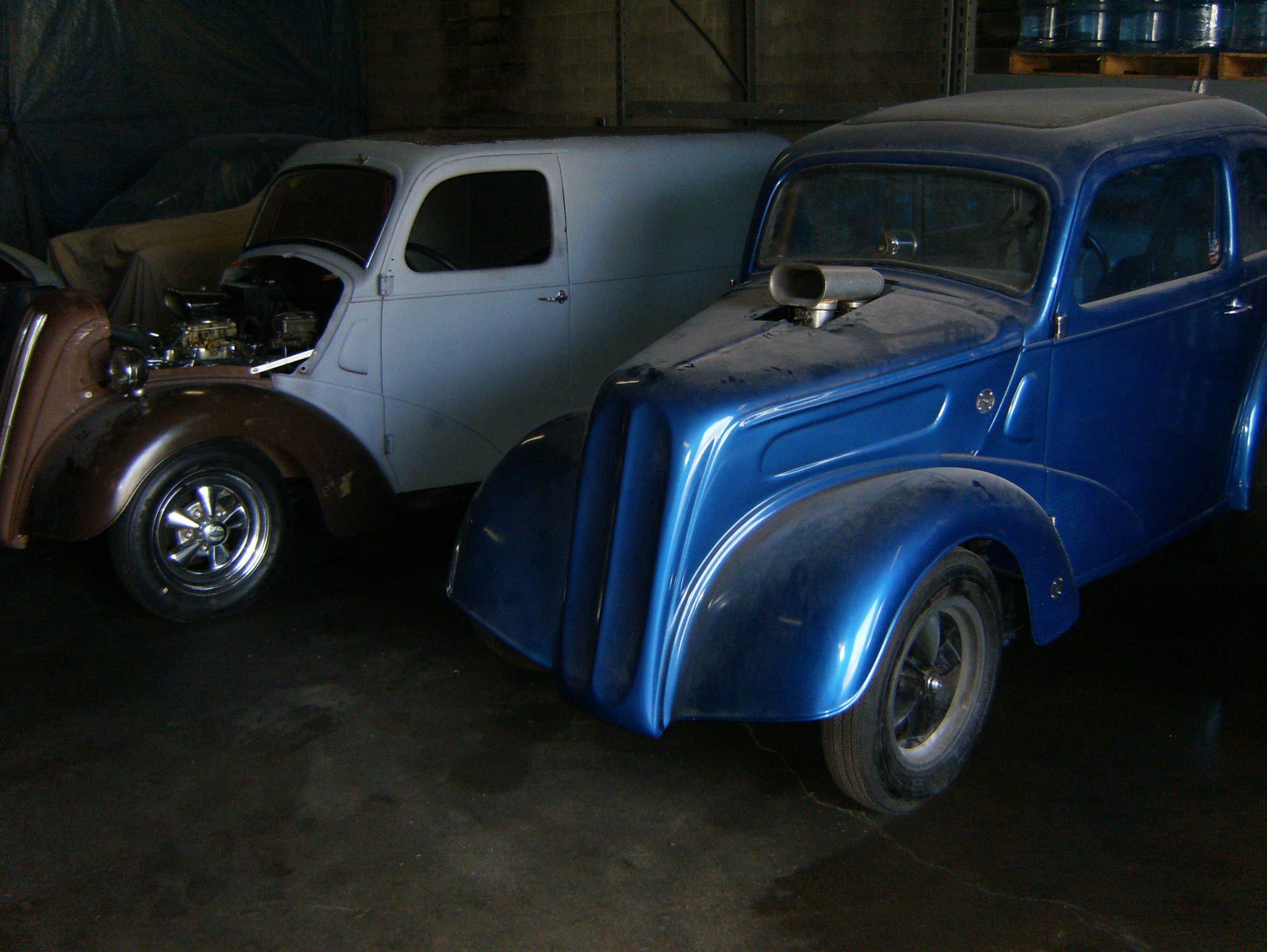

    I saw that Thames at the NSRA nats in Louisville Ky a few years back,, probably the same time you were there,,,it was Hotter than the hinges of hell that day,,,,( I used it as My avator on another site,) his buddy has a sedan painted almost like it except green,,,*****in cars,,,
  30. 1slikwilly
    Posts: 45
    1slikwilly
    from Oregon
    like this one? are both those yours? looks like the blue one is gathering a little dust? need to get it out and blow it off,, I'm getting antsy to get mine running,, its been a long project,, honey -do lists always seem to have priority
