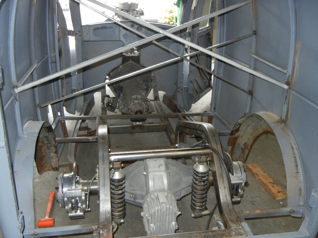

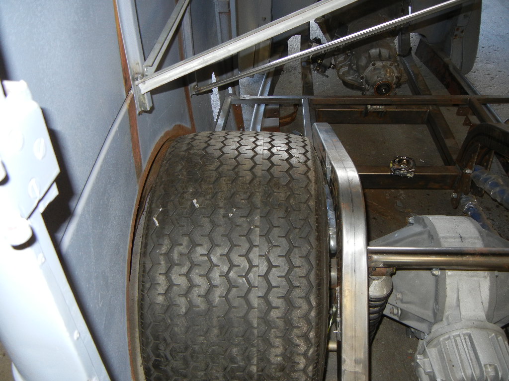

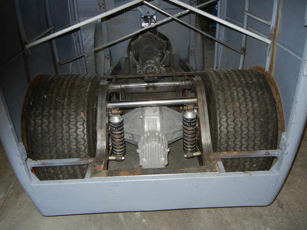

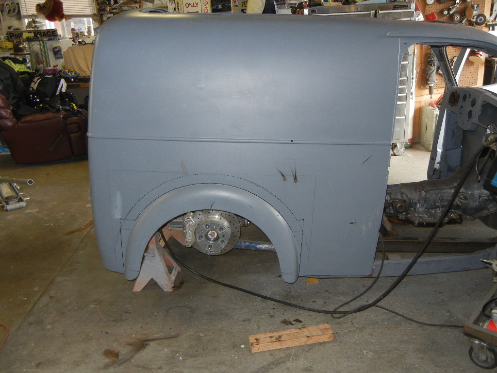

    I finally took some time from the honey -do- list and got a little done on the Anglia today
    I have been sweating the clearance problem with the rear tires,, wondering what I was going to have to do to make things work ,,and not have to alter the fenders,,
    So I decided to remove the parts that the previous owner left of the origional inner fender tubs, to see what kind of clearance I could get,,
    I think everything will clear just fine, I jumped up and down on the back of the body and nothing bottomed out,, (My fat *** makes it bounce pretty good):eek:
    Now I need to get a subfloor built in the body and some body mounts,, also thinking about some running boards,,
    EDIT . when I cut out the bracing that ran verticaly up the sides and attached to the origional wheel tubs, ( after doing the cross bracing) the sides popped out probably 3/4 of a inch. on each side..( notice the 1st & 2nd picture on the bottom row) now the body sides have a nice smooth roll to them all the way from the doors to the rear, relieved a lot of tension appairently..
    now I will build a body support structure out of 3/4 X 1" tubing,
    I like the way the tires are buried in the rear

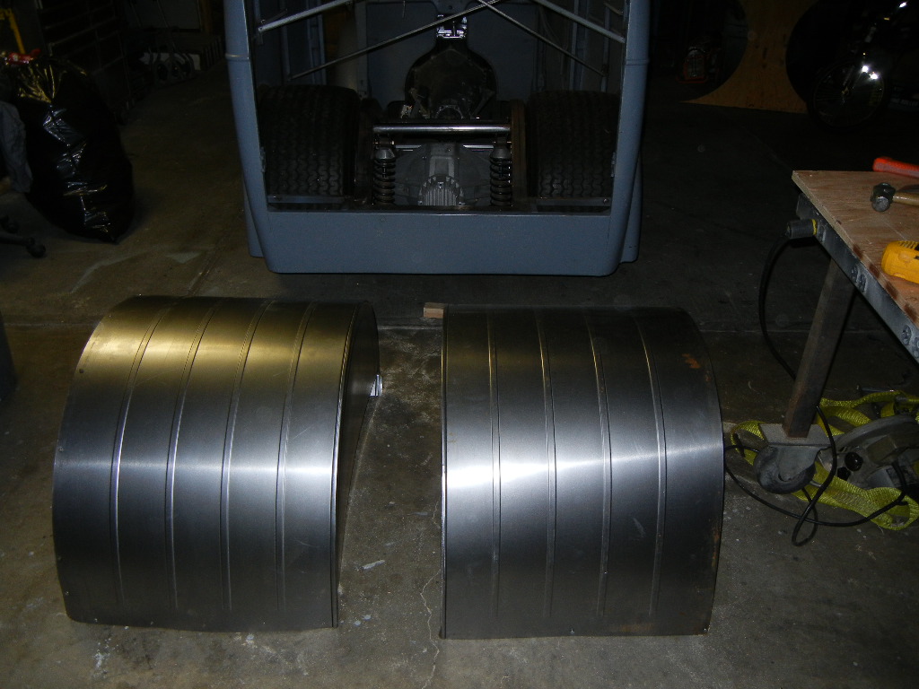

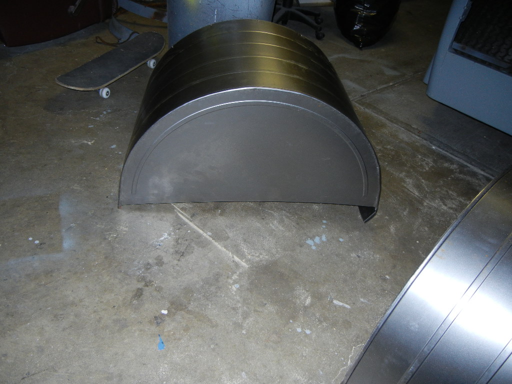

    got thewheel tubs put together today,, what a fight that was,, need to be cut down to 16" wide,, they are 24 now,,

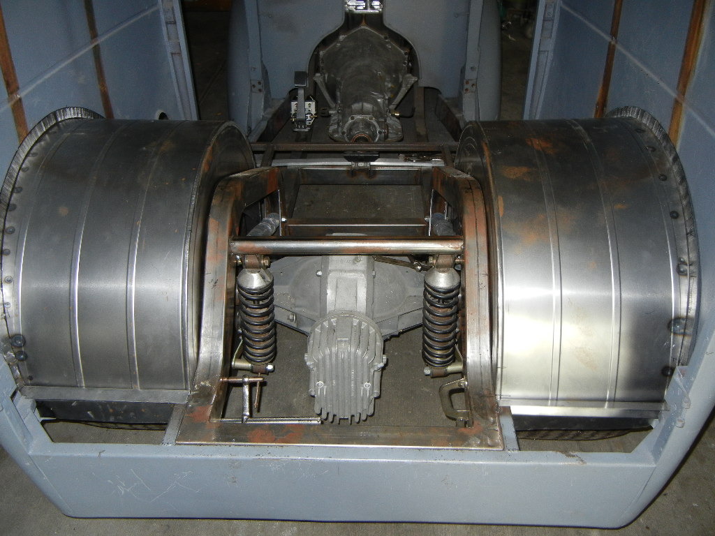

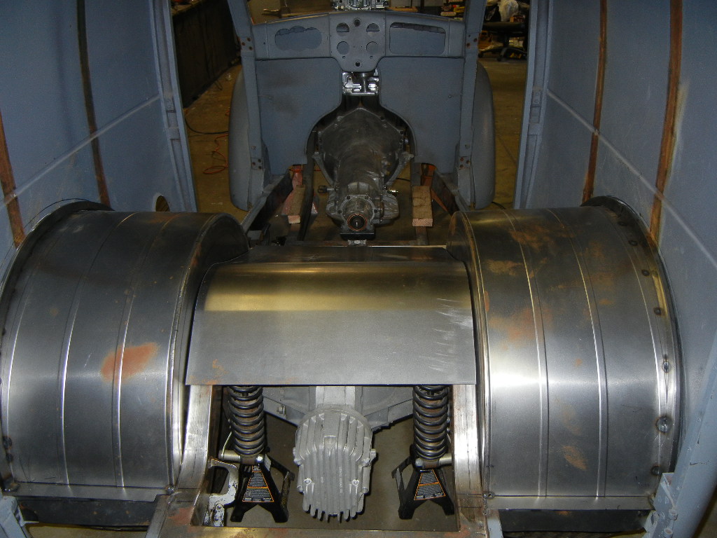

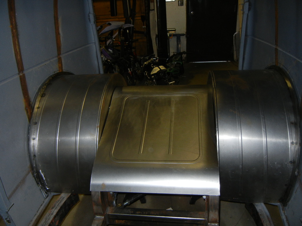

    Got the tubs in
    after taking out the origional wheel tubs, and bracing,, the sides popped out about a inch on each side,, allowing enough room for the tires to clear the sides,, so no need to move the fender up now,
