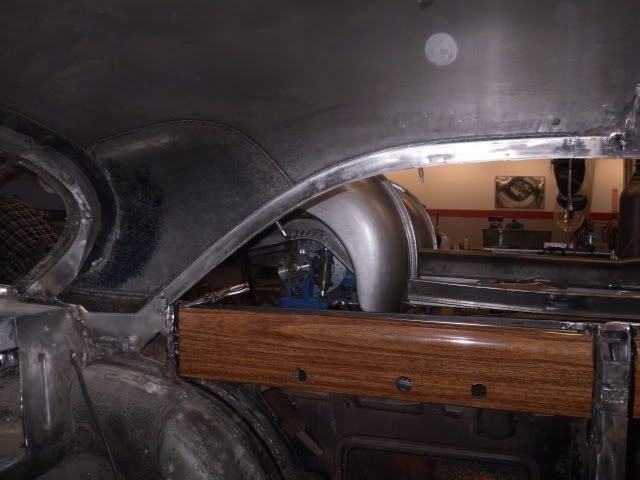

  24. 'Absolutley stunning.........
  25. low springs
    Joined: Jul 10, 2003
    Posts: 2,499
    low springs
    from Long Beach
    the inner reinforcement is done. putting the drip rails back on.
    the front door top edges was made on the Pullmax. since it's going to be a hardtop the edges needed to be straight. there used to be a curve to for the vent gl*** and attachments.
