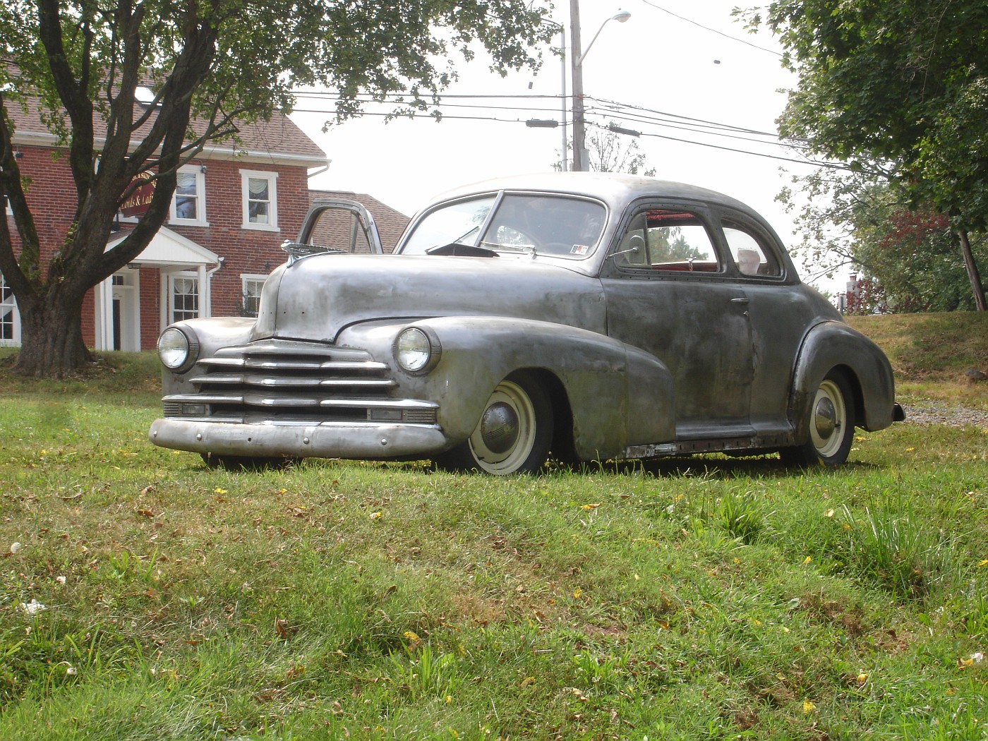

    here's mine
    its in bare metal..no major work anywhere on the body.
    I did have to fix some poor patches done by the previous owner on the rockers..
    Its back to this state and better after the little "mishap" I had
    I really like these big cars.
    they ride good, and are comfy inside.
    I wouldnt buy ems floor pans..
    just make your own..
    the floors are mostly flat anyhow..
    fwiw
    mine is Mustang 2'ed and 10 bolt just like Kustombuilder suggests his will be..
    mine is not bagged.. it may get air ride next year..
    I have a few spare pieces if you need them

    ch***is eng. front crossmember.. (bolt in)
    posie rear springs
    350/350..
    gennie shifter (for now)
    tonight I switched out the stock steel tank for a 18 gal poly tank..
    the seats are recovered stockers..
    steering is via.. a 52 olds accessory wheel
    really.. no body mods and really I dont plan any..
    eventually I may chop it.. but I doubt it..
    too busy with other projects..
