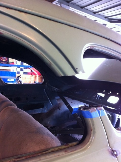

    With the weather finally not being near zero degrees for the last few months, I finally managed to get started on the chop. After some thought, and common sense, I decided to do a 4" chop instead if the planned 6".
    Shown in the pics to this point are the first cuts and the mockup. Measuring and tacking into place will soon be replaced with newly formed sections and final welding.
    Truth be told, I was scared to death about doing this. Even as I far as lifting the roof off of the car I was still kind of scared and freaked out. My whole mood changed when we set the roof back on the car, for a quick look, and we were able to visualize the new height at the A-pillars. I'm truly excited now to move forward and get this done. My goal is to make its debut, even if its still a work-in-progress, at the Midnight M*** Detroit show in July.
    I hope you guys enjoy the destructive pics so far. This is, by far, the largest and most complicated project I've ever taken on. :) ImageUploadedByTJJ1365355131.669035.jpg ImageUploadedByTJJ1365355164.726087.jpg ImageUploadedByTJJ1365355180.921025.jpg ImageUploadedByTJJ1365355203.037853.jpg

    It's been a while, so here's my latest update. I had to take a break on the car, but have since gone back in full-force. Most of it is mocked up and tacked in place. I have a few section I need to create, but those will come later.
    I decided, after looking at a few other chops at car shows, to remove the drip rail completely. To be honest, trying to incorporate is a little beyond my skill set so removing and filling was the next best solution. It looked pretty good without it on a 50 Merc I was checking out.
    The roof panel has some serious low spots, but I'm working on that. I managed to get the C-pillars and backlite laid down. The backlite is tacked in place and the C-pillars are just clamped in place for now.
    I have to admit that this is a pretty tough job. Frustrating at times and I would question why the hell I did this. But I know exactly why. I'm quite the amateur, but I'm doing this for me and no one else. Call it a midlife crisis or whatever, but I feel alive a accomplished every day I work on it. The more I work on it, the happier I am with the progress.
    Here's a few pics of the car as of today.
