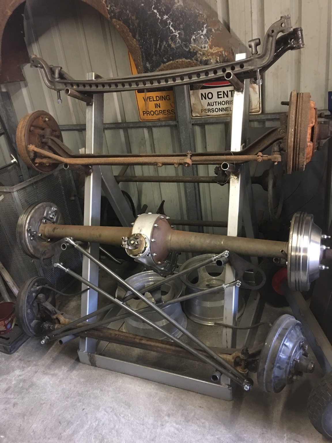

    As a late follow up,
    i have the diff finished and at home, cost of the machining ended up at $100, the brake backing plate has some interferance but i have some newer bells from a 46 one ton pickup to try on!
    Thanks for all the help and suggestions, will definatley help in future builds!

    Be sure and strap those axles and rear to that metal stand so they won't 'flip" and fall.
    brind likes this.

    Already onto it, cheers [emoji1303]
