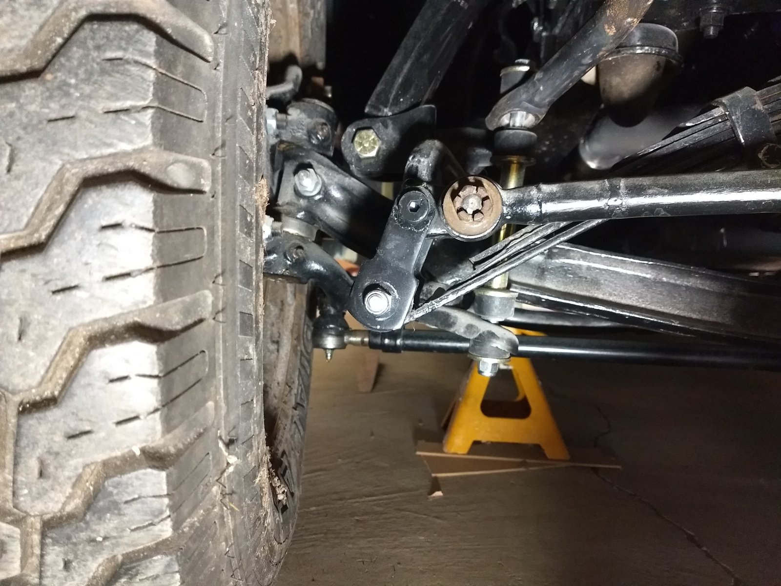

    My spring on my 41 is tired and need to replace. Figuring the correct length has been a puzzle. I have a stock panhard set up and seems like if I try to make the shackles point inward \..../ the p***enger side will bind in the panhard stud. Looking online at pictures I see all kinds of shackle angles for 40's Ford's. Any help would be great. A couple examples

    Those were just reference I pulled. Here is mine without any weight on the front. When off the jack stands the spring is horizontal and I have maybe a half inch clearance to the bump stops (using a sectioned cross member to lower the car). I was just confused because all sources seem to suggest subtracting 5 inches from your perch centers to get your spring length but this won't work for me because of the panhard mount.

    You need to tighten the sway bar link's and the locknut on your panhard rod isn't doing anything with no threads showing.

    Thanks, I was in the process of removing the spring so it's half taken apart. I guess I was thinking that the spring being too long was part of my problem. It probably is a bit long because my wishbones are split to make room for a th350 so the spring perches are a bit narrower than stock.

    Has that panhard bar been cut and welded?

    Is that the correct axle? That main spring looks way too wide. Your shackles are almost mirrored to what they should be

    Also, that panhard rod may have been modified (could also be installed backward?) so the axle may not be located centrally.

    Thanks all. Comfortable now with the shackles angled out as it seems with a panhard and sway bar the axle isnt moving. Yeah, the bump stops are going to get a haircut when I get this figured out. Panhard is getting rejiggered as it is straight across currently and interferes with the spring clamp. The joys of piecing together a front suspension with unknown year parts.

    '41-'48 spring shackles should hang straight down with the weight on.
    The overly long spring won't be able flex correctly and instead will try to bend; resulting in a bad ride.
    Posies has a variety of spring shorter lengths to make up for narrowing of the spring perches due to splitting and moving the back ends wider.
    If the car is lowered you have to modify the Panhard bar to fit; looks like someone already shortened it.

    Yep, listen to Rich B. No matter what parts you have, that spring is too long. Ford designed the post-war cars to have their side-to-side motion controlled by the panhard bar. And letting the shackles hang almost straight down when all the weight was on them gave the smoothest ride.
