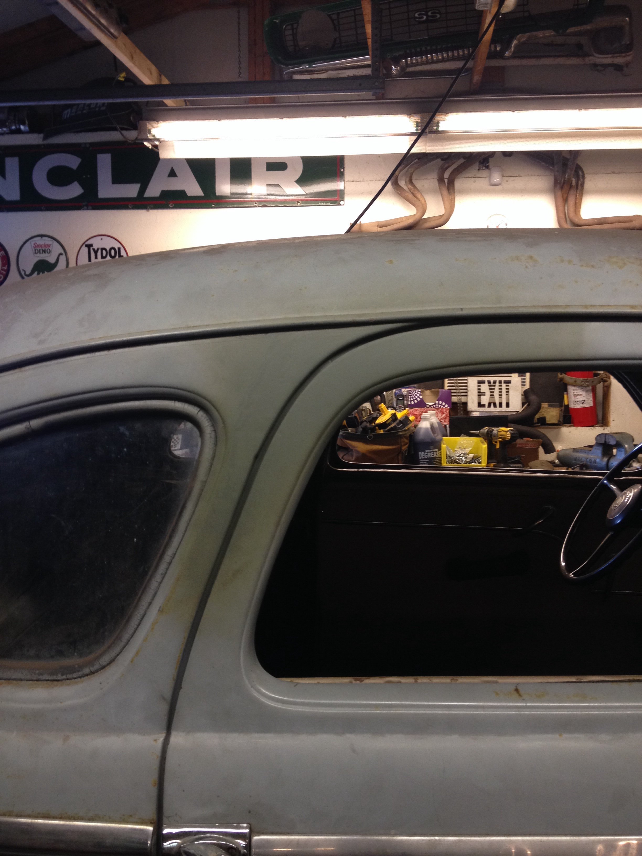

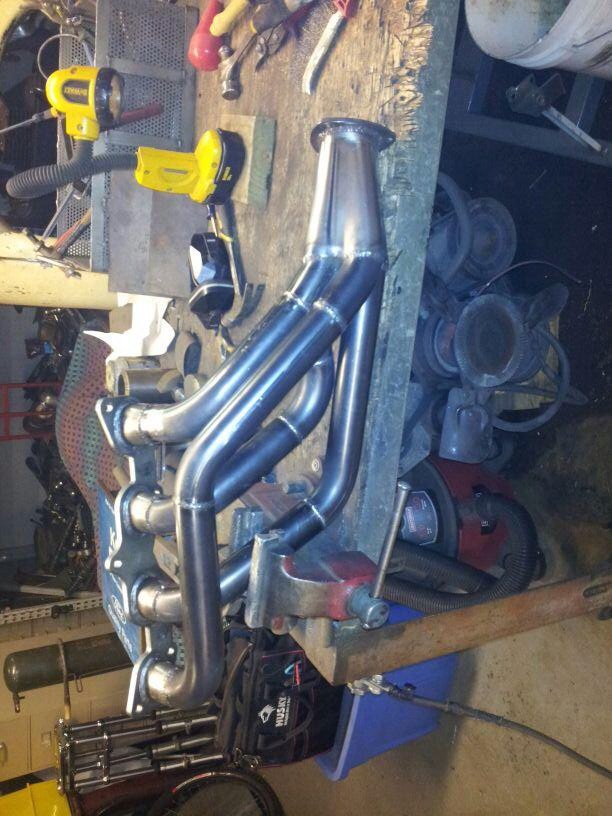

  15. Here's a couple small updates, the headers are done and the door corners got rounded off. That's the only visable body modification. image.jpg image.jpg image.jpg Sorry for the sideways pic

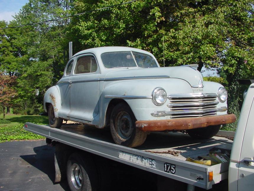

    this is from the ad here on the hamb
    finally rolled the old girl outside for the first time in about two years. it's was nice to get some perspective on it. the fab work is almost done, when i get it home i'll take a bunch of pics and post em if anybody is interested.

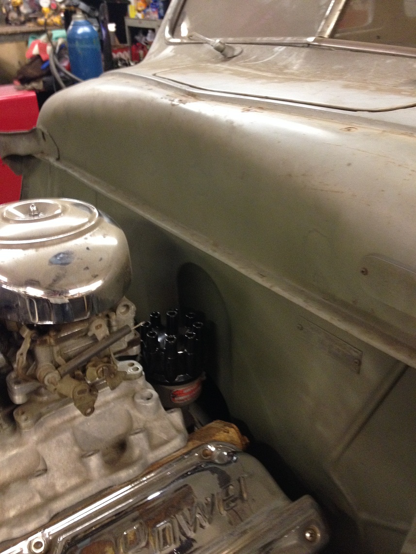

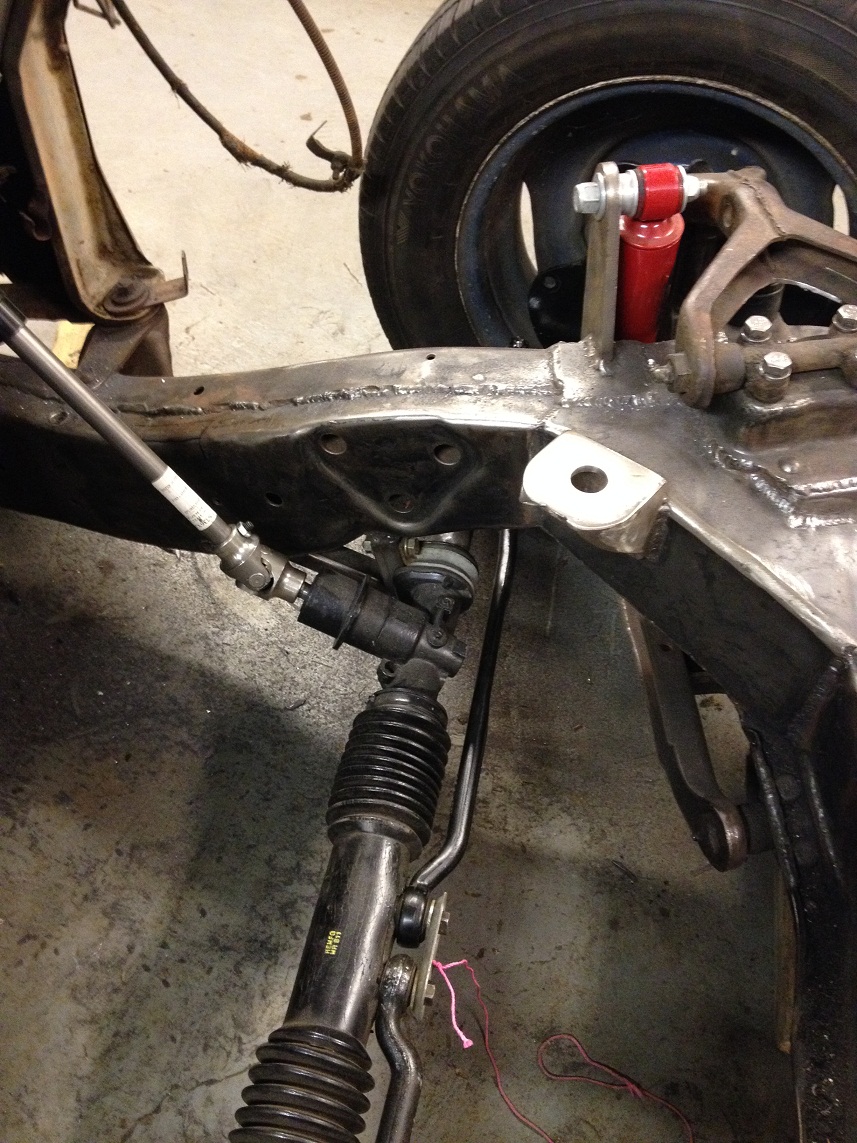

  26. OK! the fab work is almost done, the car should be home next week. here's a few new pics. the inner fenders are notched out to clear the big HEMI, fire wall pushed back and dimpled for dizzy clearance,
