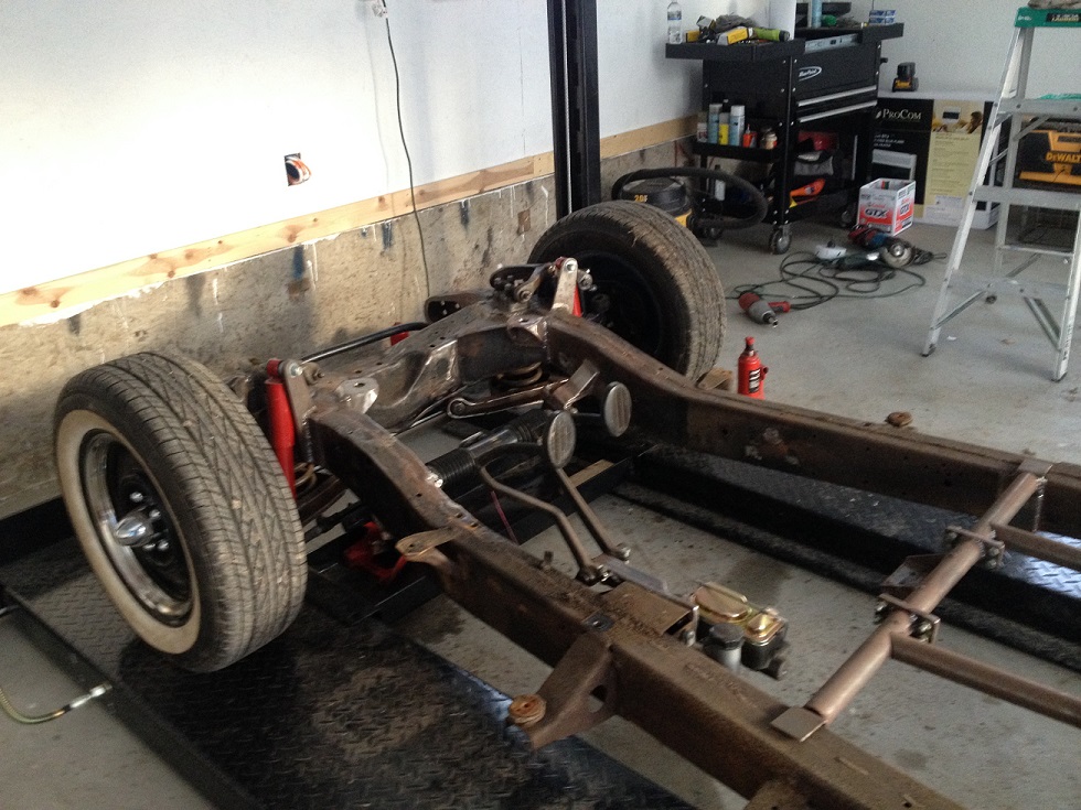

  16. finally some progress! the 354 is off to the machine shop and the body is off the frame. just a basic rebuild on the hemi, isky cam, .030 bore, the usual stuff. i have never had an old car as solid as this one, the floor still has about 50% of the original paint left on it no holes at all. the frame is nice too, the type of rust that almost wipes off. the frame gets a little more welding to finish it up then paint and re-***embly, the body gets some eastwood ch***is black then back on the frame. the mill should be back by then. i hope to be driving this thing in early summer.

    Looking real nice. What are you using for a rear end and are you going to put a sway bar on the rear? I got a Cherokee front sway bar today for my 48 and hopefully it will stop the corner "diving". As you may already know, that 354 is quite a bit heavier than the old sih banger.
  18. the rear end is a 9" ,it's got a rear bar from an H2, the 354 is a lot lighter than stock ( a lot of aluminum)

    super kool build following it over on the d24 site also,,, any chance you have pics of the front sway bar and mounting on the lower control arms ??and what is it off of ?? getting ready to do a bigger then stock bar on my 40 coupe, that manual rack had to be hard to find,,thanks in advance,,,

  25. i cant find any good pics i'll try to get some Monday. remind me if i don't. the bar is off a mid/late 90's grand cherokee. the rack is from a pontiac sunfire, cavs didn't offer manual steering. i got from rockauto.com.

    ok great when u get a chance ide love to see pics of the front sway bar and mounting on the A arms,,,thanks
  28. I'd also like to see those photos. After the hell I had with the Fat Man front end on my coupe, I'm thinking much more along these lines for the wife's sedan. Stock, rebuilt front end with disc brake converson, relocated shocks, and probably a power rack set up for her.
