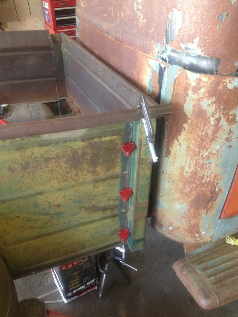

    Had a productive day today shortening the bed. Have some finish welding and grinding to do but here it is. ImageUploadedByH.A.M.B.1377902347.042583.jpg ImageUploadedByH.A.M.B.1377902361.980612.jpg ImageUploadedByH.A.M.B.1377902374.736471.jpg ImageUploadedByH.A.M.B.1377902395.302988.jpg ImageUploadedByH.A.M.B.1377902409.715337.jpg ImageUploadedByH.A.M.B.1377902424.136530.jpg ImageUploadedByH.A.M.B.1377902457.193723.jpg

    On the bed shortening, did you **** weld the sheetmetal there or overlap it behind the stake pocket?
    Anyway, very nice truck. Bed is outstanding!

    Looking good. When i shortened the bed on my 41 i just drilled the spot welds holding the front wall and stake pockets from the bed sides, then with the pockets and wall off, I trimmed off what i needed from the bed sides and then reinstalled the front wall/stake pockets and plug welded them, very little finish work or welding needed, i went from 125" WB to a 115" WB.

    Thanks guys! Yes I did but weld them using my magnetic 90 degree welding blocks to hold it all straight.
    Terraizer I did start to drill out the spot welds on the drivers side but but my drill **** out so I said screw it. Didn't wanna go buy a new one haha
    I don't plan on chopping it. I lean more towards the unchopped internationals. Besides, I'm 6'3 and the cab is short enough with the seats just barely off the floor haha
