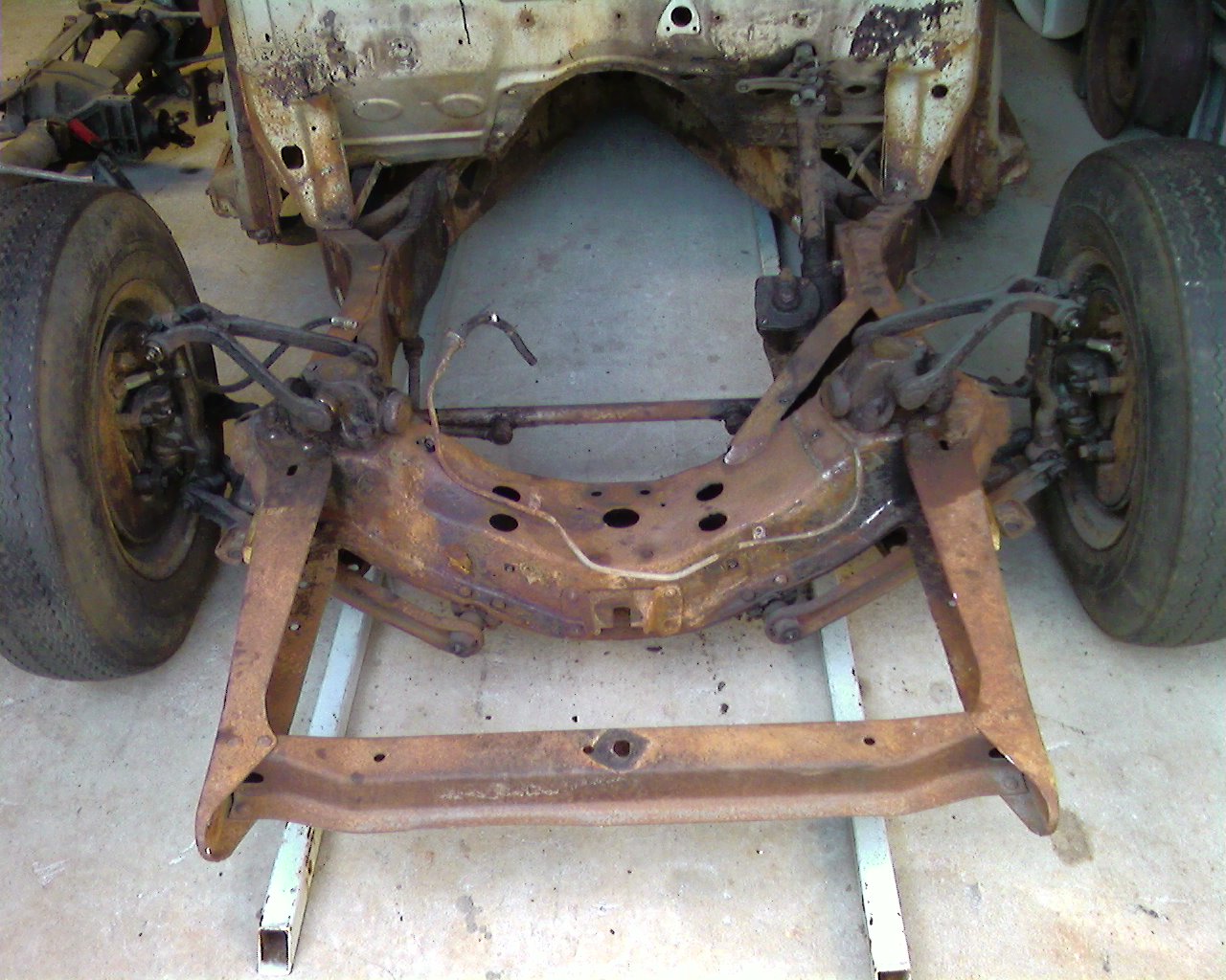

  7. mgtstumpy
    Joined: Jul 20, 2006
    Posts: 9,256
    mgtstumpy
    Is it like this, F/E in my 'B' bodied 46 Olds. Spring pockets are built into the rails with shock absorber built into top A-arm?. Rebuild kits area available, king pins, idler arms, drag links and bushes etc.
    No kits are available to upgrade front suspension so I removed the front end and replaced with new 'C' channel to allow a later IFS to fit. A bit of work involved. If it were an 'A' bodied Chev with top hat style chassis, F/E can be easily removed and replaced.
