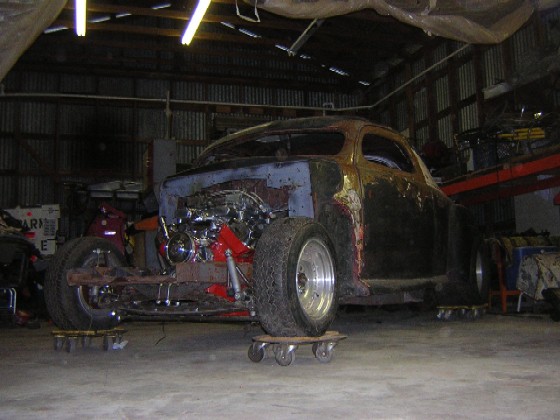

    thanks to Loudpedals tour photo's there is no stopping me now [​IMG]
    I have the motor set back as far and as low as possible.

    I've widened the doors 8 1/2 inches, moved the engine back 14 inches and am moving the seat back 10 inches.
    Things are real busy under the floor. I'm building a double firewall with swing pedals with hydraulic clutch.
    I still have the starter,steering,exhaust all trying to share the same space on the left. the Hemi oil filter makes the right side starter tougher.

    that transmission is a clutchflite, that came out of an A/Altered Fiat that ran at the drags and Bonneville which is a modified 727 torqueflite, the size of the input shaft has been increased from 7/8 inch to 1 1/8 and is rated for 1500 HP (I'm no where near that) I know I answered a question that wasn't asked. [​IMG]
    the ****ter shield has two starter pockets on it and the bottom one is a chevy unit that I'll probably end up using.
    main problem is exhaust, this car ran fenderwell headers for years,major steering restriction.
    I have two options that I can see. a tri Y with only two pipes thru the frame or individual pipes with the rear port going over the frame rail then to a collector.
