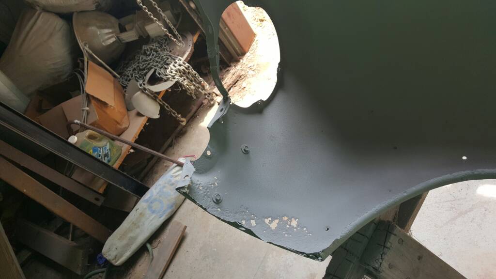

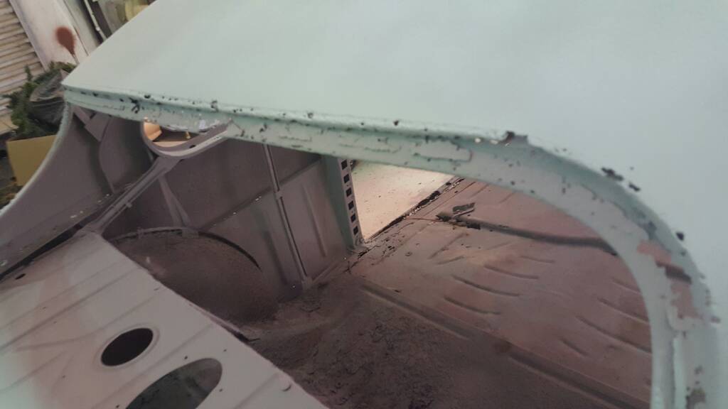

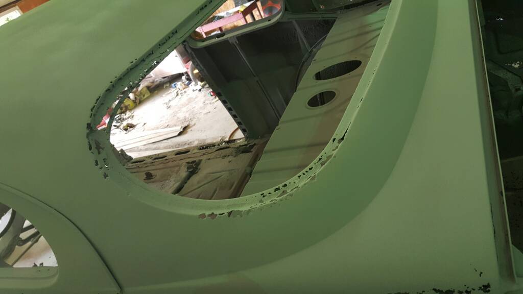

    Steve Welch
    This is where I'm at, lol
  13. Devin
    Joined: Dec 28, 2004
    Posts: 2,408
    Devin
    from Napa, CA
    That's a lot of work! Just start with one spot and focus on that otherwise it becomes overwhelming. I just did this on my rear window ImageUploadedByH.A.M.B.1431194936.896560.jpg ImageUploadedByH.A.M.B.1431194953.095224.jpg ImageUploadedByH.A.M.B.1431194968.995751.jpg ImageUploadedByH.A.M.B.1431194989.115155.jpg ImageUploadedByH.A.M.B.1431195012.695646.jpg ImageUploadedByH.A.M.B.1431195027.708616.jpg
    I'm just a hack. Sheet metal is cheap, give it a shot!

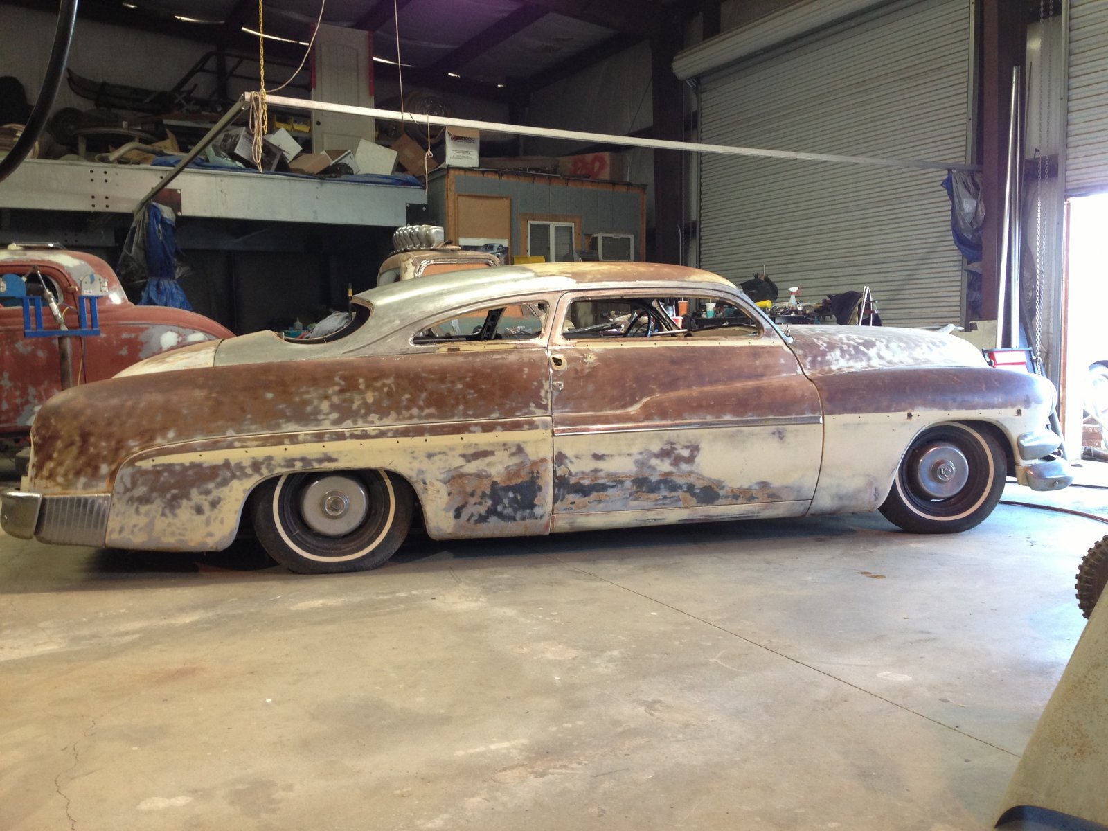

    Here is mine when I drug it home. It was a rusty piece of shit.
    All done.

  16. Devin
    Posts: 2,408
    Devin
    from Napa, CA
    Gorgeous merc, what a transformation.
