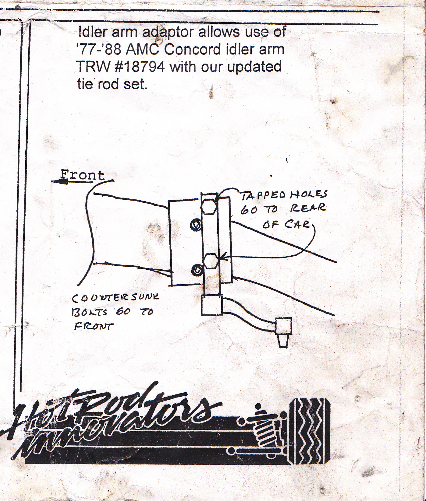

    The pitman and idler arms on this setup point forward (with the stock box both arms point to the rear), so when the AMC idler arm is flipped around the mounting points will be above the frame rail (frame sweeps down towards the rear) see Fat Man sketch. fat man steering instructions_NEW.jpg Since I will be looking for an idler arm that better fits the new configuration, Id like to get one with a length that works best with the new setup.
