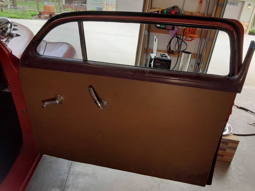

    On the fronts try and cut the B pillar part out with the radius of the horizontal part, rotate to correct the angle and tack back together. Trim the top section where the radius match the door and fill in with what your need. The rears you pretty much need to cut up which every way your think is best. Use your radius as much as you can but sometimes you have to get creative.

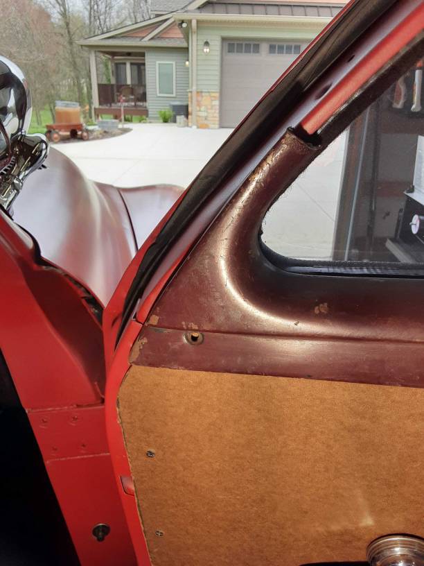

  10. Wish I knew how to put chalk marks on your photos. I tend to do things totally different than others. I hate making a lot of work out of a small job. Myself, on the door trim front corner. You just need to make a tighter radi so just cut on the hip of the molding where the flat part against the upholstery panel begins to roll over to the Gl*** and up to where you cut the top piece off and tighten up the corner. Then on the flat surface from the cut on the hip go from the center of that radi out to the edge with a cut just to the seam of the door top frame but not all the way off. Lay the two parts on the correct plane of the Door itself and weld it up. You will end up with a light step on the raw edge of miss alignment due to the length change of the inner and outter legs going up the A post of the molding. Same basic treatment of the B post but not all the way up to the cut line. I don't care for all the extra work of a dozen slices to make a corner. To much hand work to get a good finish. Ya, wish I had photos of me doing one of these to help with the vision. Last time I did a Merc chop was before digital stuff and I just never took many photos.
    The photo of the quarter molding, yikes! My hat's off to you but I do things totally different. Anything can be hidden under paint but I'd rather send them off to Chrome.

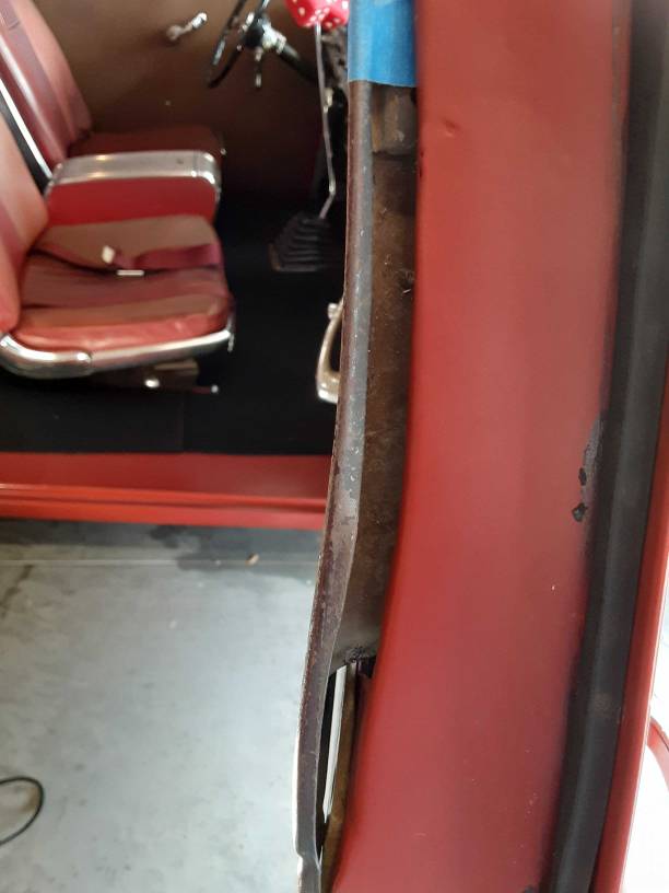

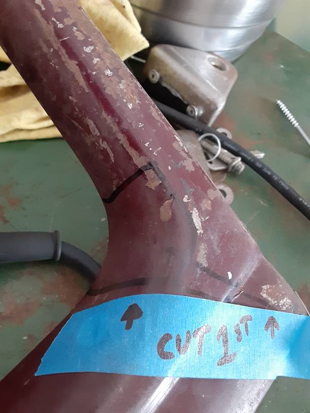

    I've seen it done also where u cut the b-pillar corner out completely then cut to fit once the corner is welded back together. I think that was what Matt was eluding to. 20200407_122522.jpeg

    The point of the piecut should match the bend point on the door. We can't see if your blue tape lines up with that point on the door.
    Personally I'd leave all the flat side of the lower portion in place and only remove the curve up to where it rolls around to the flat face. Doing this will let that bead in te face remain nice and straight. When you get that upright B pillar tilted over, the missing curved area will be smaller and tighter. You can bend the cutout curved steel over some pipe and re-fit it.

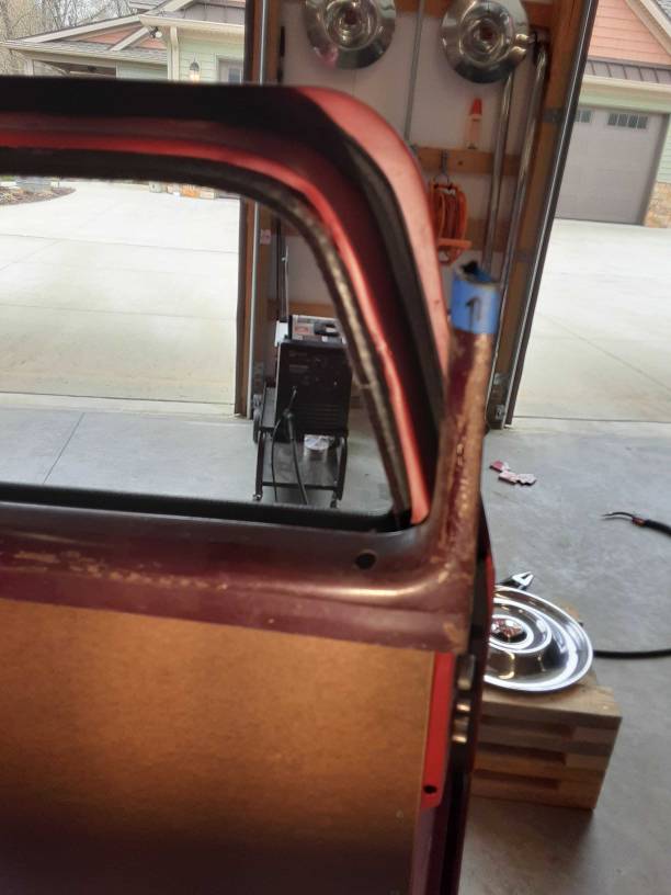

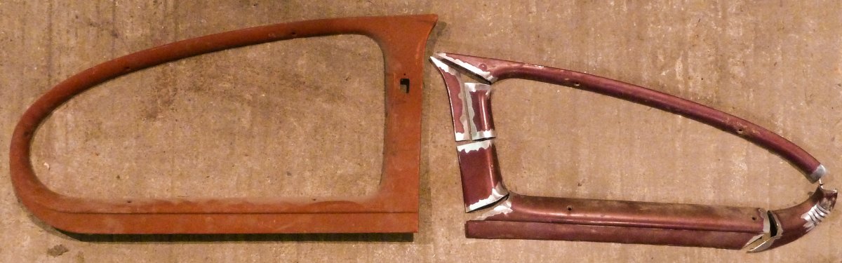

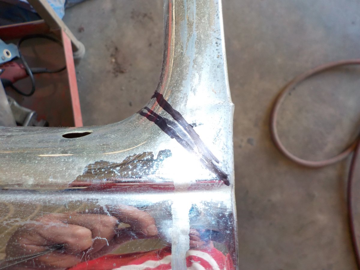

    Here is a pic of where to cut. First cut the moulding in half since you haft to shorten the moulding to fit.That way your only dealing with half the moulding.I would cut it in the middle.If you do this right you can uiltlize the orignal screw holes.Cut the corner above the flat area and pie cut to the left and right of the center of the curve and weld together

    Looks easy enough, that a Monterey window garnish?

    Yes it is.They are chrome plated br***

    Been working on the window garnishes today, embarr***ed to say how long it took me to get this far. Anyway. I have the corners close, but when I put the trim to the window, its hitting the window frame. So my question is how do I make this work? Is this suppose to wrap around the window track?

  25. I'm not exactly following you. Did you install a U channel in the door for the gl***? They didn't do that in the Merc's. It was single wiskers mounted on the edge of the molding to go against the gl***.
  26. Should have waited for you to post photos. What you have there is Wrong. To much stuff.
  27. I'll go get you some photos of Factory stuff.

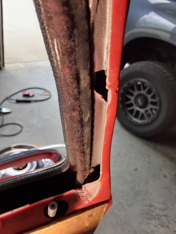

    I got the Merc finished on the outside. Windows were already installed. There's an aftermarket gasket in the window track. See pic. ****

    So it's basically, universal window gasket with felt material glue over the top.
