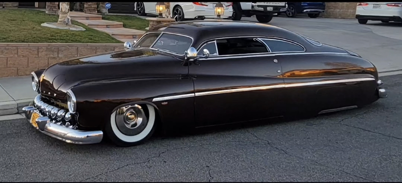

  7. Doctor Detroit
    Joined: Aug 12, 2010
    Posts: 1,056
    Doctor Detroit
    williebill likes this.

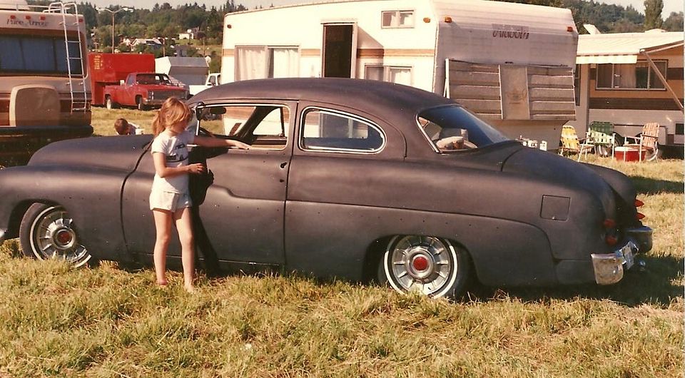

  8. Doctor Detroit
    Posts: 1,056
    Doctor Detroit

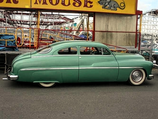

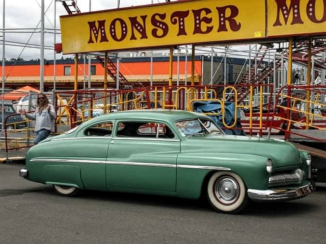

  9. Squablow
    Joined: Apr 26, 2005
    Posts: 18,496
    Squablow
    Just saw these pictures in another thread and am reposting them here, even though I don't know anything about the car other than I like it.
