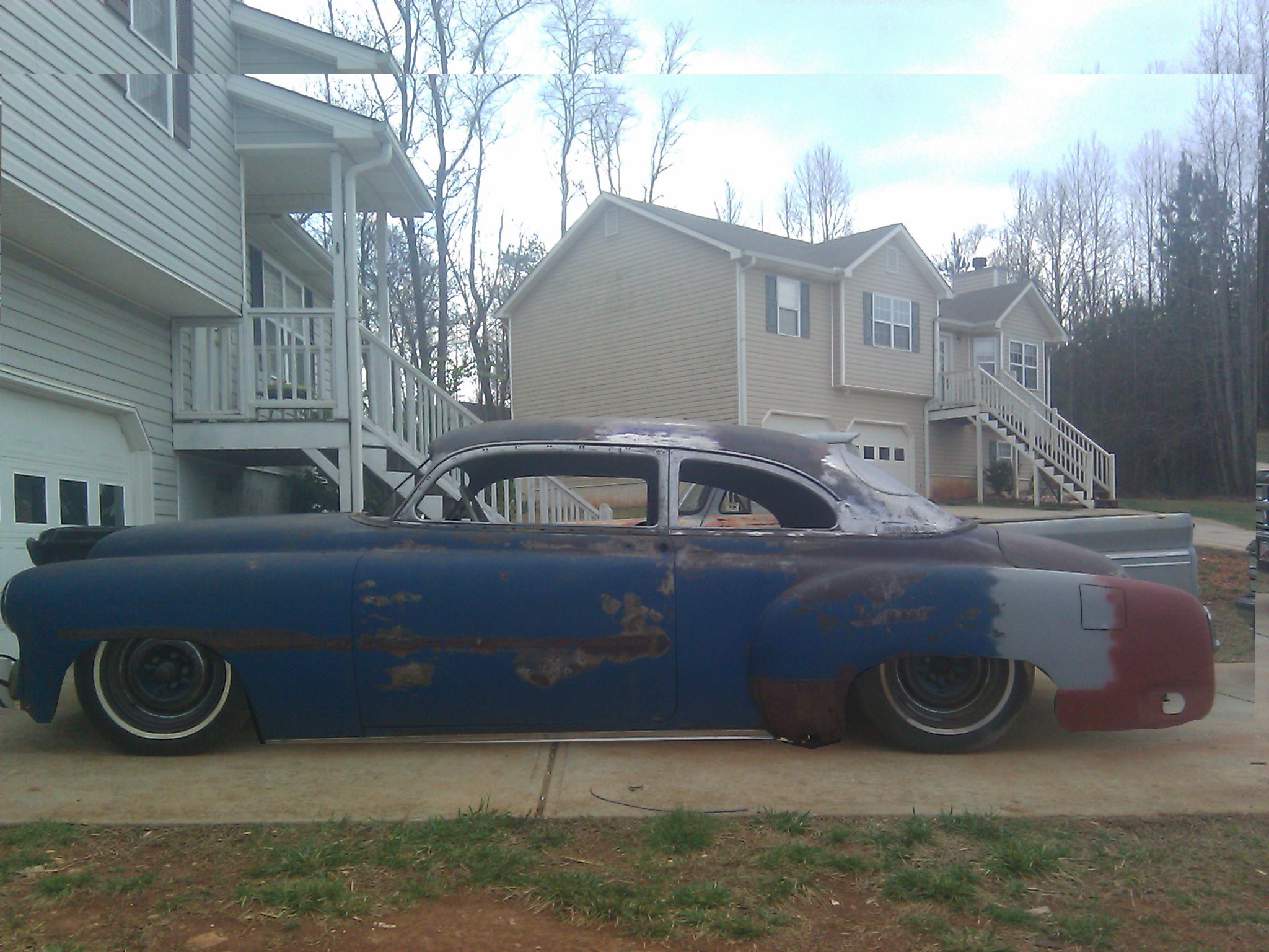

    Here is mine.It was done at Moores HotRods in Dallas Ga.The catwalk was left alone and a filler piece put in between the belt line and the window.The rear window was laid forward only a little.A filler piece was also put above the back window.I love the curve it gives the car.I could not have asked for it to be better.

    Dirty Ed, do you have some more pics of the rear window area or a rear view? Is that the stock rear window? How much of a chop was it front/rear? Looks good

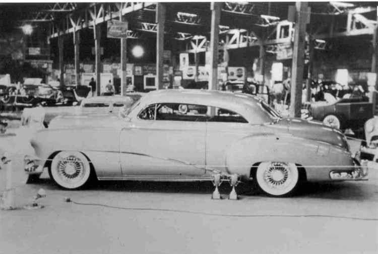

    here it is, the car is over all real nice, but look how Fugly the catwalk,back window area looks...

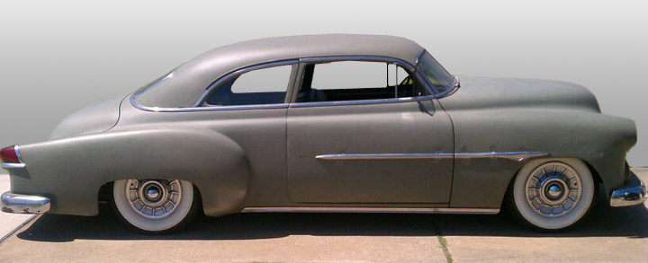

    i think the cat walk was lengthened too much on this car, but maybe that is what the stock back gl***(sunken) yields? The back window in my opinion should be leaned more. Damn, i hate being soo pickey, I feel guilty about picking apart other people's cars! I edited the photo and posted the real photo(left) and my edited version of what I like better

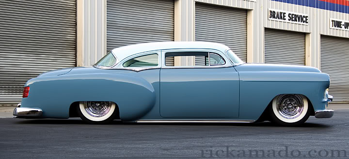

    [​IMG]This is Rob Fortier's 53 chevy. I think it is superb.

    Robs car use t be a 4 door too. i got to see this car close up when my friend was doing the upholstery on it.
  20. Racrdad
    Joined: Jul 27, 2007
    Posts: 1,208
    Racrdad
    ^^^^^ Now That Is A Beautiful Car !!! ^^^^^^

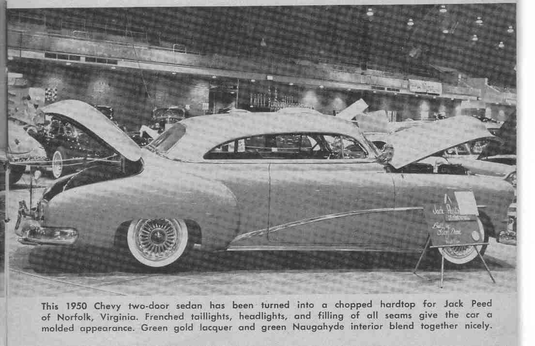

    I kept these pictures on file because I know what you are talking about. I REALLY do not like the rear window to be laid down, I think it looks better with stock shaping and just changing the proportions. Hope the owner doesn't mind me posting these pics, but I like this chop.

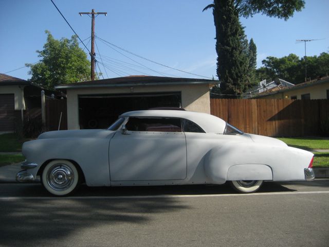

    Not that anyone asked, but I think this one is perfect! These pics are from another thread, and I kept them so that I could do one someday. This was a 2 door sedan.
