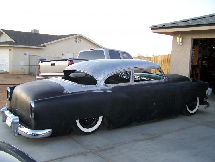

    Thats exactly how I want to do mine! Whos car is this?? Any more pics?

    heres mine..

    Is it just me or does it look like he cut the rear window frame down too?

    T he rear window looks cut to me also. It looks good too!

    It does look good, but the thought of cutting my windshield is enough to make me cringe... Id much rather avoid cutting a rear gl*** too..

    i agree :)
