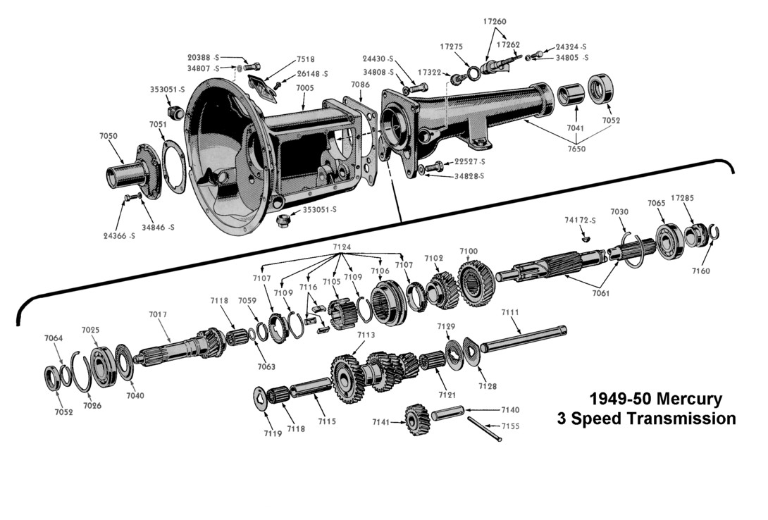

    1950 was a transition year for Merc trannys. One will fit and one will not...depends on which one you have. It's always a good idea to post a picture of your problem.
    The diagrams below were taken from Van Pelt Sales, a great source of flathead info. Here's a link:
    http://www.vanpeltsales.com/FH_web/flathead_drawings_trans.htm

    Yep, it was 1951. This pic shows the transition in bells.
