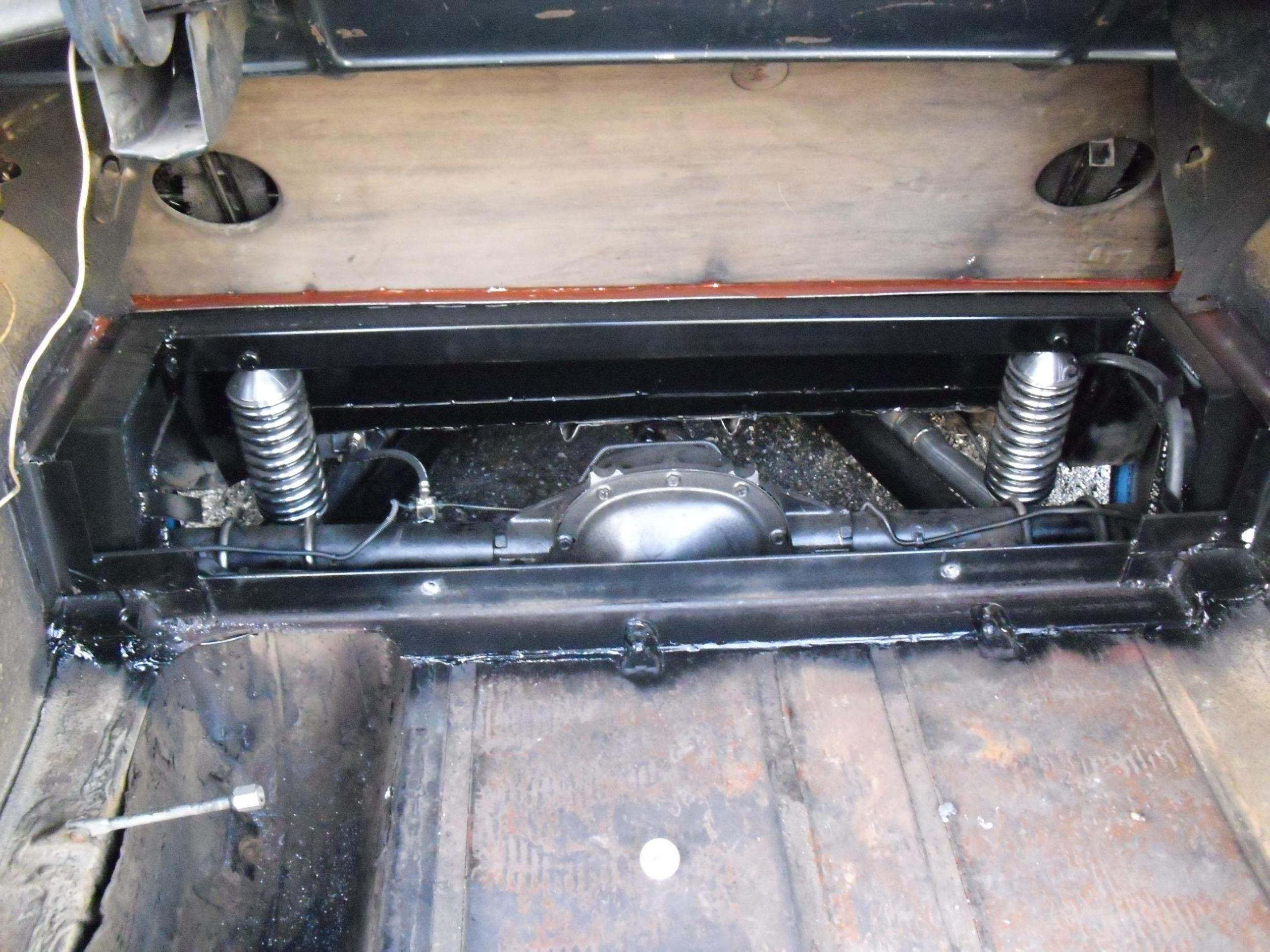

  7. Hot Rod Chris
    Joined: Mar 31, 2011
    Posts: 464
    Hot Rod Chris
    Here is my tunnel. Looks a lot bigger in the pic. Gona notch my seat like Tin can to fit. Running bags on links so have access panels for the bags under the seat and access the shocks too.
  8. jrolla2k3
    Joined: Jan 10, 2008
    Posts: 146
    jrolla2k3
    Wow Chris, that looks slick! Nice work!

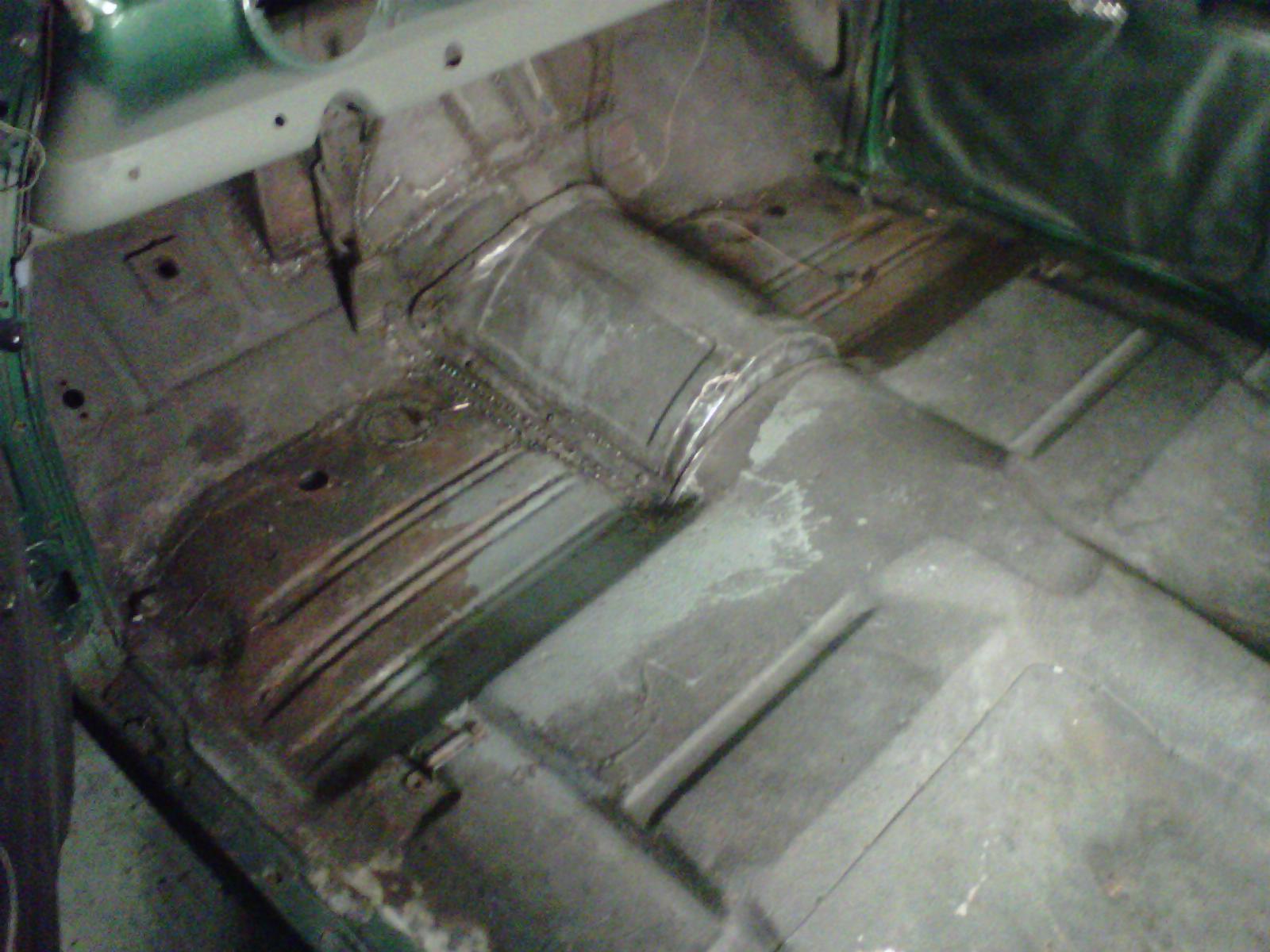

  12. yetiskustoms
    Joined: May 22, 2009
    Posts: 1,932
    yetiskustoms
    here are some pix of my 54 floor. made with 18 ga sheet metal. i made the three floor brace replacements that i cut out with 4 pieces of 18 ga before covering them with the tunnel. i did that for extra support, but is probably overkill. the seats will fit with modifications to the seat frames.[​IMG]

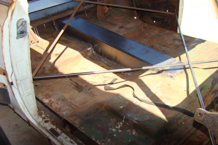

  13. yetiskustoms
    Posts: 1,932
    yetiskustoms
    here are some more 54 floor shots showing the inner supports
