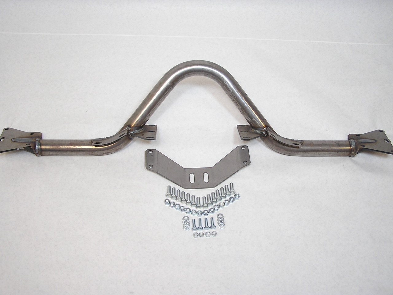

  29. TRAVLR
    Joined: Jul 18, 2022
    Posts: 174
    TRAVLR
    from NC
    Brent,
    I installed the same transmission crossmember in my car. It is a great piece and it fit perfectly, but it is not designed for a Muncie, Borg Warner, or Saginaw type transmission. It will work "as it comes" with an automatic or a Tremec style transmission. There is no room for the shifter (it hits the upper hoop) if it bolts to the side of the transmission.
    I had to modify mine to work with my Muncie/Hurst shifter. When I get home later this afternoon, I'll try to upload some pictures of mine to give you an idea of what you can do to make it work. Just trying to save you a headache later.
