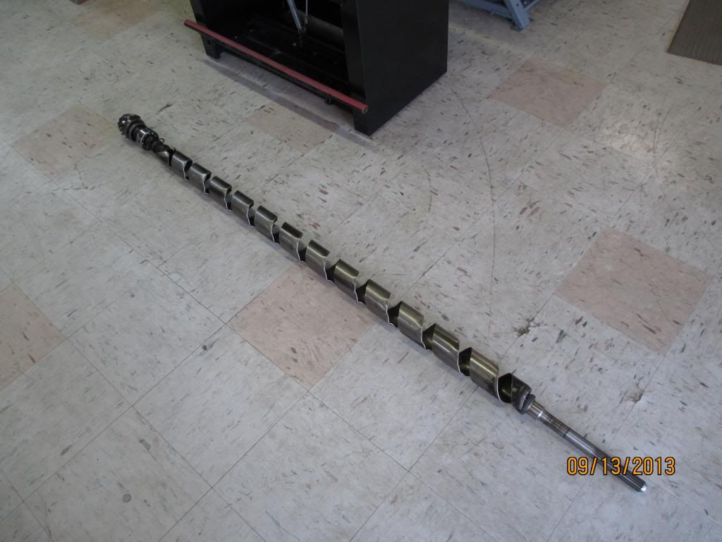

    I'm in the process of remanufacturing the driveline out of my 53' chevy sedan (powerglide) after it burst a few years ago. I was backing up and put it in drive a little too quick:(. It literally turned into a slinky and was an absolute pain to get yanked out of the torque tube. Beings as I have no refernce points to get a length for the driveline shop (front end needs room to slide in and out of the u-joint). I measured my 54's driveline and came up to 70.5" (63" without the pinion gear parts). But beings as it was still in the differential when we measured it, I'm not too confident on our accuracy.
    How close of a tolerance do I need to make a working driveline for this car? How much room dose the front spline need to move? I'm procrastinating pulling the shaft out of the 54' as I'm a little nervous as to how difficult it will be to yank it out of it's races. If someone has this data written down somewhere, it'll make my day!:eek:

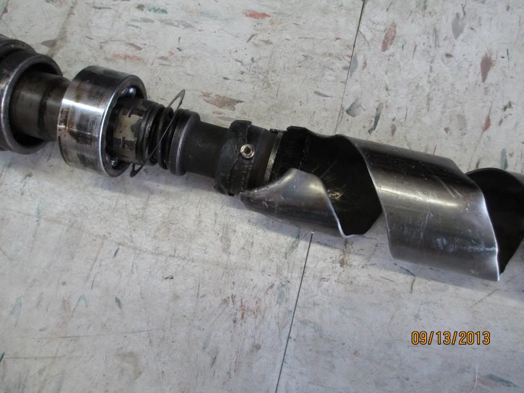

    Sorry for any confusion. How about we start with a picture?
    For the longest time I thought I killed my trany.... till I started pulling things apart and saw this chiller.
    Updating the drivetrain dosn't fit with my plans for the car and I'm trying to avoid robbing any more parts off the 54' than I have to (it's restoration is already going to be enough of a chalenge) Not trying to be difficult, I promise!
    In short I need the overall length of a complete welded driveline for this car. I'm working with a shop out of Austin that thinks they can fix it.
    Now if anyone has any leads on a replacement, I'm all ears. I missed out on one on Ebay a few months back and haven't found anything since.

    I have NEVER seen anything so strange. I thought the actual drive shaft in these cars was a solid ,steel shaft. I still say ChevyTalk.Org is going to be your best bet, and I'm sure that photo will cause quite a stir; two members in particular, Raycow and Gene Schnieder, would more than likely have an answer for you. It's so uniform in appearance, and I'll bet it made for some noise. Butch/56sedandelivery.

    That is pretty amazing!!!! :eek:
    Sorry for you dilemma.........but thanks for posting.......couldn't have imagined such a thing it if I hadn't seen it.

    Holy shit... Ive never heard of one doing that before. You should be able to find the whole setup relatively easy though. Everybody is tossing the torque tubes out for open rears. Put a wanted ad here in the classifieds

    As far as the sound it made.... as soon as I put it in gear it just made a loud 'BOOM' followed by what sounded like someone rattling a bolt in a pipe under the car as it started drifting forward.
    Once I had it parked and started it up, It made the same rattling noise in any gear and when I would put it into park, oh how the gears would grind. Like I said, I thought I killed the tranny but in retrospect, all the simptoms make total sence now. I probably stripped something out with the parking function (I essenitally would be putting it in park while going 10 or 20mph).
    But then again it never could hold the car in position anyway. If I parked on a slight incline, it would creep forward and make a poping noise. I just got used to using the E-brake every time I parked.

    My dad always talked about the torque tube driveshafts doing that. He said it was a bear pulling them out of the tube after they un-coiled. He described them as being made like a "Damascus rifle barrel". I guess now I know what he meant.
