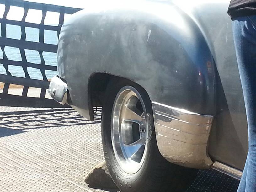

  17. Nailhead Jason
    Joined: Sep 18, 2012
    Posts: 4,533
    Nailhead Jason
    Here it is on my 51. No rubbing and the biggest tire I have seen squeezed into the stock wheel well that doesn't rub.
