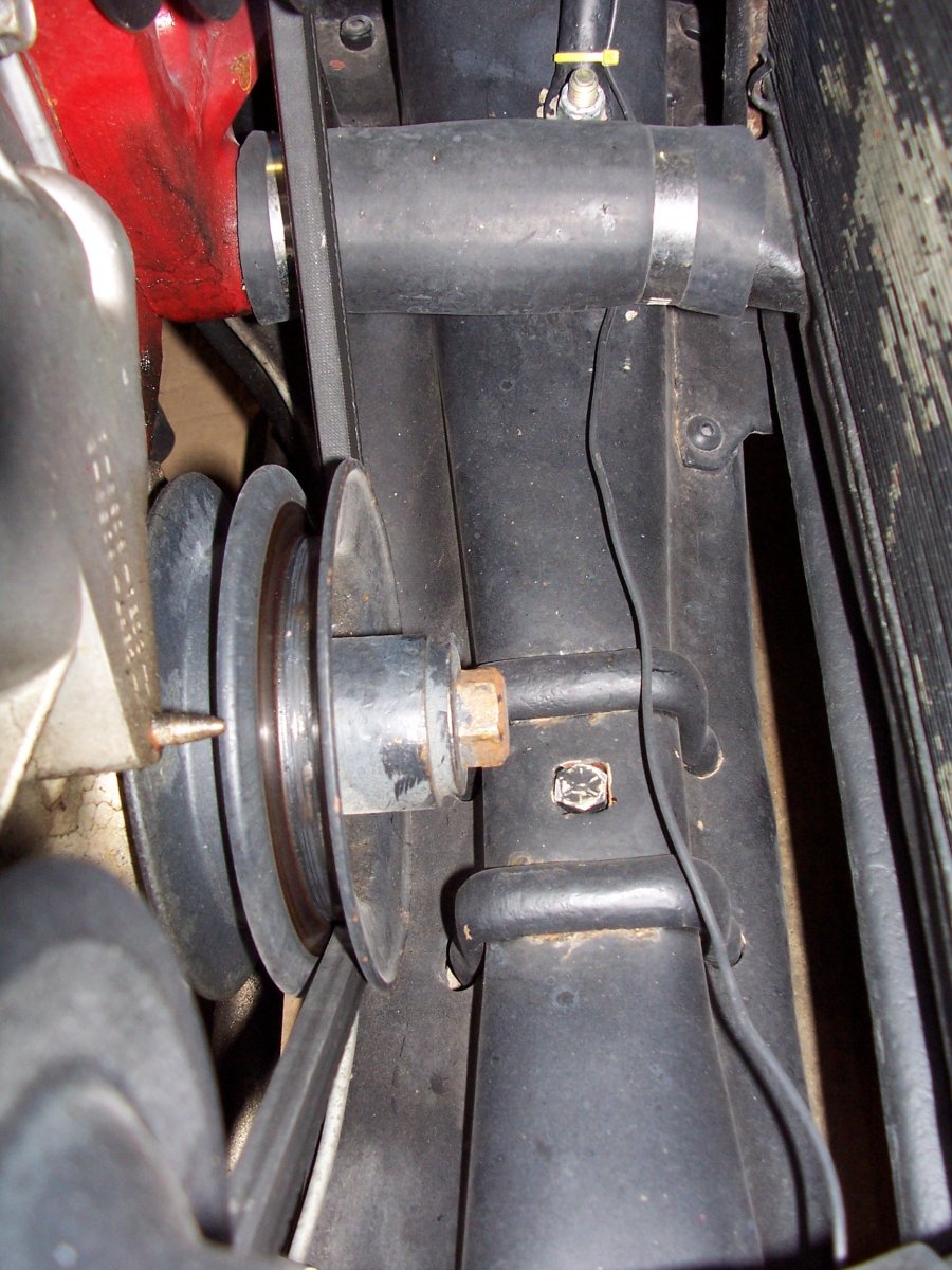

    yes, the bolts need to be offset. i have two 34's with 59 motors in them, and the U spacers i made ended up being different heights! different by about a half inch. why? i dont know, but the motor placement is not forgiving. you must have the front pulley crank bolt centered where the hand crank loop is. any higher, the breather tube is hitting the firewall. any lower, the lower radiator hoses wont clear the front cross member.

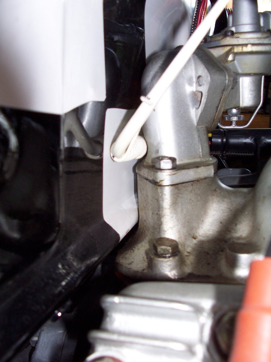

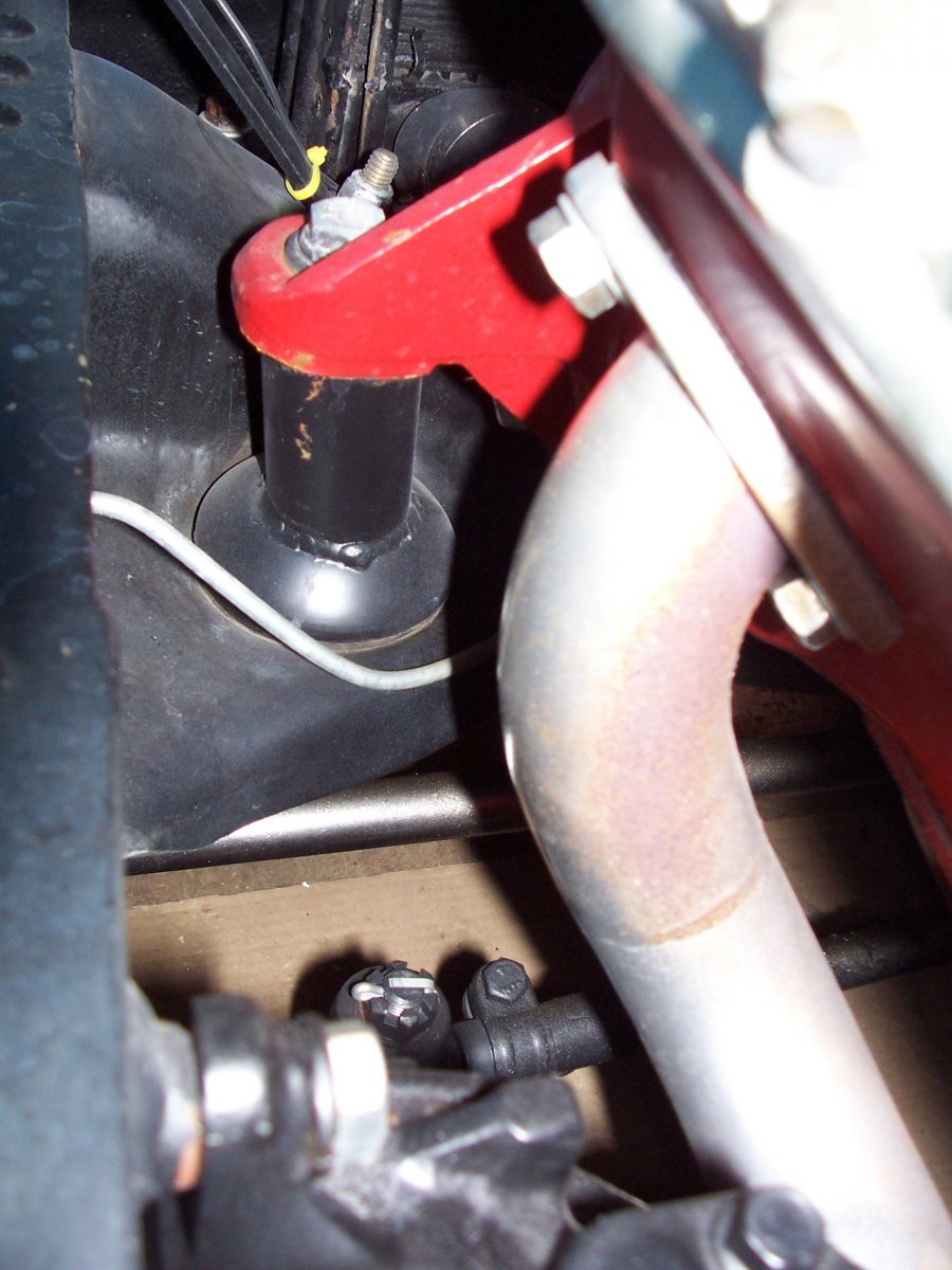

    Don't do it way to much work and very tight. 100_7710.JPG 100_7711.JPG 100_7714.JPG 100_7713.JPG

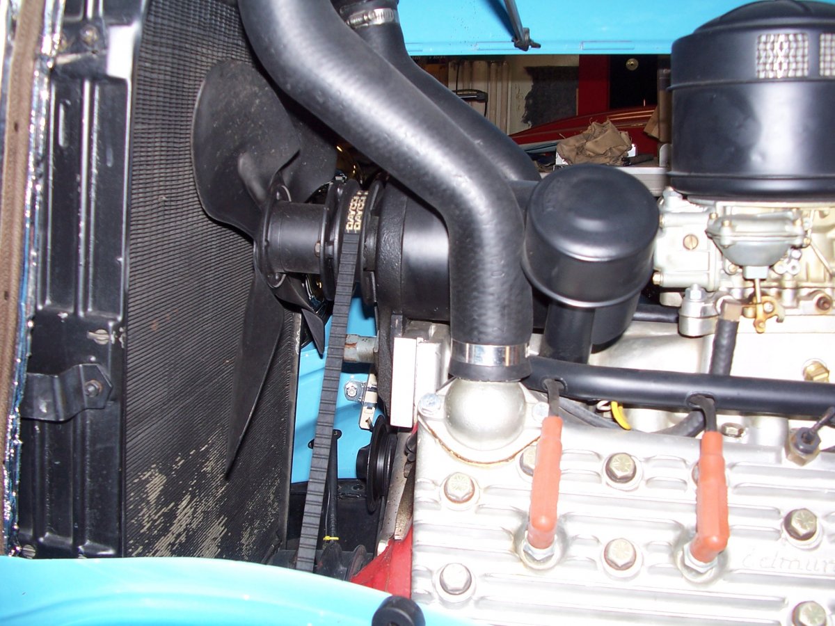

    I have a 34 5 window with and 8ba hooked to a 34 trans. I used a 35 truck firewall and the u brackets on the engine mounts. The one thing thats still a pain in the *** is the upper radiator hoses. Its a tough angle with a stock radiator. I replaced the upper necks with model A lower ones to help with routing the hoses. I'm still noodling it out.
