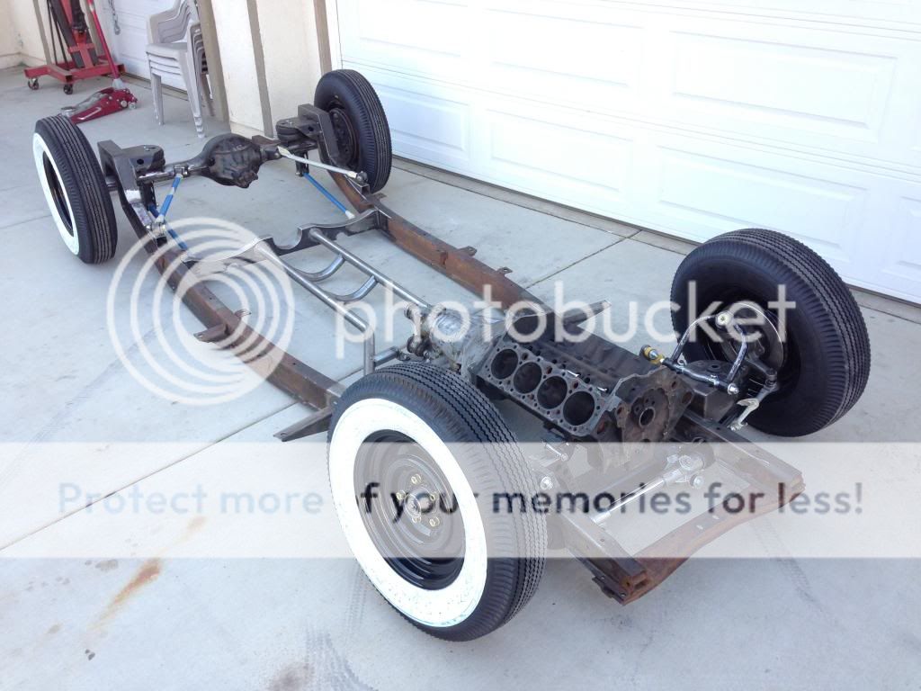

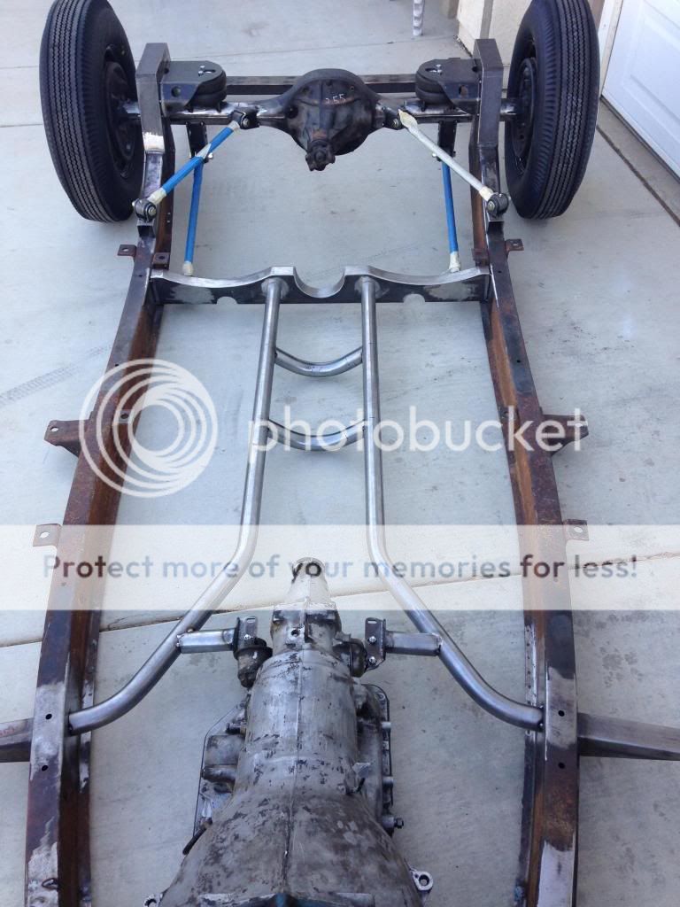

  9. Here you go. Maybe this will help with my question. I need to be sure when completely aired out the frame sits just lower than the rockers. Everything is currently tack welded with the exception of the front suspension. I still have the ability adjust the height of the rear bag mounts on the notches. Before I final weld, it seemed like it would be worth asking. I do have **** for brains, so I need to use extreme caution in these areas...........

    I'd put the canted quads on first, then see how the body sits on the frame, but that's just me.
  11. Canted quads. Check. Next step for sure.
