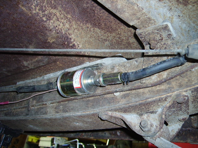

  20. Hooray. Now, about the fuel pump. I'm guessing that you have the pump up forward where it was easy to install. That could be why it won't shut off. Generally, electric pumps need to be as close to the tank as possible so they are pushing. And do install a large filter before the pump to ***ure continued operation. There is bound to be crud in that tank that could cause the valves in the pump to leak, not to mention the mischief crud can cause in the carb.

    I dont have fuel tank at the moment, using a gas jug as a tank for now . I have a new one on its way with all the extras to go with it . As far as the electric pump , it is mounted at the rear just before the frame rail goes over the rearend and it does have a filter installed . So im not worried about dirt now . As far as keeping the old mechanical pump , yes i still have it and i believe its good . I took it apart and cleaned it out before i even attempted to start the engine .You can put your thunb and finger over the inlet and outlet ports and manualy pump it and feel it working . It just would not prime do to the engine wasnt cranking fast enough . I may put it back on after i get the bugs worked out and i know then engine will fire up easily.

  26. If you didn't "hit the throttle" would it keep running out the vent? The inlet valve of the carb. may be seeing too much pressure from the electric pump. Typical pressure reading should be around 3psi. That's what the mechanical pump will deliver. Your electric pump may exceed that to the point of overwhelming the inlet valve. The fix for this to to install a pressure regulator. But you won't need that if you are going to use a mechanical pump so maybe you should concentrate on getting the fuel system set up as it was originally.

    Your right about that , the electric pump is 5 psi . I will more than likely put a new mech fuel pump back on this and see what happens. Oh and yes if i didnt hit the throttle gas would just keep shooting out of the vent tube almost hitting the cowl . Thanks agian everyone .
