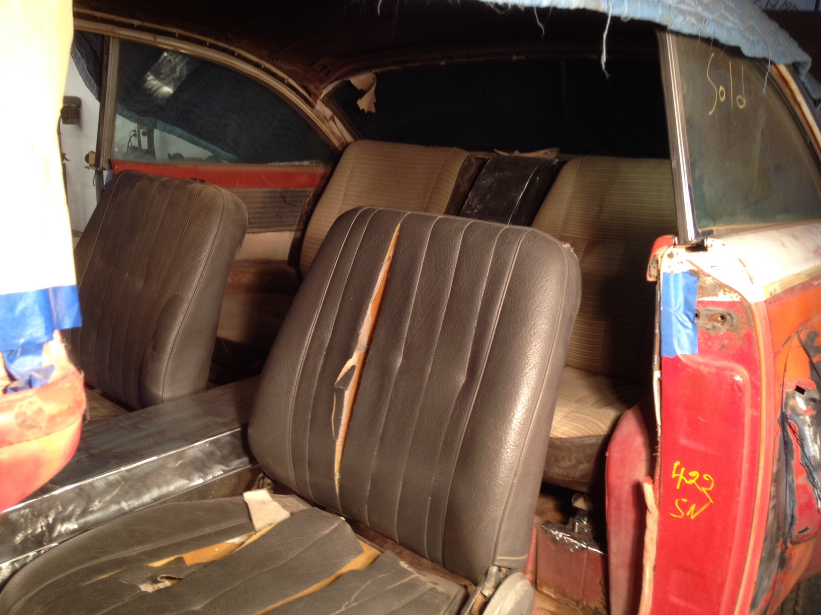

    I was having the same problem, I needed straight backed, flat mounted buckets that I could use for front and rear buckets. I used late 70's early 80's toyota fj40/60 seats ! They worked great for my app. image.jpg W
  4. Is that in your Henry J ? Also, if so, (or not) do you have any more photos of the seats in the finished car ? Looks pretty good really, and with some upholstery tricks.....I'm sure it has even more potentials. I've seen the Tbird rear wrap around used before....seems like your choice fits within the vein..."so to speak".

    No it's my 55 Merc that I'm building, I used Peugeot seat in my Hemi j , also flat mounted cool seats!
  6. Me like 'em....either way. Post them up if ya' got 'em. Cool and thanks.
