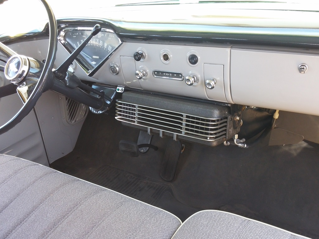

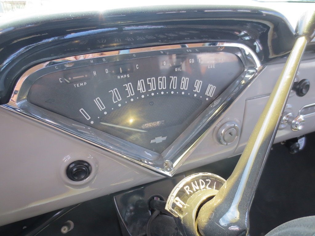

    53-54 Chevy cars used a decent turn signal switch, and had Powerglide available. You can make this stuff work, with some patience. I did a similar thing to my 57 Suburban. The 54-59 Chevy trucks used the same turn switch as the 53-54 cars, although the angle of the lever changed in 57, when they went to this deep dish steering wheel (before that the wheel was flat).

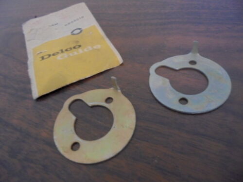

    There's a piece screwed on the back of the steering wheel itself that makes the switch cancel. You'll need one of those as well. I haven't looked at mine in a while, but you could probably fabricate one. It's just an "L" shaped piece that sticks out to actuate the cam on the switch.
  13. squirrel
    Joined: Sep 23, 2004
    Posts: 59,971
    squirrel
    this. You only need one.
    olscrounger likes this.
  14. Thanks, I will try to fabricate one when I will have the steering arrived :)
