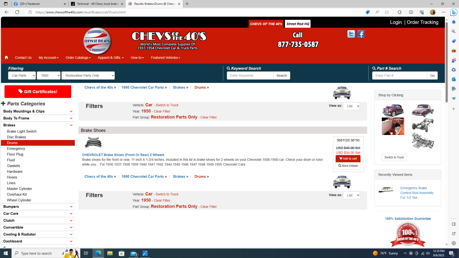

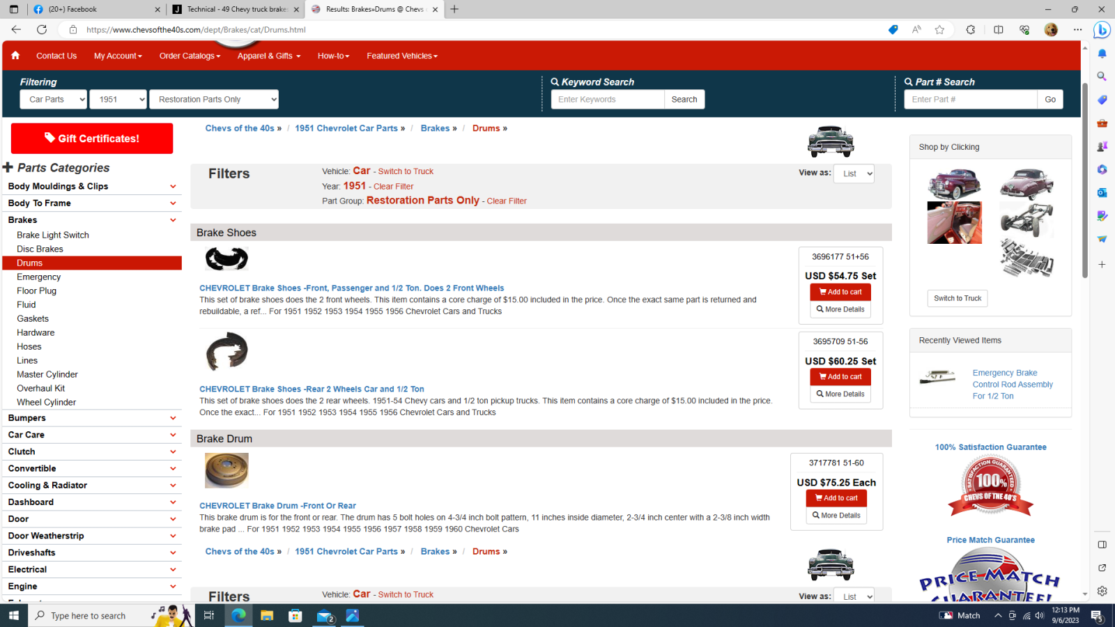

    I've always used 53/54 but was able to find them. Using the Rock Auto cheat sheet I found out that 50 cars still use the Huck brakes This being 50 Fleetline. I checked Chevs of the 40's and confirmed that. 50 Chebby no workie.
    51/54 Cars use the same wheel cylinders and brake shoes.
    My and now your Chevy brake education for the days is that the break between Huck and Bendix is 1950= Huck, 1951 = Bendix for both cars and trucks. I knew it was that way on trucks but wasn't sure about 49 and 50 cars .

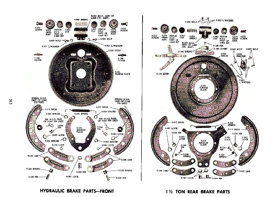

    Sorry I didn't realize I left it out, but the wheel cylinder is there along with the upper retaining spring. The parts I really need that don't seem to be available aftermarket are what I have circled. That's what I was hoping would interchange. Brakes.gif

  8. squirrel
    Joined: Sep 23, 2004
    Posts: 59,197
    squirrel
    GJ, GK, and GP are what you'd be looking at, if the GJ and GK are the same as GP, then you can use the car part on a 1/2 ton truck. The parts book calls the GJ and GK "PASS", and the GP is "1/2 Ton"
    5.036 Link (4 different parts) looks the same for 1936-1950 cars and trucks.
    5.075 Anchor Plate is the same on 36-48 Cars, and 36-50 Trucks. So you'd need to find an earlier car or truck to get that from, the 50 car won't work.
    I think the pins will interchange.
