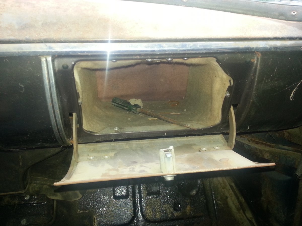

    20140814_175837.jpg Glovebox.

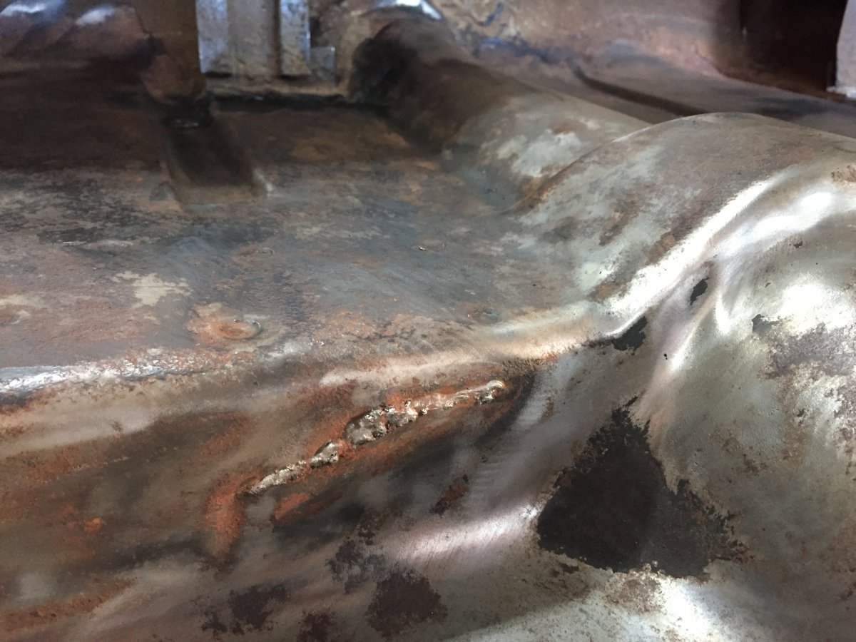

    Found some more rot in the center floor brace, and was never happy with the repair on the front floor brace. Couldn't really tell till I got into it cause the undercoating looked pretty good. But floor braces rotted where the dust was caked inside them and held moisture. So tore it all out and gonna try to do this right. Got some braces and floor pans from the Filling Station.
    Tore out again.

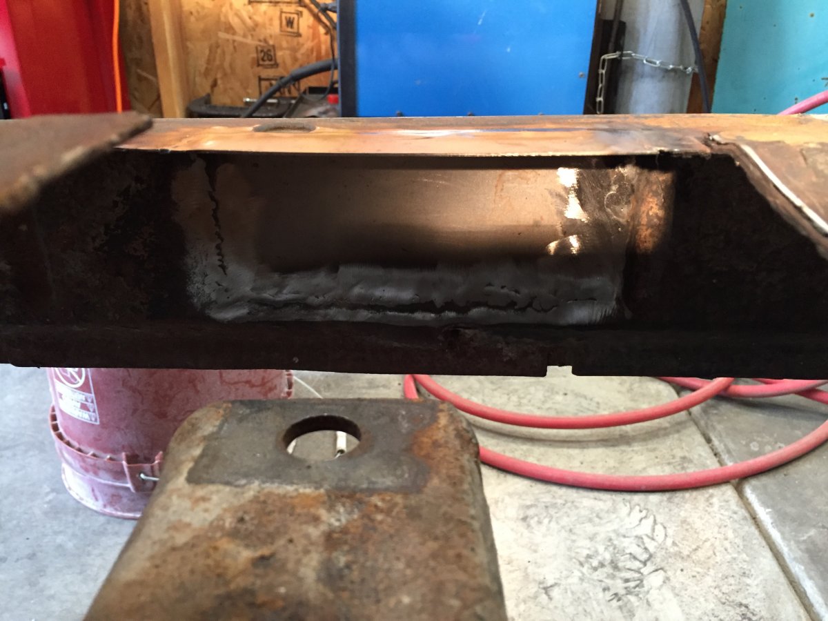

    Fixed a section of the rocker welding upsidedown and backwards.

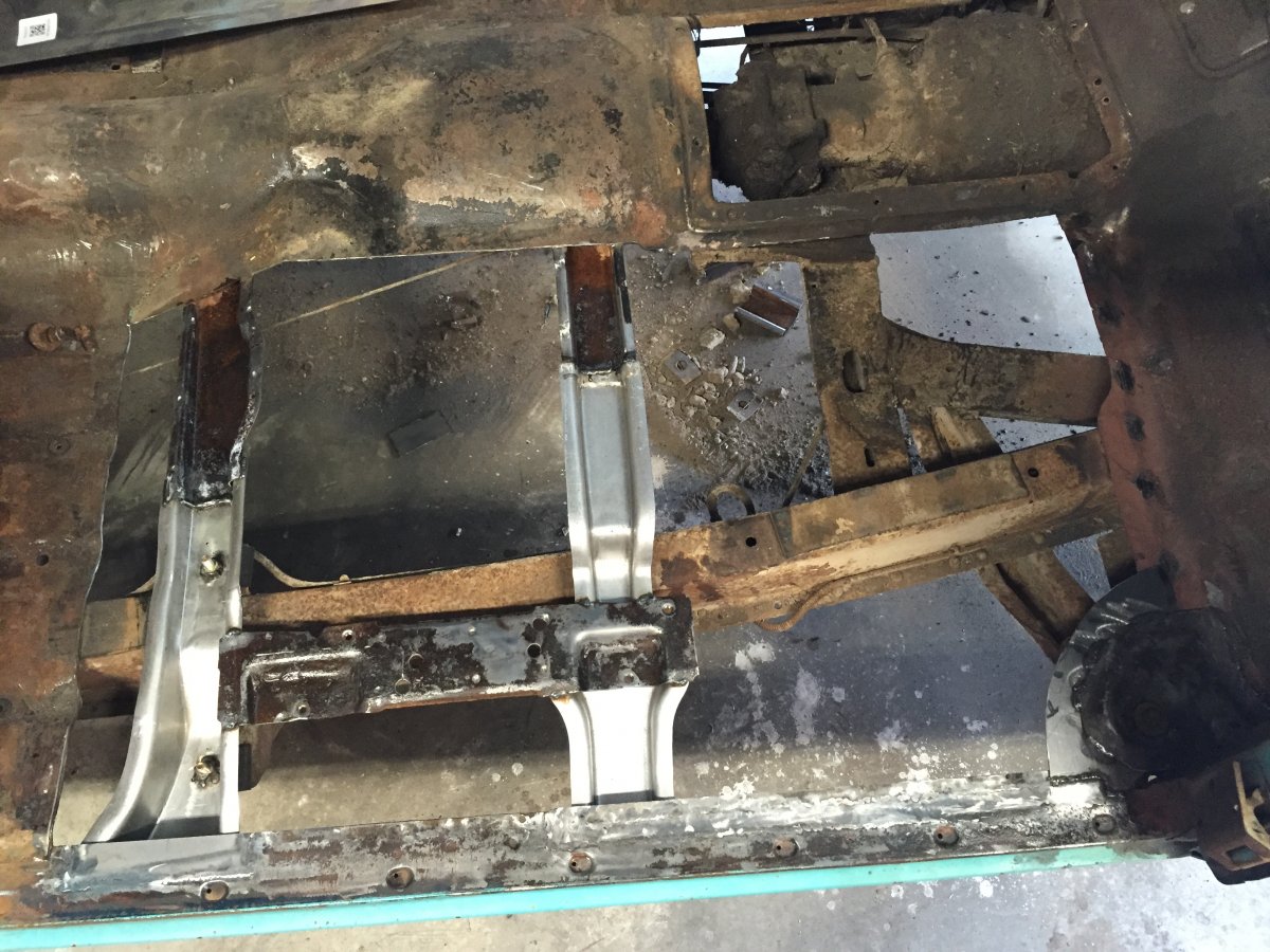

    New braces in, more welding upsidedown and backwards.
    Well that's where I'm at now. Any tips and comments are appreciated. I'm learning as I go.

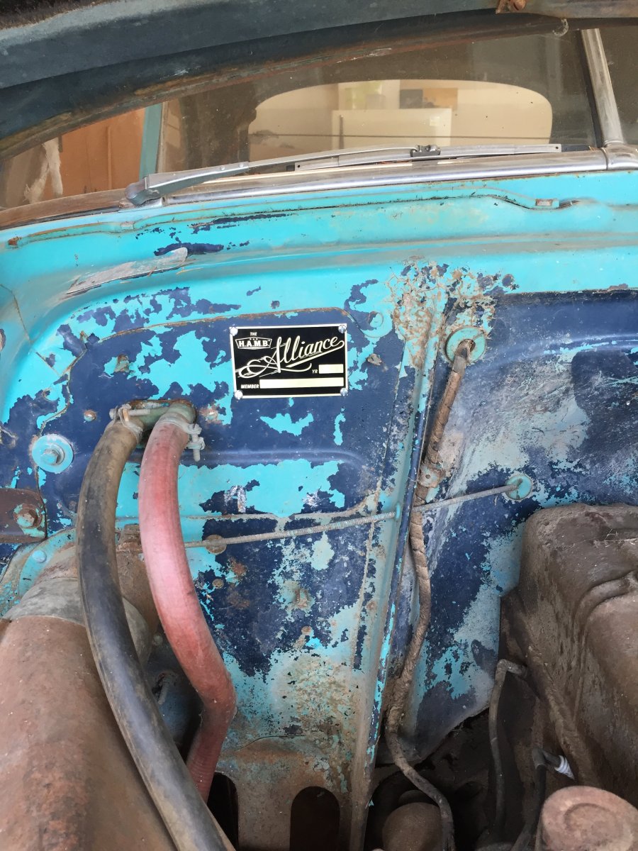

    Didnt get much done this weekend. Got p***enger floor tacked in. And put Alliance tag on.

    Some progress.
    Got p***enger inner rockers repaired and new floor braces in.
    Hopefully finish the floor next week.

    You weld better upside down and backwards than I do right side up and forwards!

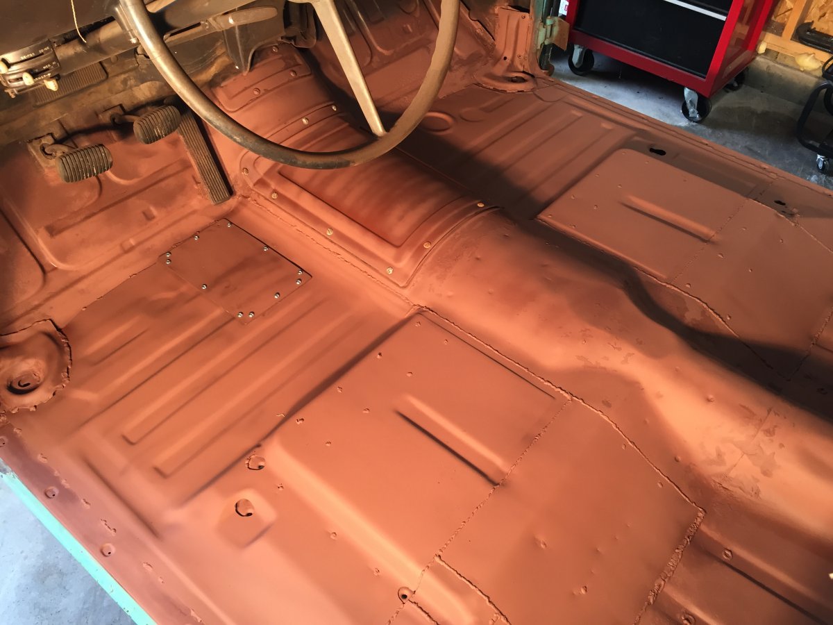

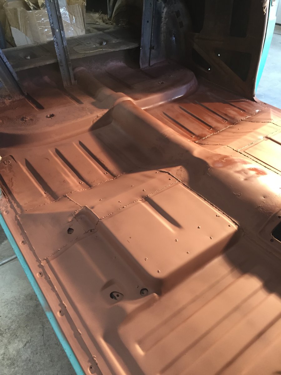

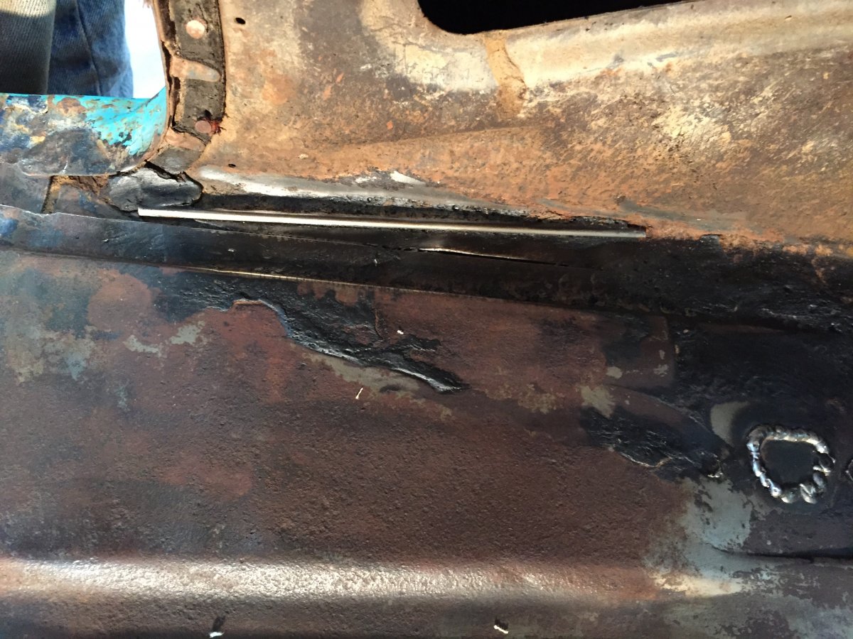

    Was able to check the floor off the list this weekend. Filled on unneeded holes in the floor. When I was wire wheeling found a weird piece of rod under some of the nasty black tar. and found an old repair that had to be from the factory.
    Got everything wire wheeled down pretty well, left some of the nasty tar stuff and painted over it.
    Cut out a bigger hole for master cylinder access, made a cover.
    Not perfect, but good learning experience. Flustering when I want perfection but my skills are far from it. Everything is **** welded except at toeboard and at the rocker, same as factory.

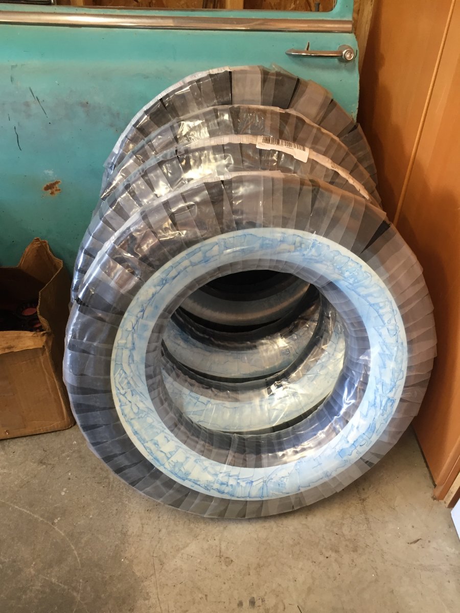

    Still chipping away at small things. Got front backing plates from a 54 so I can upgrade the brakes. Probably clean those up this weekend. These showed up from Coker last night. Got a pretty good break being an alliance member. tire.JPG
