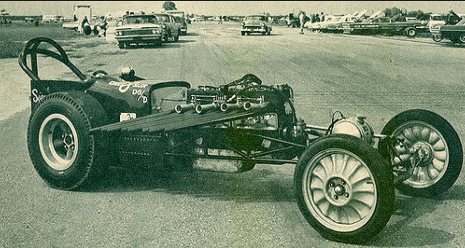

    Yes. I think that went right over Perry's head. It's not always easy to communicate. PS here is a picture of my friend Dave Dozier's Winter Nationals class winning Chrysler eight. Dave would later go 250 mph with a blown Chrysler eight at Bonneville. So they will run for someone who knows what they are doing. Sadly Dave is no longer with us to guide the masses. Dave Dozier 8 cyliner.JPG
