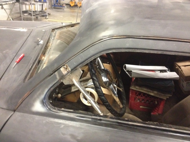

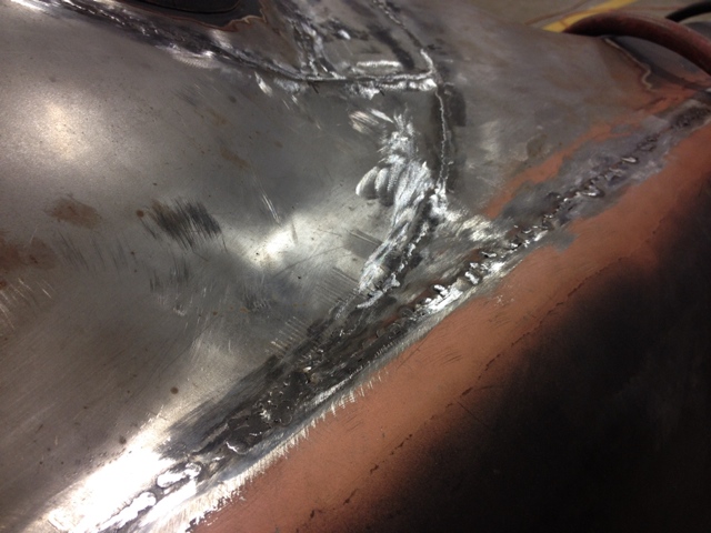

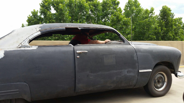

    Ok so I have pretty much finished all the welds on the roof and deck. Lots of tack welds and a lot more grinding. Tacked in the b pillar too for placement. ImageUploadedByH.A.M.B.1406925208.502069.jpg ImageUploadedByH.A.M.B.1406925266.818741.jpg ImageUploadedByH.A.M.B.1406925286.286294.jpg ImageUploadedByH.A.M.B.1406925361.313610.jpg ImageUploadedByH.A.M.B.1406925401.923361.jpg

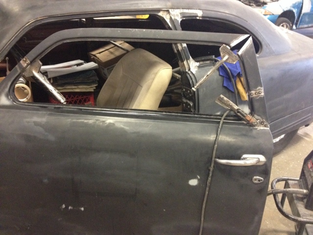

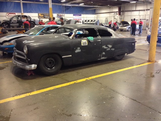

    So for the past two days I have been finishing up the b pillars. I made a template for the door tops and got the drivers side tacked in. ImageUploadedByH.A.M.B.1410346754.382749.jpg ImageUploadedByH.A.M.B.1410346766.313133.jpg ImageUploadedByH.A.M.B.1410346777.433042.jpg ImageUploadedByH.A.M.B.1410346824.547143.jpg ImageUploadedByH.A.M.B.1410346837.433487.jpg ImageUploadedByH.A.M.B.1410346856.176192.jpg
