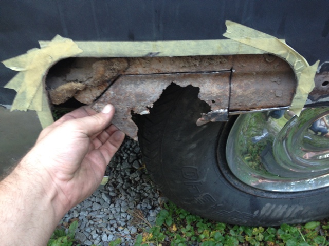

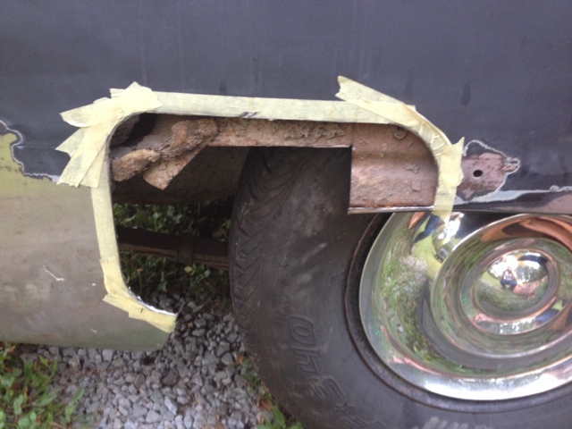

    Just some patch work. ImageUploadedByH.A.M.B.1410994354.811350.jpg ImageUploadedByH.A.M.B.1410994367.779469.jpg ImageUploadedByH.A.M.B.1410994381.960824.jpg ImageUploadedByH.A.M.B.1410994398.928722.jpg ImageUploadedByH.A.M.B.1410994416.712084.jpg ImageUploadedByH.A.M.B.1410994443.555352.jpg

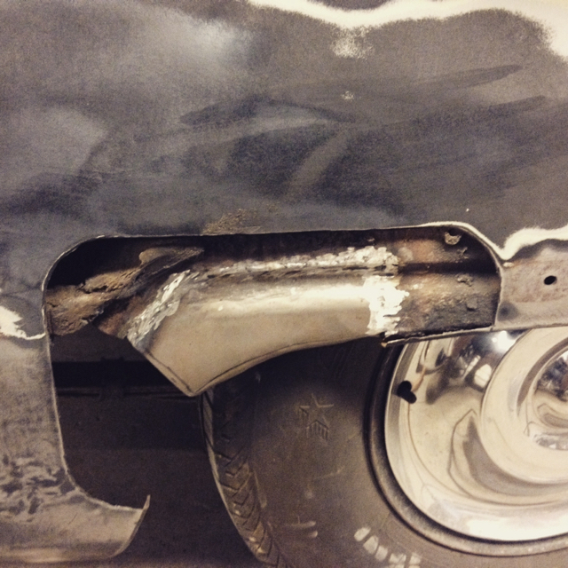

    It's been a while since I posted. I haven't been able to work on the car til recently. Moved to California and started work at a custom shop. Here are the recent progress reports. ImageUploadedByH.A.M.B.1429636664.377136.jpg ImageUploadedByH.A.M.B.1429636682.324768.jpg ImageUploadedByH.A.M.B.1429636702.025881.jpg ImageUploadedByH.A.M.B.1429636761.106047.jpg

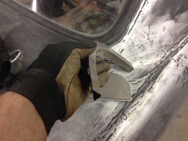

    Worked another few hours on her. Welded up some trim holes and tacked in the patch panel. I still have to fab up the wheel lip but progress is being made. I am still kicking around the idea of purchasing the Frenched taillight buckets from Chris at shoebox central. I know that I can build them but I'm thinking the time saved is worth the 65 bucks. What do you guys think? ImageUploadedByH.A.M.B.1430369642.016872.jpg ImageUploadedByH.A.M.B.1430369661.788049.jpg

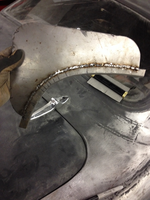

    Today I got the wheel lip made and almost fully welded in. Marked off the remaining area for t******* then the repair will be complete. I got reacquainted with the shrinker/stretcher. I love metal work. ImageUploadedByH.A.M.B.1431143905.432310.jpg ImageUploadedByH.A.M.B.1431144029.414580.jpg ImageUploadedByH.A.M.B.1431144134.499487.jpg ImageUploadedByH.A.M.B.1431144184.109109.jpg ImageUploadedByH.A.M.B.1431144200.094197.jpg ImageUploadedByH.A.M.B.1431144215.872751.jpg ImageUploadedByH.A.M.B.1431144257.777551.jpg ImageUploadedByH.A.M.B.1431144275.637642.jpg

    The gap is big. I put it up there to check the radius of the wheel lip. I haven't trimmed the opening yet for a clean seam. Good eye on that. Attention to detail. I don't prefer magnets but it's what I can afford at the moment. I would like to upgrade to panel clamps but even with those I would have to compete with the inner structure of the wheel tub. Thanks for all the support and following. It helps me to maintain progress.

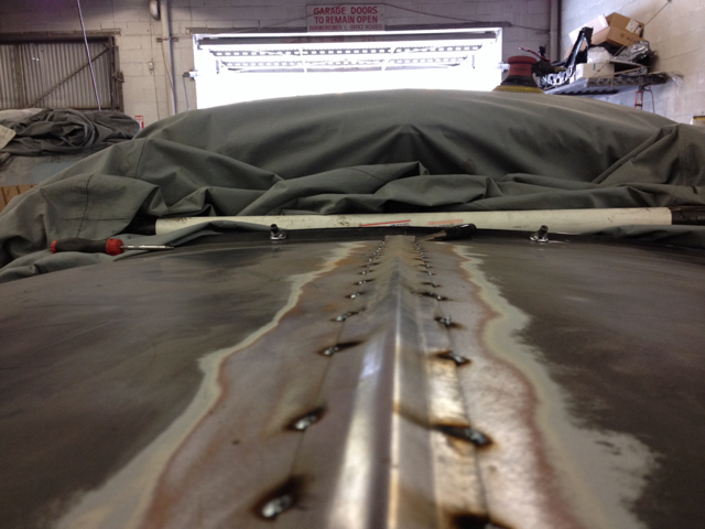

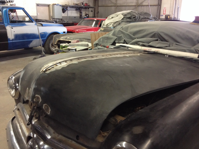

    I made some progress today. Stripped most of them he back half of the car in preparation for peaking the quarters and the tail light French. I'm considering shaving the gas filler hole as well. The stock filler neck does not like the high flow pumps and I have lost a lot of gas just pumping. I also started to peak the hood. I traded some trim for a strip of bead rolled 18 gauge the length of my hood. I had to use the shrinker/stretcher to get it to conform to the curve of the hood. Starting to look pretty good. I'll finish welding it in then throw some fiber gl*** filler on it to smooth it all out. ImageUploadedByH.A.M.B.1432592550.590573.jpg ImageUploadedByH.A.M.B.1432592576.250132.jpg ImageUploadedByH.A.M.B.1432592598.031777.jpg

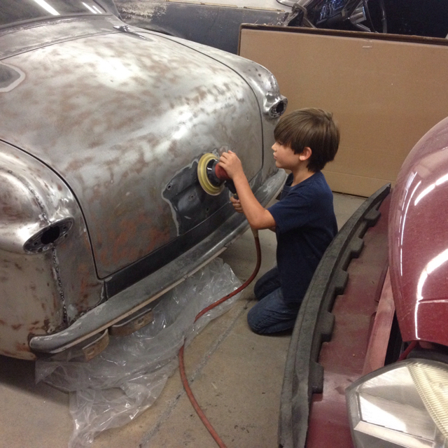

    So a little detour from the regular updates. One thing I love about being a hot rodder is p***ing down what I've learned from those who came before me. I don't have all the experience in the world or even a fraction of it but what I do know I freely give to those who will listen. I have had the incredible opportunity to begin to teach my son...and he likes it. Here are some pics of our cl***es together. Here's to the next generation. (I have already been scolded via Facebook that he needs safety gl***es and a mask so please don't beat a dead horse...got so excited that I forgot to make him wear em). Thanks for looking. ImageUploadedByH.A.M.B.1434427100.401213.jpg ImageUploadedByH.A.M.B.1434427118.860203.jpg ImageUploadedByH.A.M.B.1434427159.338166.jpg ImageUploadedByH.A.M.B.1434427197.200299.jpg
