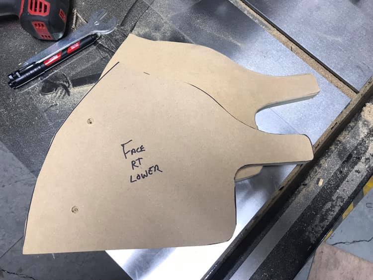

    So on to a lower fender... Decided to hand make a patch instead of buying a new lower... especially after I got it pretty damn straight... I made a template and traced it onto 3/4" MDF, screwed two pieces together and cut them out on the band saw...

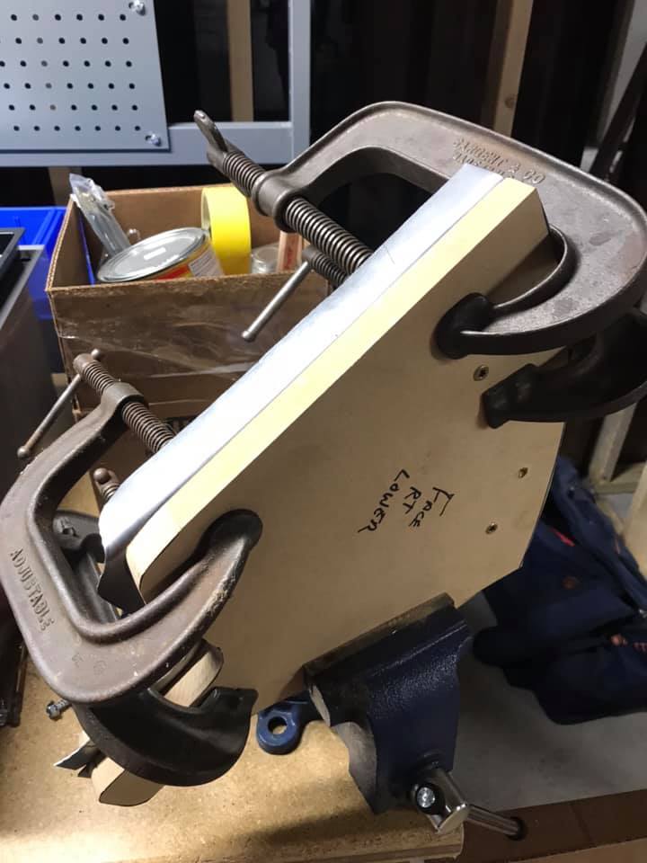

    Sandwiched it in between the MDF pieces, screwed and clamped it, and stuck it in the vise...

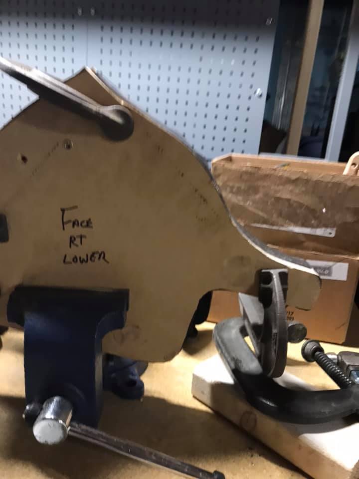

    Then with a wood block, one BFH, one body hammer, and one ball peen, I went to work on it... Slowly bending it over and following any radius... See next post for more... It just limited me to this... First bend.jpg
    catdad49 likes this.
  5. Continued from the last post, The curved parts were "fun". Working slowly with all the hammers at my disposal, I got it all curved over... Only one issue, the very top, outside curve, didn't like to be bent. The metal had no place to go. I learned that I should have pie cut that, but I don't think I need that part for my patch anyway...
    And here's the final piece... I will trim it to fit obviously. I left the original edges on the piece until I get this trimmed so everything is where it's supposed to be. Once this is in, I will address the top where it goes to the grill/headlights...
